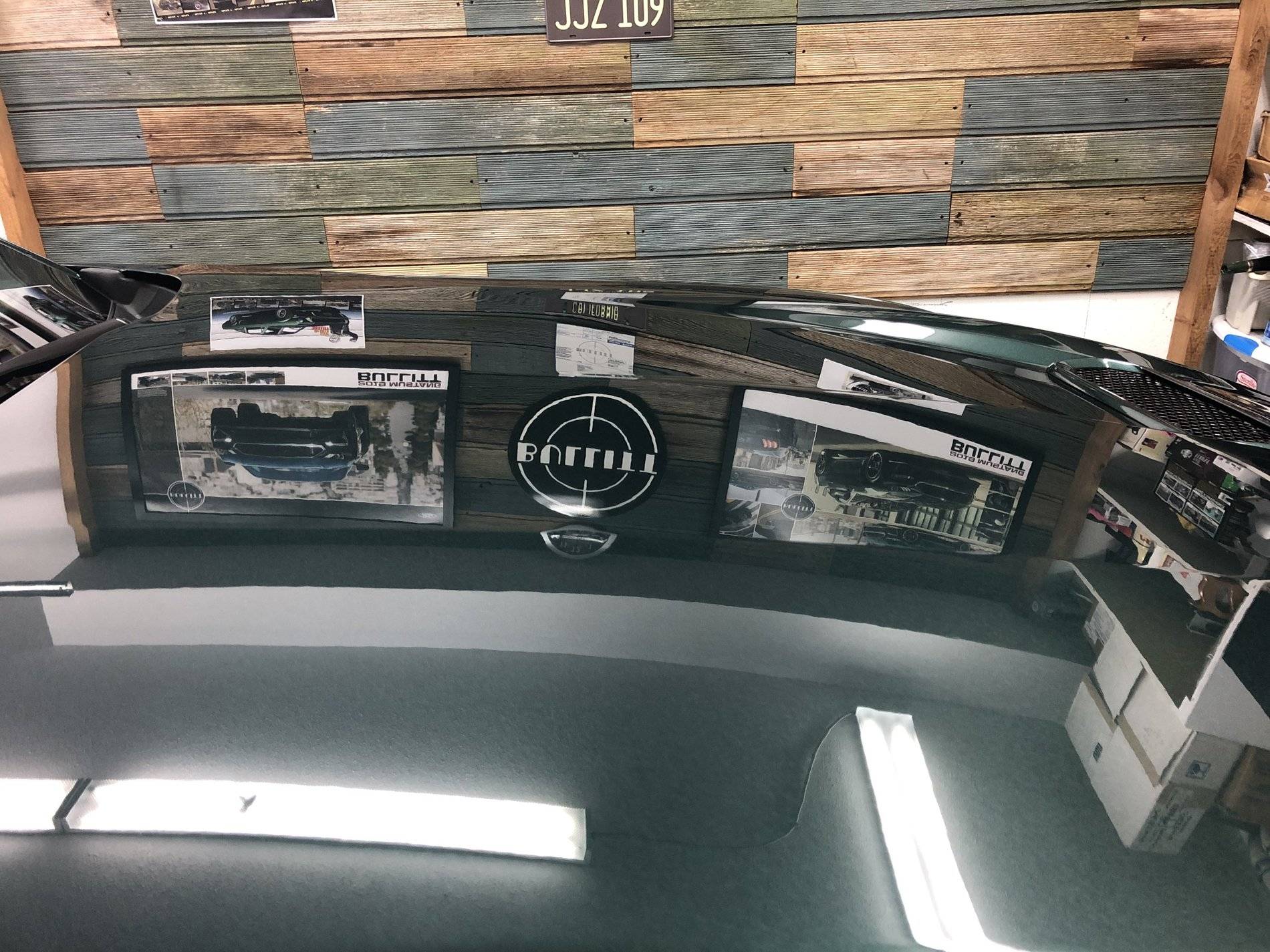

So, CQuartz UK 3.0 then a coat of Reload... what’s not to like????

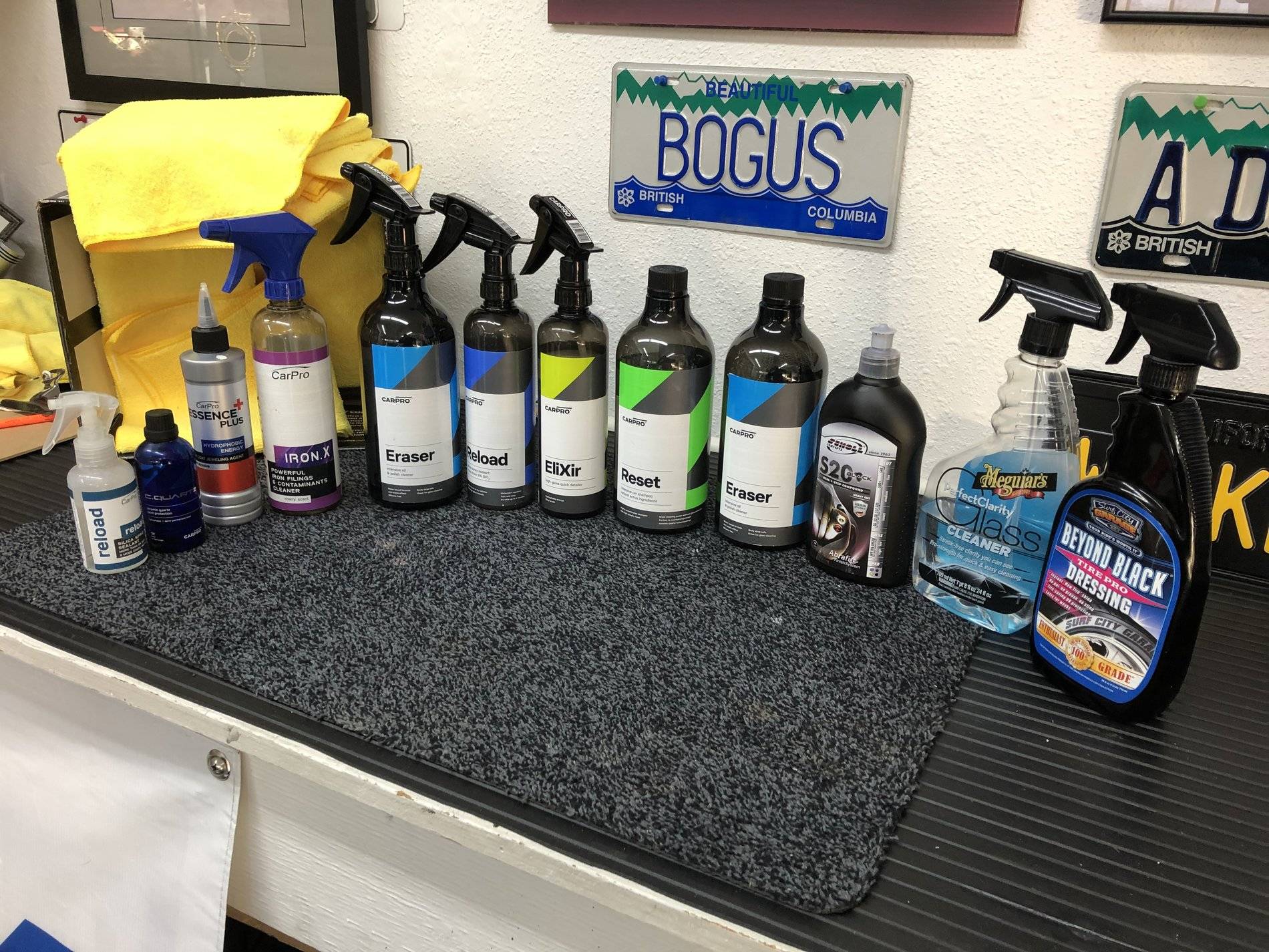

I took possession of my car as it left Flat Rock Mi... nothing done!! Plastic and all stickers still on!! 3500+ miles by rail...can you imagine how many times the trains apply their brakes.... and that is metal on metal!! Car was covered I. Minuscule metallic brake dust.. so I use all Car Pro Products...CQuartzUK 3.0..
1 wash car with reset and a new MC mitt!
2.Clay bar with a spray detail er or soap and water.
3. Iron-X to remove metal particles.
3. Eraser to remove all residuals.
4. I use a Griots D 6” polisher and only... Schol‘S S20 Black polishing compound. Use a foam spider pad and
Start with some pressure....then same pad, same product...let the polisher do the work... I use it only on a 3
setting... polish with MF cloths using both sides
5. Eraser entire car once again!
6 Apply CQuartz UK to the provided suede clothes doing 3’ sq sections at a time...straight lines up and down t
then back and forth...allow section to haze (about 2-3 min....it will look like a rainbow..or gas on water? Buff
with clean MFcloth turning over to a clean side to finish the buff ....THEN THROW THAT MF Cloth in the
GARBAGE...!!! It is now covered in glass particles and will dry and scratch your finish!! Guaranteed (don’t
ask me how I know this..!! lol)
6. Proceed in sections the entire car.
7. I did do a second coat of CQuartz UK!!...sorry forgot to mention this step!
8. ALLOW 24 hrs to cure then apply a coat of Reload.... for the POW.....
I’ve done several cars now and in my garage, with beers and tunes... app 20hr in total start to finish...at leisure of course!! If the car is garage kept....this will last 4-5yrs!!!
IMPORTANT.......Google all processes for install videos and do not be afraid to do this...this is why the body shops charge so much....it does take time!!....just like me typing this post!!! lmao!!
good luck to all who try and post up your pics!!!

Imagine having to do paint correction on a 5 year car or 5+ year car with defects takes even longer! As was the case with mine. Required two step process.

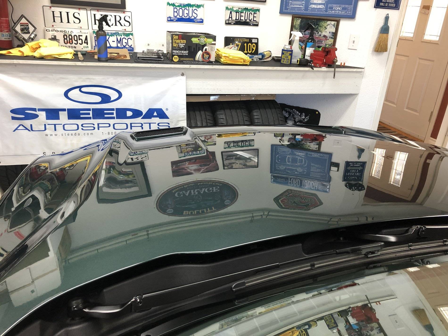

Looks great ric!
Amazing what paint correction can do it's definitely key before applying coating!
