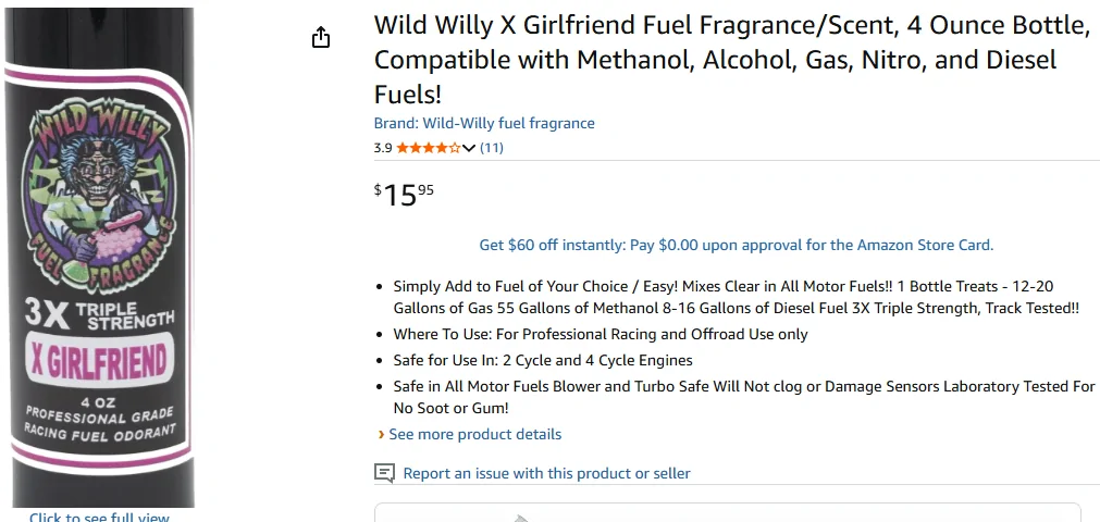

Have you leak checked All clamps? I can see having some type of fumes with pump gas but I wouldn't think it would fume the cabin.
You could try this?
Do you think breathing in the fumes are healthy? Did you not understand this was going to happen?
Have you checked for leaks? fumes out the rear shouldnt fume up your cabin.
try this
