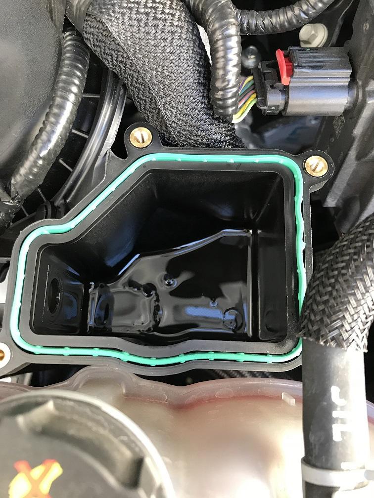

At first glance I don't think the mounting bracket will work on the 18.
First pic is the one that was on my GT350 which is the same for all 15-17 5.0s. The second pic is the 18. It does not look like the valve cover is the same with the same mounting points.
