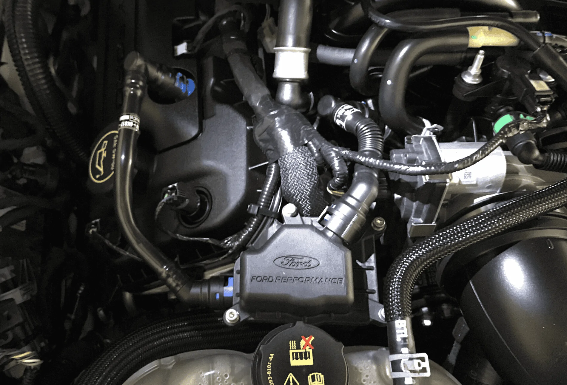

I have the FP and I wouldn't consider anything else. It's OEM quality, it fits like OEM and it's easy to empty. The lid's held on with four Allen head screws that a regular L-shaped Allen key (with a ball end) takes out quickly and easily. The lid swings up by swiveling the upper hose and you empty it with a turkey baster.
The whole thing takes about five minutes and makes zero mess.

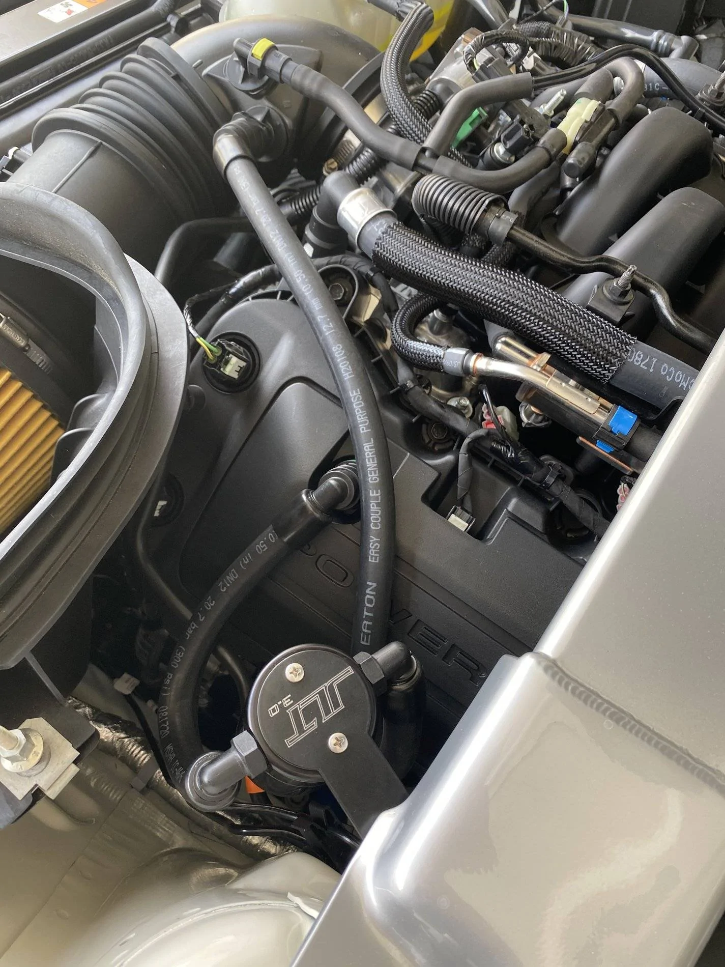

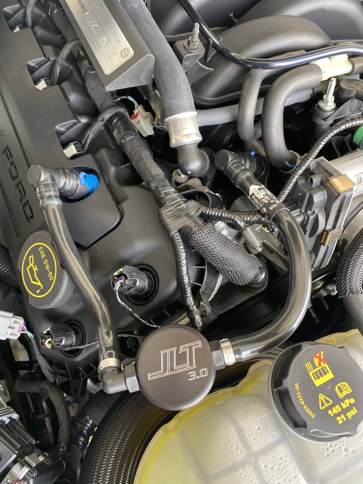

I haven't tried the ford performance one so I don't have anything to compare it too but I watched videos of the JLT and Ford performance and I went with JLT because it seemed easier to install and clean. You can unscrew the can with your hands.
I bought the one with the mount because I thought it would be easier to install but I had some trouble installing it, I would recommend purchasing the one without the mount.

i can tell you the JLT may not look "as OEM" as the FP but it is very high quality and it literally takes 5 seconds to unscrew. if you can swap a lightbulb you can do this one in the same time :) i love it. u wont believe how easy it is to check it or empty it.

I read extensively and watched many a YouTube video. Went with the JLT. Takes two minutes to install passenger side. Driver side takes about 10 min if you have the wrenches handy.

I have the FP version and don't think it is very difficult to empty. Unscrew four allen cap screws, sop up the oil with a rag, put it back together. It does look very OEM, which I like.
Only comment is to be careful as you're removing/installing the allen head cap screws. They are tough to find in the bottom of the engine compartment/on top of the splash shield if you drop them. At least that is what my friend tells me.......:)

RPDBlueMoon I'm curious, what did you have trouble with when installing this version? I like it better than the other, as it is secure/cleaner look and not just hanging out there.

I can attest to that... I dropped one of the machine screws into the belly pan while emptying the passenger-side FP catch can in the middle of a track weekend. D'OH!! Fortunately the guy in the garage next to mine had a flexible, extending magnet with a built-in light on the end. Now I bring one of those to every track weekend, just in case!

I installed the FP passenger side. I plan to use a syringe/or pump (like a soap dispenser) to empty.
