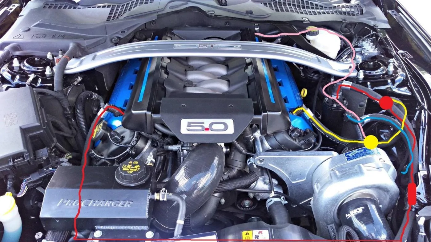

Im in the middle of the install and I was confused about the routing of houses. But according to your pic, it seems They sent me the bottom circled hoses in 1 piece and not in two like in your picture. I just don't want to cut it until I'm certain it's supposed to be that way.

Mine is not in one piece as it looks, there is a connector joining the long one and the short one together.
Here is a pic of my routing....sorry for my lack of skills..:)
Red line hose - pass side dirty line under coolant tank, under radiator cover to drivers side. Solid red rectangle where the hose connector is taking it to the tee (red circle). Other side of tee goes to top of catch can.
Yellow line hose - drivers side dirty line going to fist tee (1/2" x 3/8" x 1/2" tee ,yellow circle) then to second tee (1/2" x 1/2" x1/2" tee, red circle).
Pink line hose is the small 3/8" vent hose from IMRC factory Y to 1/2" x 3/8" x 1/2" tee.
Blue hose - clean line from catch can to Procharger air intake tube fitting.
The kit does not come with the tee's , hose connector , or single connection point on the PC air inlet tube. These where all local auto part store pieces.

I routed things a bit differently and wanted a single connection fitting on the air intake tube. I will let vendor chime in on completeness.

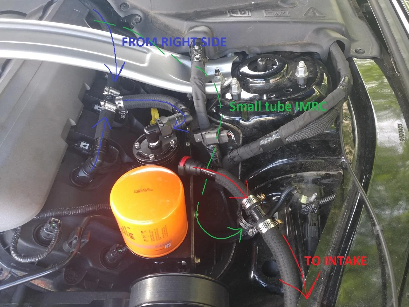

Hi guys, just installed the same kit
RHD Australian mustang here (the procharger kit fits well on RHD cars). Note I've relocated my oil filter after installing an aftermarket oil cooler.
Hopefully I installed it correctly. Mind the dirtiness of my engine bay, my hood vents open it all up to the elements haha
I ran a hose rearwards, behind the engine cover from the right side over to the left. I attached the small IMRC line to the clean side (between the catch can and intake)
Any comments on whether this is ok? and yes, I know I made it hard to get to the dipstick
:headbonk:
Cheers!

UPR Procharger Catch Can Installation - Looks Great !
Actually, it's nice to see the handy work and it looks good. You made it work with the relocation kit and that's all that matters. I'd love to see a few more images of the complete engine bay.

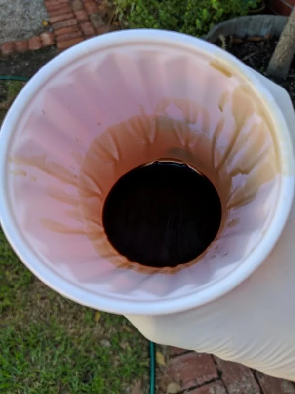

Hi Joe, sorry for the radio silence!
After about 5000km the catch can had about 60mL of brown oil with tiny metal filings in it.
