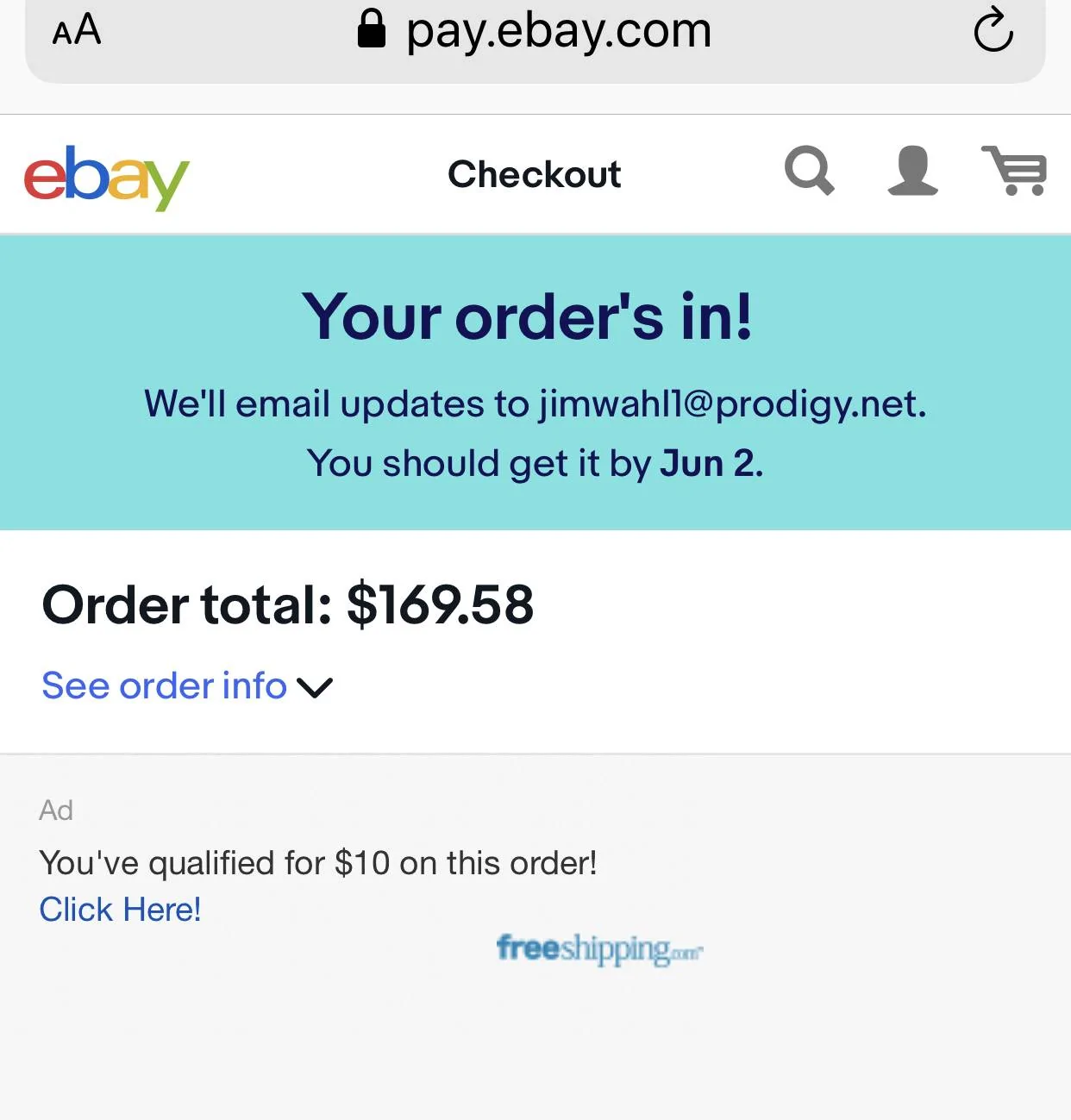

For what its worth, here is a listing on ebay for the correct case. Not a bad price considering it has free shipping.
https://www.ebay.com/itm/Pelican-16...050596?hash=item5b6aa26164:g:DvcAAOSwJwFdnyEZ

I thought it was $159? Tax?
That’s including Idaho state tax ! Now I’m excited to get it to them ( My previously white ceramic heat shield inside the front wheels is turned kind of spotted gray yucky)
