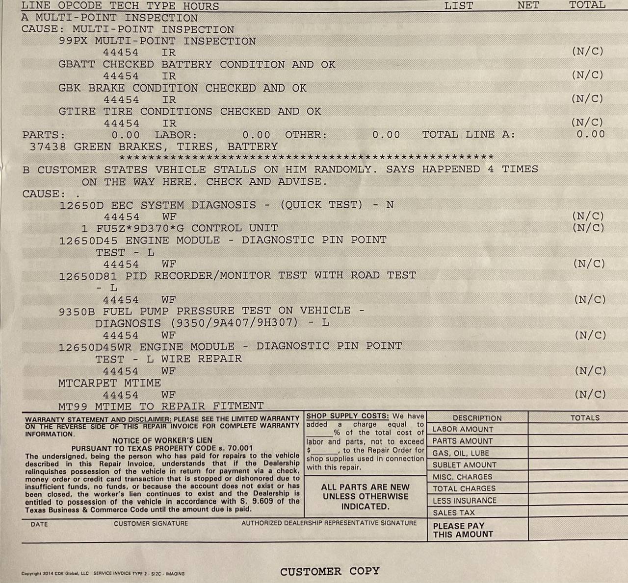

Quick update: Got the car back from the dealership after having the PCM replaced. Seems to be working fine now, but since it was an intermittent issue, I’m not quite 100% confident yet. Time will tell!

Did the Service Tech have any idea what could have caused the issue?
Unfortunately, they didn’t offer up an explanation, other than (paraphrasing) “sometimes things go bad”.

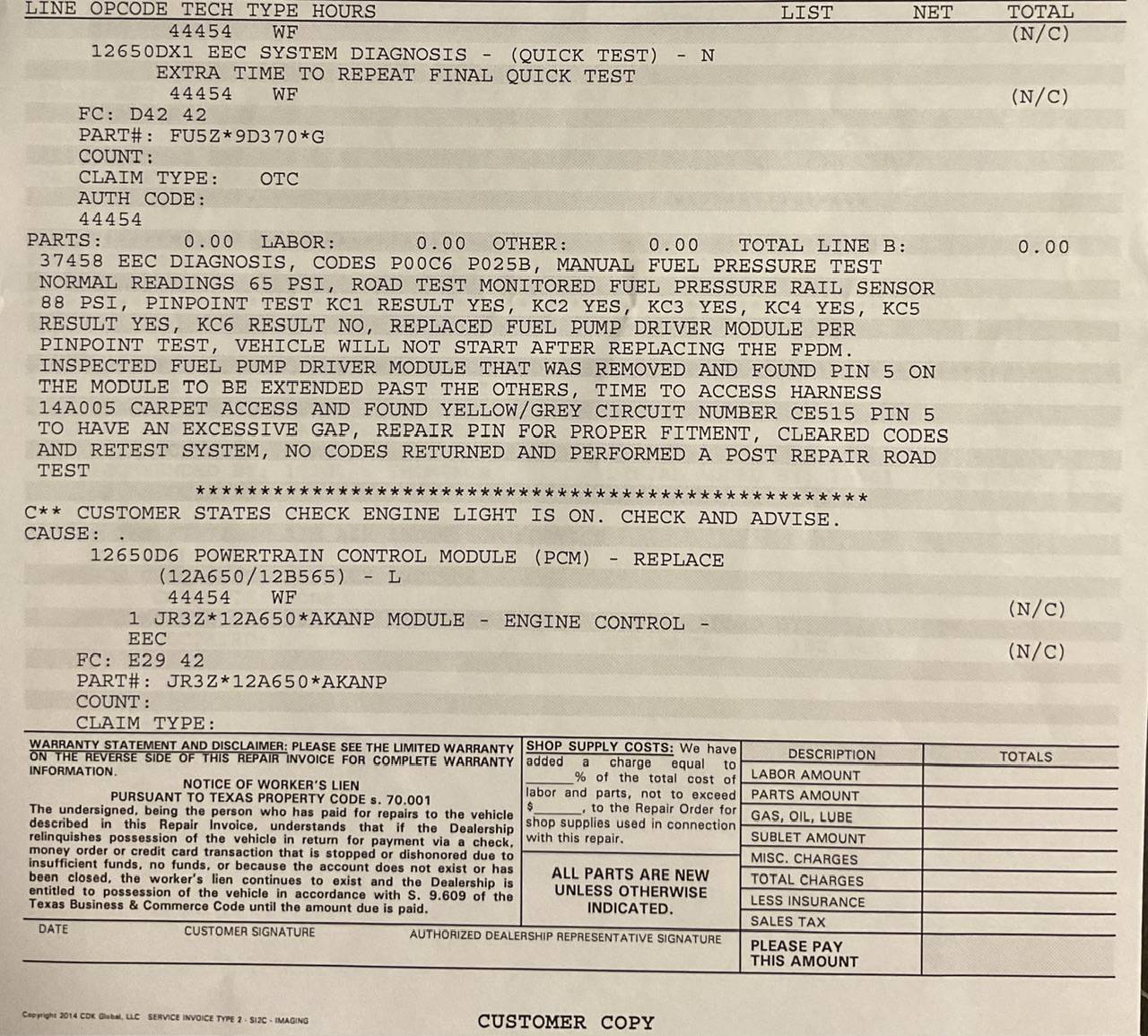

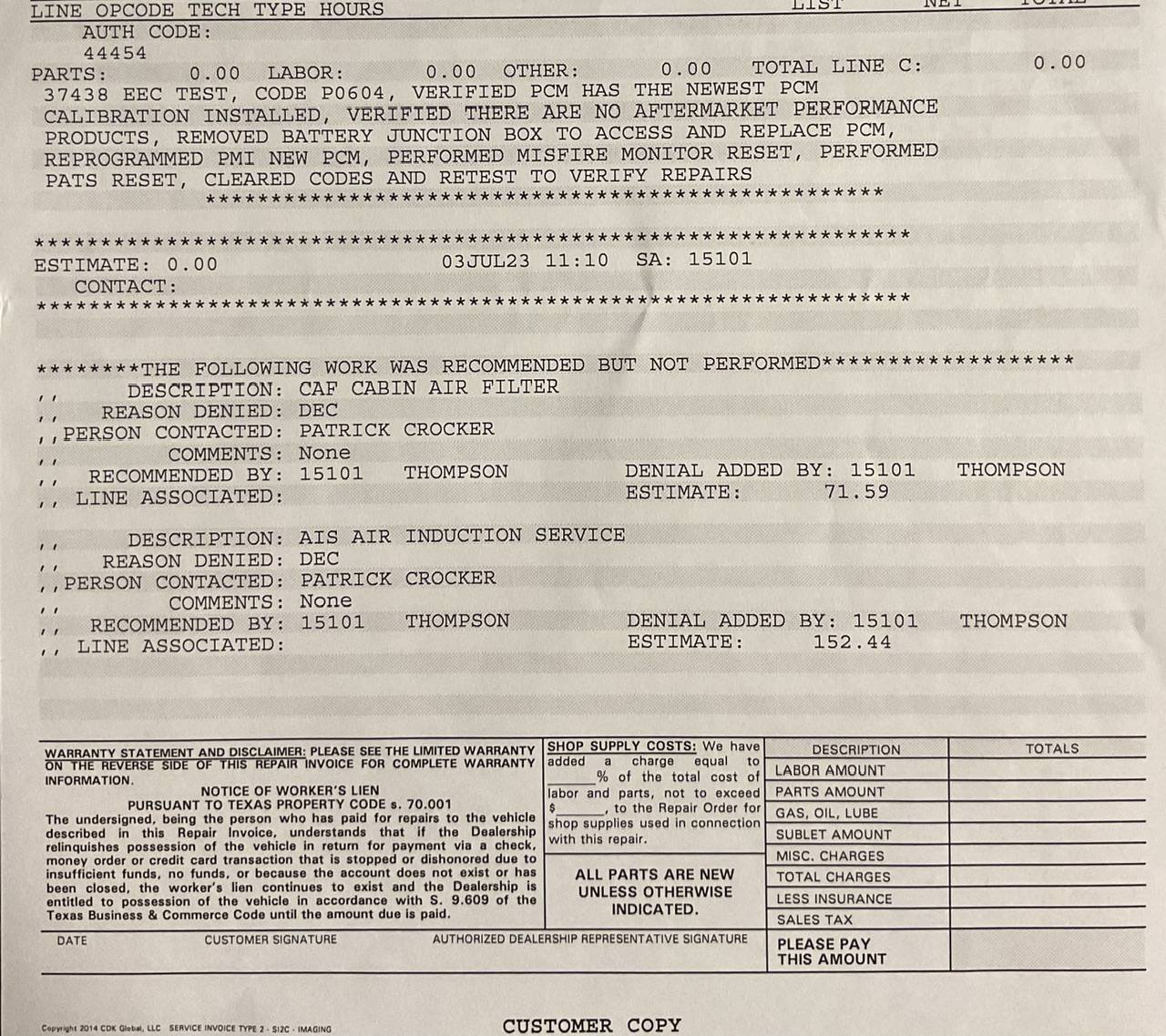

Here are the tech/repair notes if anyone is interested:

Looks like a solid diagnosis. I wonder if the bad pin fitment issue found caused the ecm fuel pump driver to burn out from the excessive resistance
