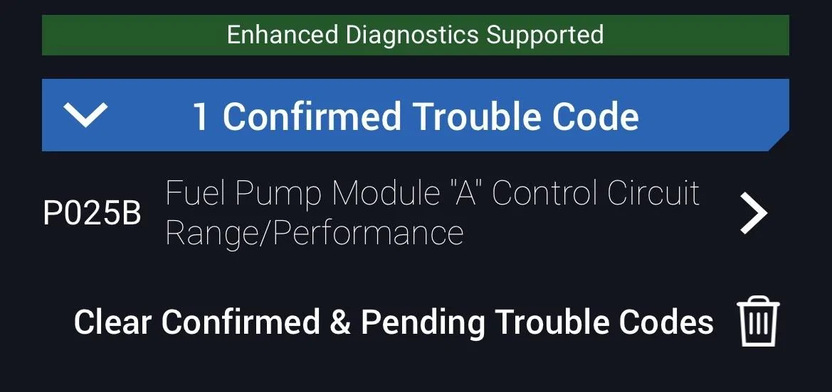

This time the CEL did come on, so I pulled the code and got: P025B Fuel Pump Module “A” Control Circuit Range/Performance

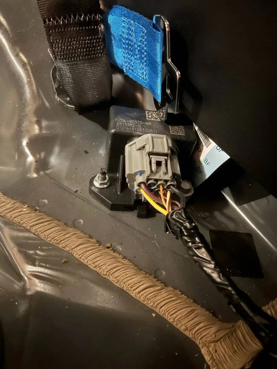

To try something out, I removed the rear seat to inspect whatever the hell is underneath there (yeah, fuel stuff). I found what I believe to be the “Fuel Pump Module “A” Control Circuit“ thing:
I unplugged it and then started the car, and as expected the car started but quickly died. That triggered a P025A Fuel Pump Module “A” Control Circuit/Open code. That just verified to me that it’s the right part.
I plugged it back in, and the car started right up and idled perfectly. I guess that the module could be intermittently bad, triggering the P025B code? 🤔

Possibly yes. Solid-state stuff won't always stay dead; they will commonly go intermittent so as long as you don't see any issues with the wiring or connector, I'd replace it and see how it goes.

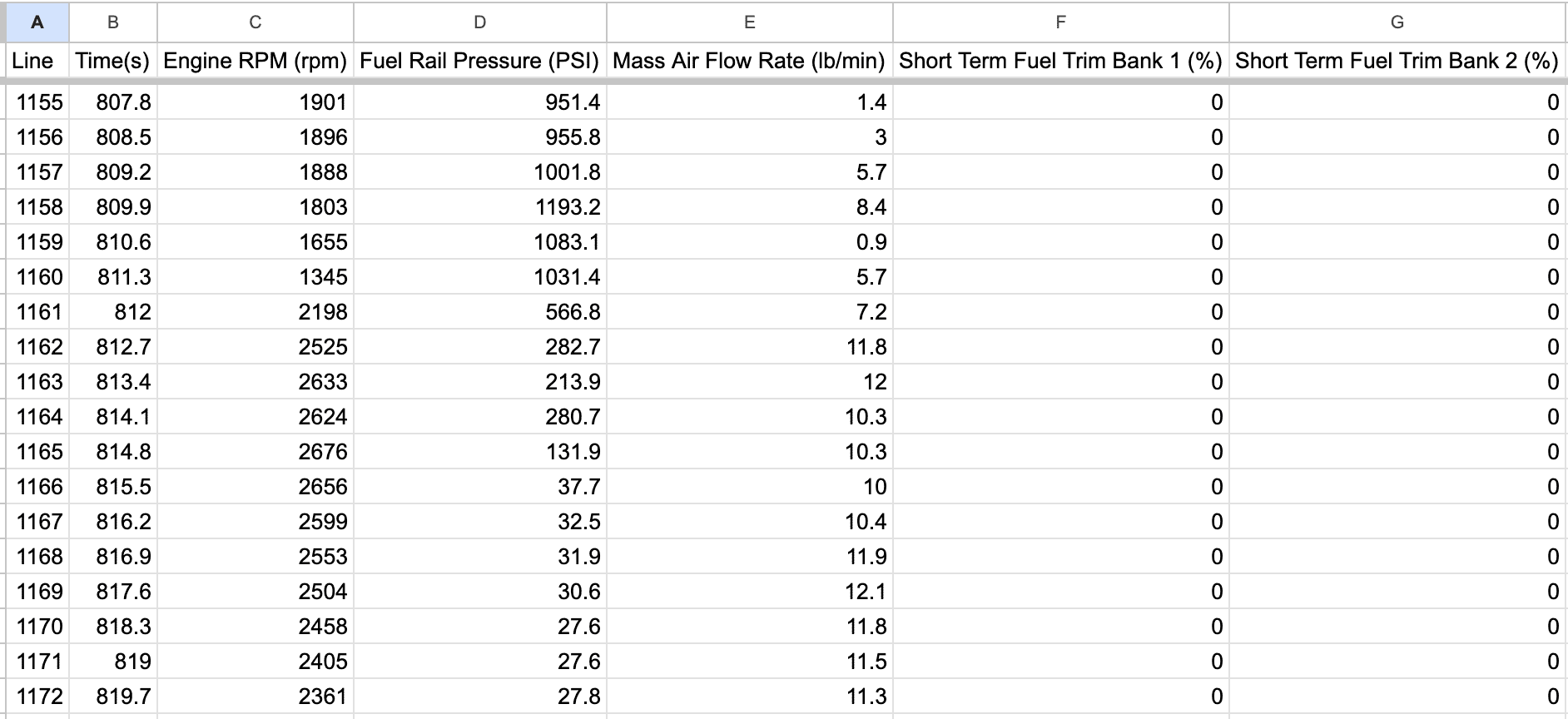

I'm just did a drive while data logging with my BlueDriver OBD-II tool. I was able to capture data when I lost fuel pressure, however, I'm really not sure what "normal" data is suppose to look like.
Looks like I'm averaging around ~950 PSI for Fuel Rail Pressure when things are running good... no idea if that is "normal" 🤷‍♂️
Here is the data (link to sheet):
Things get interesting around line 1161 where we drop to 566 PSI before further plummeting:

driver rarely goes, but will compensate for a bad fuel pump to the point where it'll throw that code. Replace the pump.

What's killing me about this is the seemingly random times when I lose fuel pressure. I have no problem replacing a bad fuel pump... I'm just struggling with "is the pump bad?"
I wish there was more of a smoking gun here...

There won't be.
Yeah, it's looking that way, but would be good to see if there is a way to test this.
So, according to my data, the Fuel Rail Pressure drops during the "event". That leads me to believe that (A) either the fuel pump is getting the correct voltage, but fails to deliver the right amount of fuel/fuel pressure from the tank, or (B) the fuel pump is not receiving the correct voltage during the event, which would possibly point to another failure in the system.
Is there a good way to test those scenarios? I could try to reproduce the intermittent issue and read voltage coming into fuel pump harness?
Yeah, no factory Schrader valve so get a mechanical fuel pressure gauge, adapters, lines, & watch it. Or replace the pump. Either way you'll know.

The pressure you already know from the sensors in the car, the voltage you know by tapping into the wires.
I don't think the car measures the output voltage of the module BUT before slicing and dicing you had better check that Forscan does not have a PID that may sound like "fuel pump commanded voltage / duty cycle".
If it's feasible and you don't want (like me) to slice open the harness I'll go around with a multimeter, quickly disconnect the pump (if there is a disconnect) and measure the voltage without turning anything off.
Anyway it's either the driver or the pump, being that you already replaced the driver...
