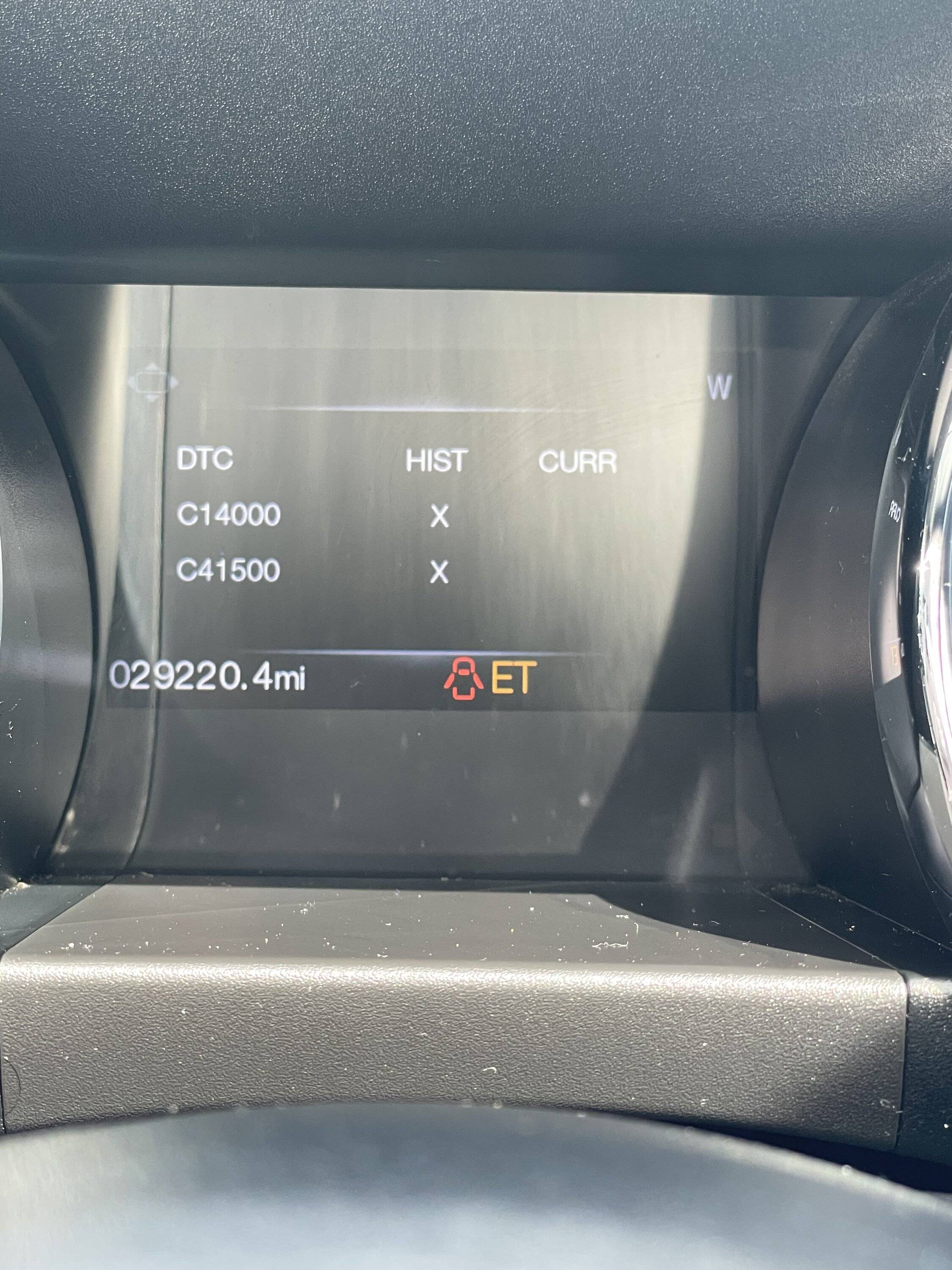

Have you attempted to extract any codes?
If not - here ya go:
If you have a 2015-2020 with the ANALOG gauge cluster, you should be able to enter the “Engineer Test Mode".
Follow this link:
https://www.mustang6g.com/forums/threads/engineering-test-mode.27581/
If you you have a 2018+ with the DIGITAL cluster, you should be able to access the same test mode found here:
https://www.mustang6g.com/forums/th...n-18-digital-dash-old-way-doesnt-work.115231/
Thanks. I didn’t have any DTC codes on the current list but had 2 on the history list. I forgot to mention that I took my car to get an oil change on Monday afternoon. I opened the Intake box and it looked like the filter wasn’t sitting right. I have started the car multiple times and everything seems fine. Hopefully that was it.
