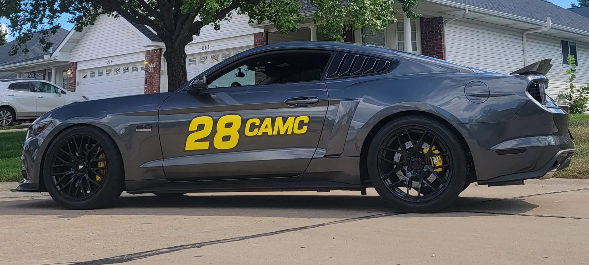

I'm running Steeda linear minimum drop springs with Ford Track shocks and struts. My driveway is like yours and I've just got used to angle in and out.

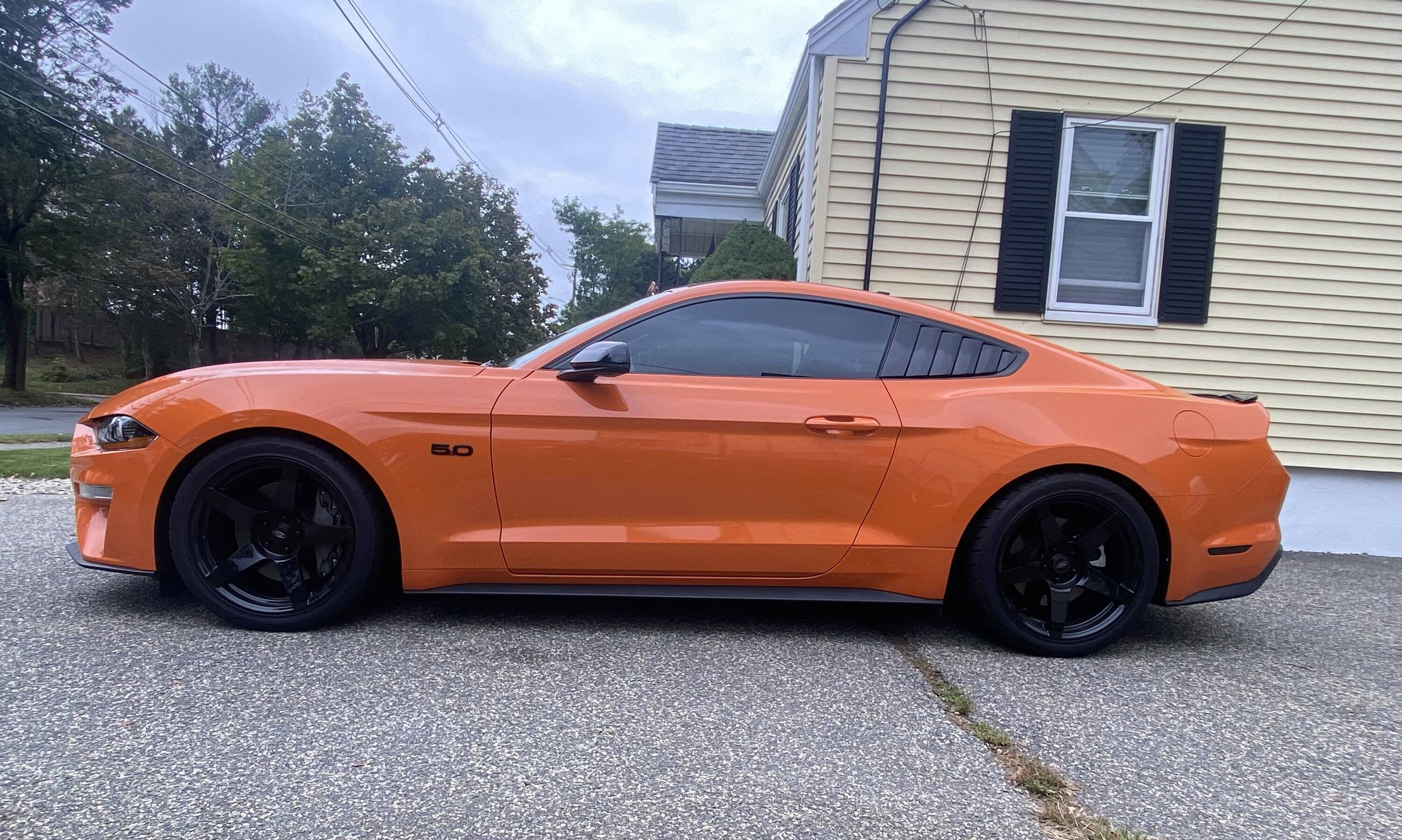

I’m running Steeda minimum drop linear springs with Steeda Pro-Active shocks & struts…The only time I’ve scraped is going over some speed bumps and that was mid body. My driveway is flat so I can’t help you there.
