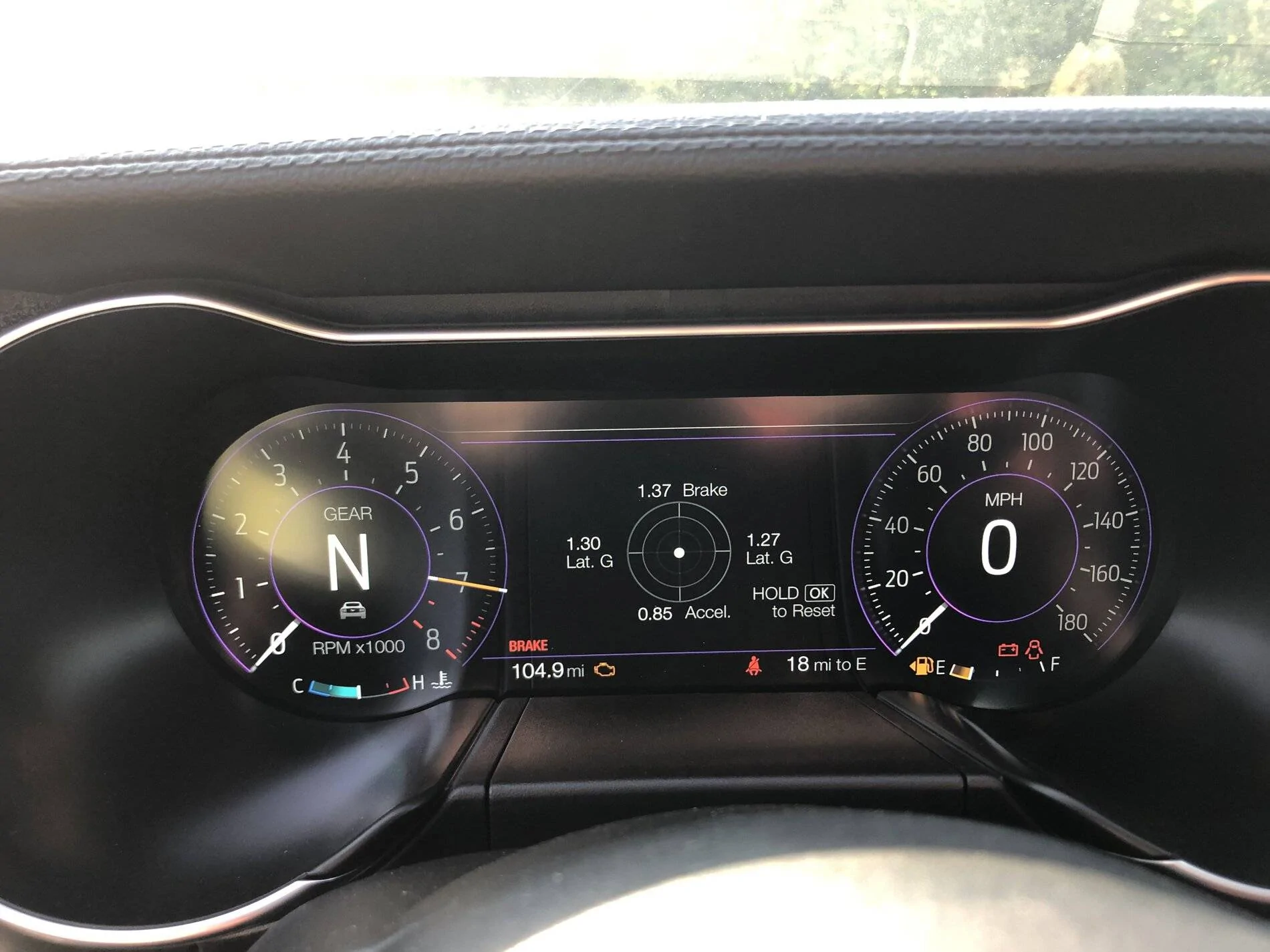

Was at Road American today, driving in race mode and turned off TC with the switch on the dash and confirmed it ok.
I really don’t think it was fully off:
1. the avoid collision flashed on the dash when I was passing a Porsche GT4.
2. Out of many corners, with the power on I could feel the rear brakes dragging.
3. car seemed sluggish if I pushed too hard.
4. Here’s a photo of my G’s
