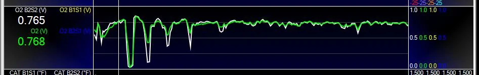

Following advice above, I removed the spacer/minicat from B2S2 and did a datalog with VCM scanner. I can't get B1S1 or B2S1 to populate in HPT, it gives me the "unsupported parameter" symbol when I try to add those and you can see they are not logged below. Is this normal? Should I bring up a different parameter to test the cat functionality?
Any help greatly appreciated.
