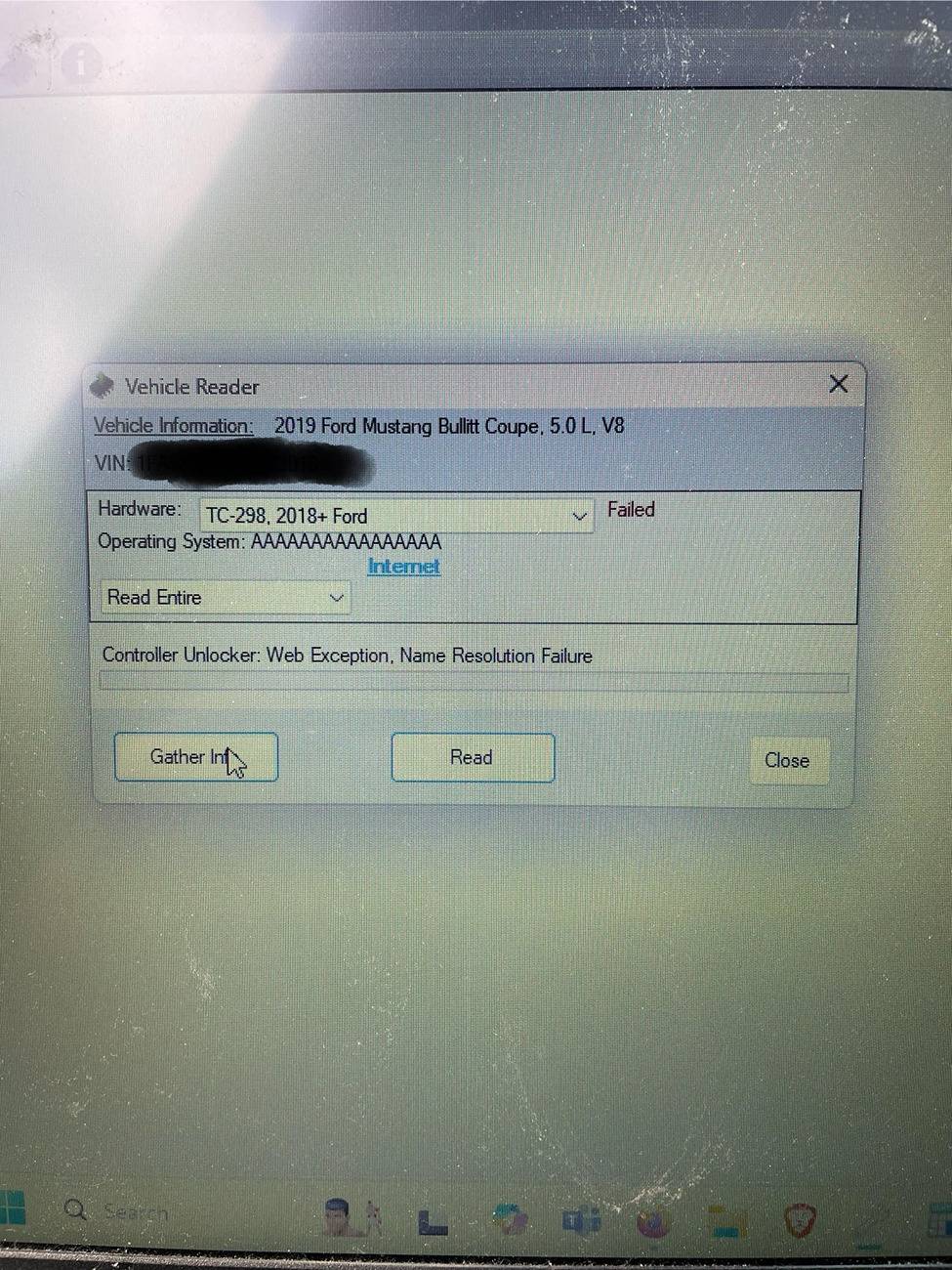

Recently acquired a 2019 Bullitt with a Whipple, I believe it's the 50 state legal version. Car came with no documentation, I am assuming it was tuned with the RTD from Whipple. I hooked my MPVI2 up and ran VCM editor, but I'm unable to pull the current tune. I set hardware to TC-298 and it says "Controller unlocker: Web exception, name resolution failure". I havent purchased credits for this car yet, but my understanding is I can pull the tune without credits. Am I missing something? Any help would be greatly appreciated.
Can MPVI2 pull a tune that was uploaded by RTD?
It depends on if the tune has been modified and locked by a third party. Are you running the latest HPT beta? Are you certain the car is using the Whipple calibration rather than a third party custom tune?

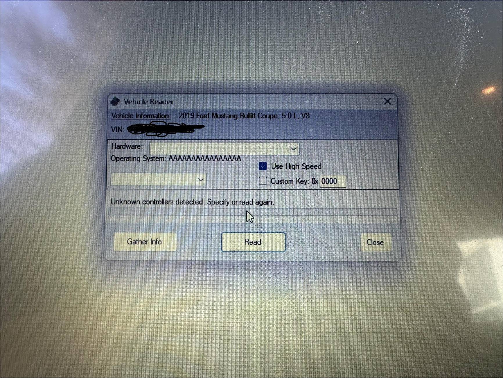

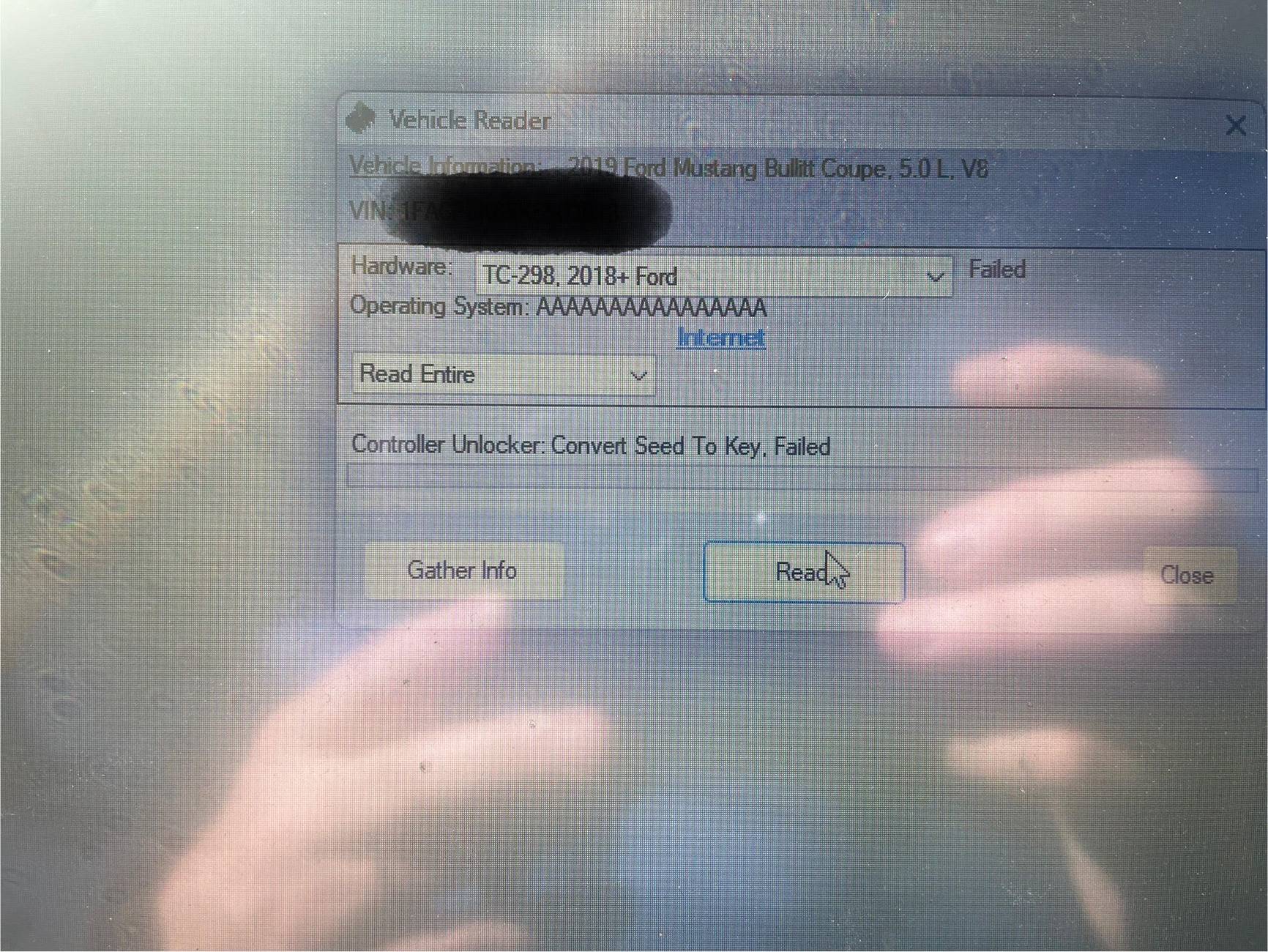

Thanks for this info. Theoretically my MPVI2+ with 4.10.7 should be able to pull the tune from this 2019 Bullitt w/whipple. We don't know the history on the car, was bought at auction and came with zero documentation of the mods. The kit appears to be the 50 state legal version, with a CAI, and stock exhaust other than xpipe/resonator delete. Below are images of the error messages I received when trying to download the tune with VCM editor. Am I doing something wrong?
These kits came with the RTD, my understanding is I should be able to download the RTD tune with MPVi2+. The other possibility is the car was tuned and locked. Any thoughts on figuring this out?

As far as I know a tune flashed and locked with RTD cannot be downloaded with MPVIx.
Two different file formats. I know I've tried to open RTD tunes with my MPVI2 and it doesn't work.
You would need PCMtec with custom OS option to open it I believe.
@Wengerd Performance or @Rolls Might pop in and give a positive answer
Maybe @engineermike knows

What version of HPT are you using?
I still think it is a locked tune but using the newest Beta might open it.
