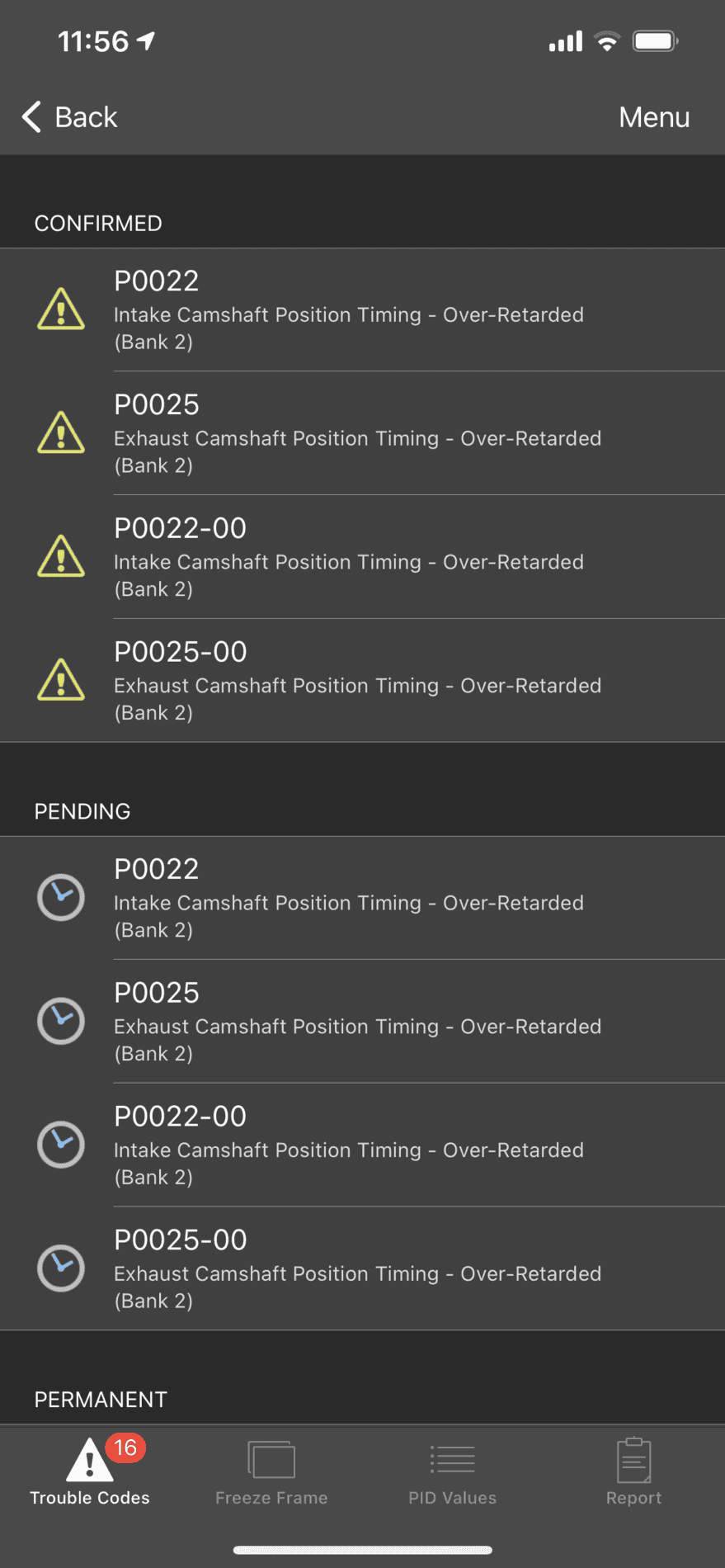

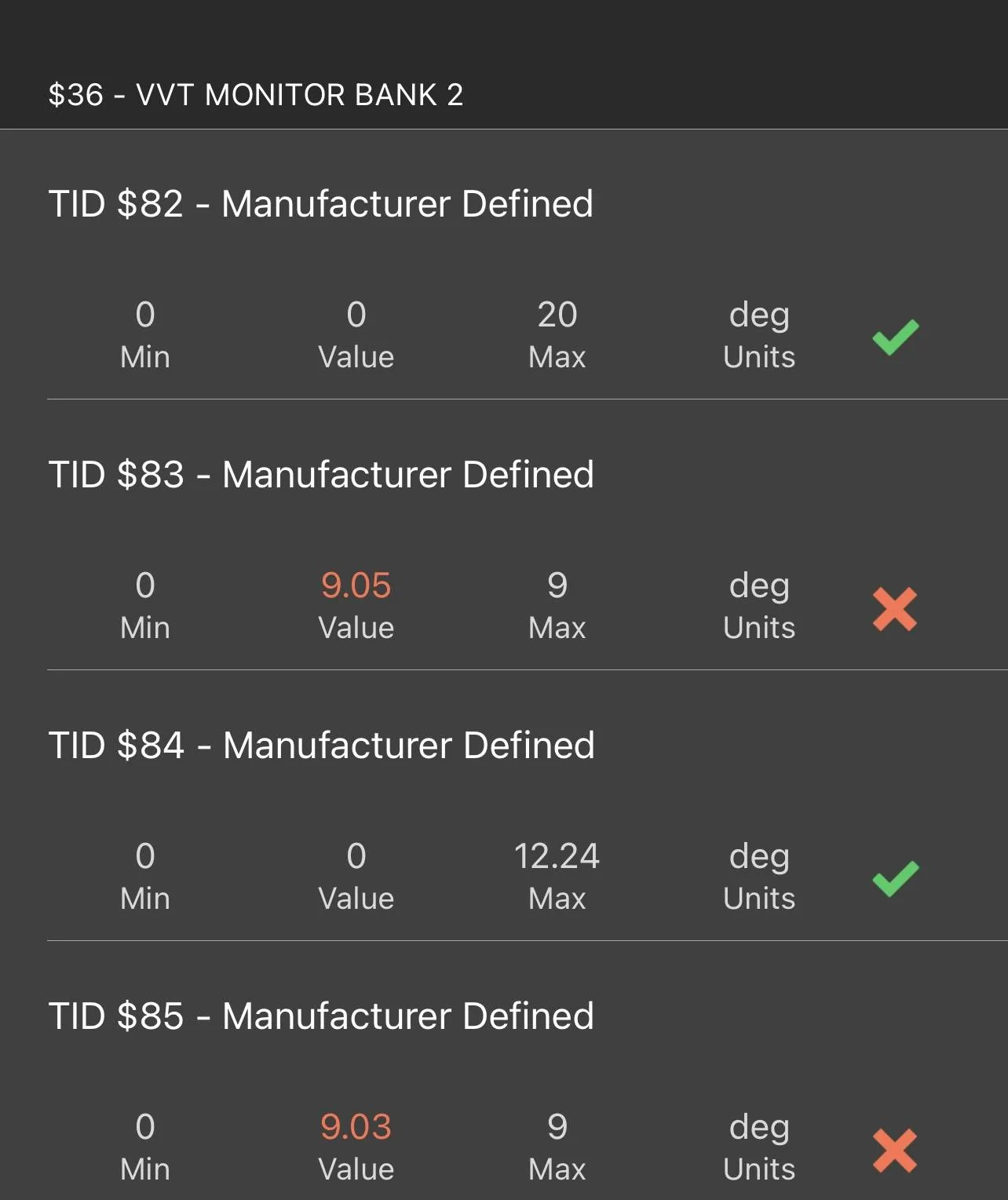

All, I’m hoping someone can tell me if they’ve experienced what my car is telling me and what the fix, if any, was.
Yesterday I was running at the track (Laguna Seca) and in track mode and on a couple non consecutive runs my car gave me a solid engine light. I had an OBDII sensor plugged in so I ran a scan and it told me my cam shaft position timing was off by a small margin. You can see the exact message and reading in the pic.
After the first time it happened I cleared the codes after talking to my mechanic and then did a run at 60% or so and it was fine. The next run out I pushed it again and I got the same code (actually just one this time instead of two the first time). I cleared the codes again and called it a day. By the time I drove home from the track the permanent codes were also clear.
any ideas what is going on? I’ve never had this issue at the track before. Oh and my car is a 2017 GT350

I’ve had these two things happen on multiple occasions.
It could be the wires are being stretched at the camshaft solenoids for both connectors on bank 2 and are intermittently coming out of the connector (or possibly just pulling far enough away where contact stops being made momentarily.)
There’s also a possibility that both solenoids on bank 2 have broken free from their hold down bracket inside of the valve cover.
I’d say give each of the 4 solenoids a tug side to side to see if there’s any play. If they have play, that’s likely the issue.
Im betting it’s wiring though, as it’s a known weak point. @honeybadger has a video discussing it:

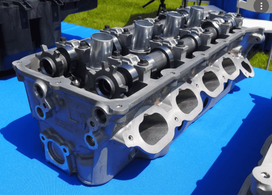

Other thing to consider...and this is likely very rare but I'll tell you my experience... (this was on a 4V Mach1 engine a few years back) The camshaft position sensors are actually on the rear of the heads - I believe the 350 is still like this based on this image (see the space in the head for both pickups on that head and the reluctors on the rear of each cam). Those reluctor wheels are pressed on and in my case, it was loose enough on the camshaft that it moved a few degrees, throwing a position code. I checked timing a few times and I couldn't explain it and then found the wheel loose. I manually moved it to what should have been very close and it was right on the money and started running perfectly. I eventually swapped the cam out.
