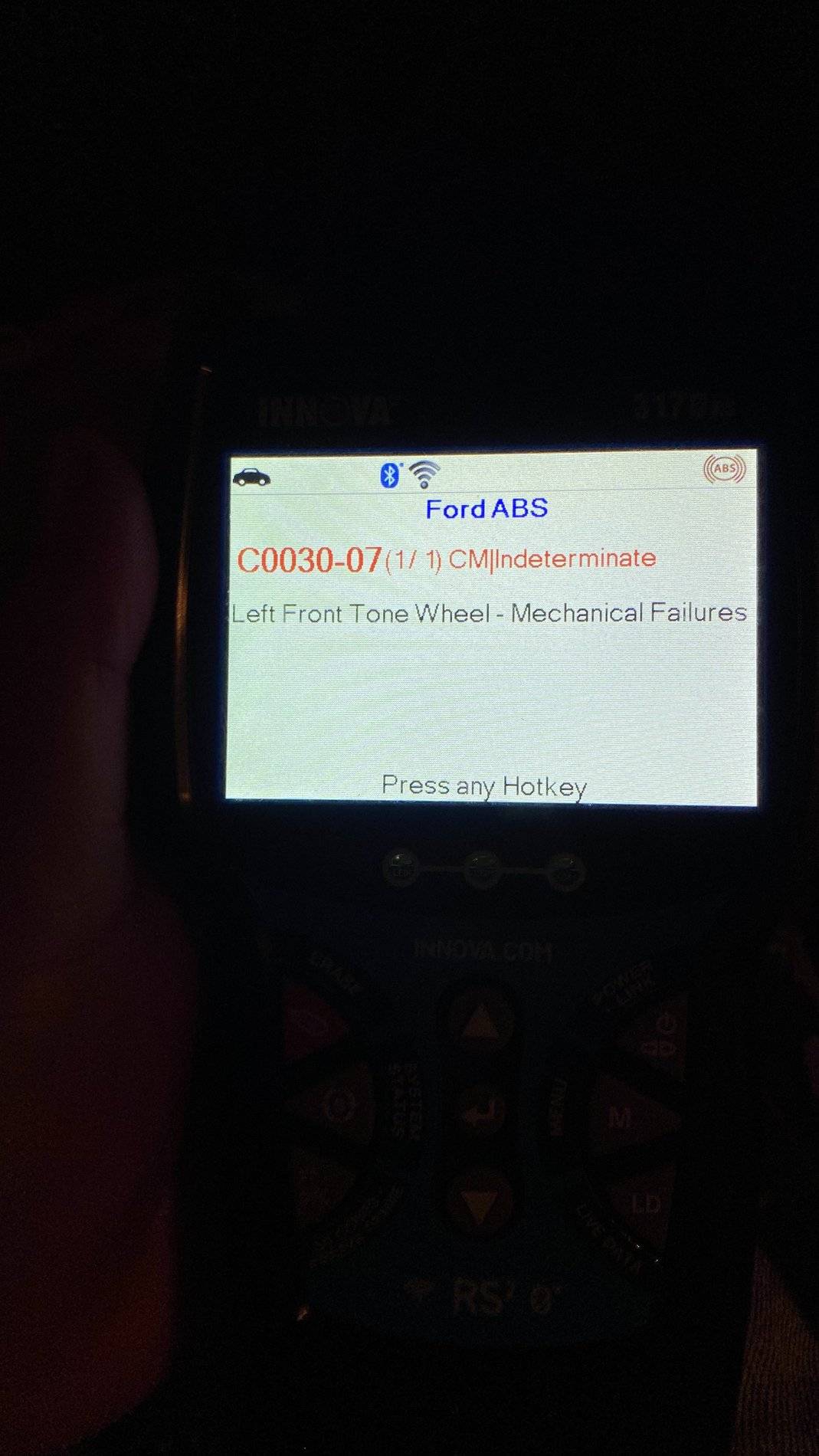

I got a problem with my 2019 GT350..
First , I replaced the wheel studs to APR studs for my four wheel hub .
When everything done . I found the ABS light on . Then , I used OBDII scan tool to check ,found DTC C0030:07 .
Means the Left font tone wheel - Mechanical failures.

The picture below is the back of the front wheel hub on a GT350. The black ring marked by the red arrow is the "tone ring" for the wheel speed sensor, and if it's damaged then the hub needs to be replaced. The factory service manual says that if you have the C0030:07 DTC, then either the sensor is bad or this ring is bad. If the sensor is undamaged then the ring is the only thing left.

Thx , there is no damaged on the tone ring . I think i will try to replace the sensor first .
