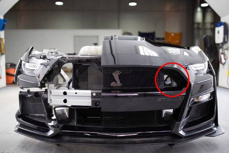

The stock air filter is a cold air system, it is just not exposed in the engine bay. There is a fresh air intake on the drivers side front grill.

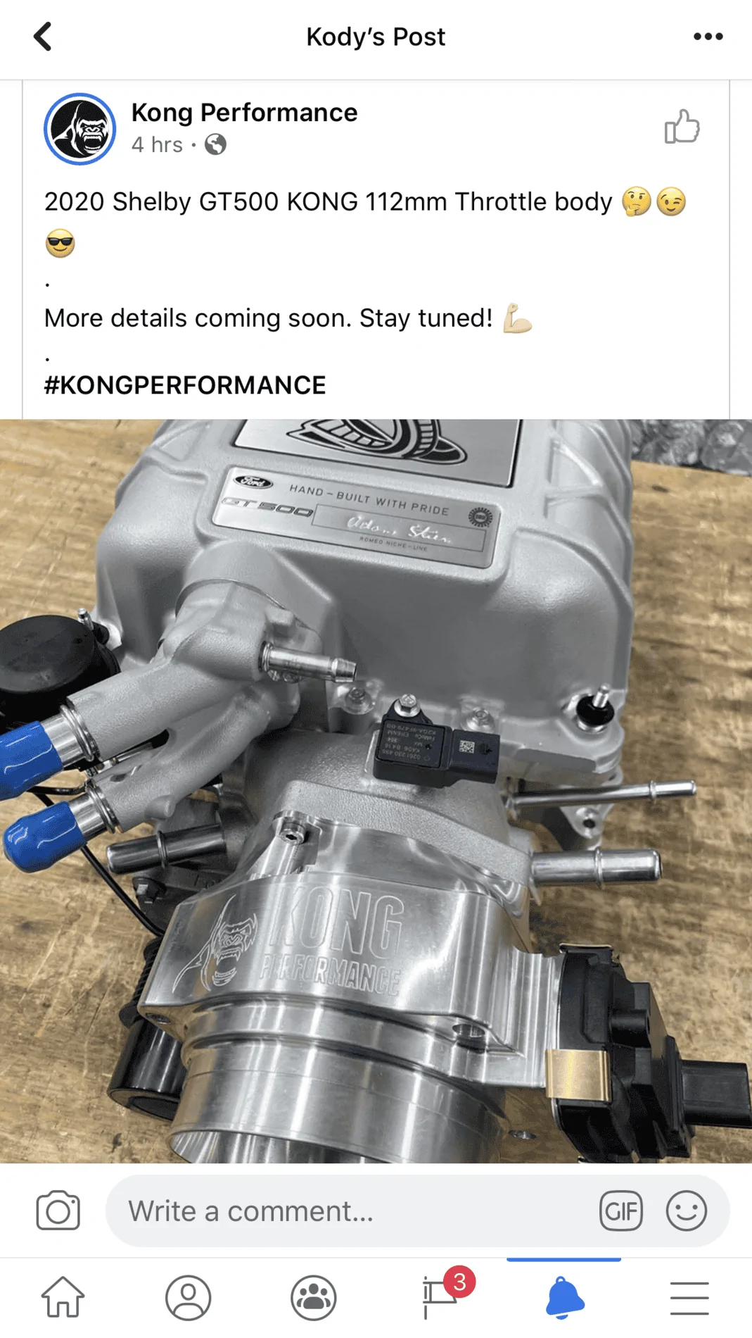

And so it begins....
