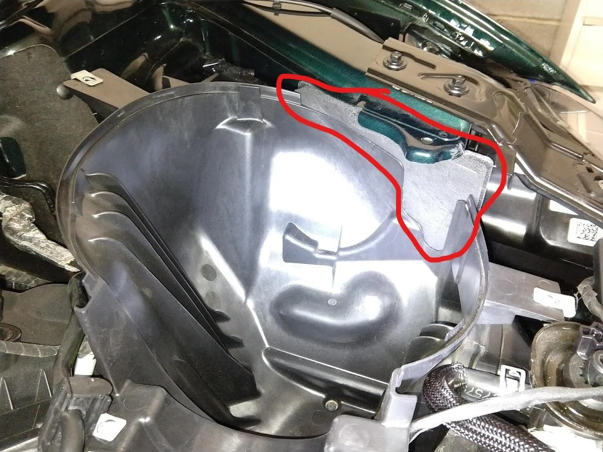

Finally got around to adding the 2nd horn which wasn't too bad after removing the throttle body which I found so much easier and less stress on the hose so my hats off to those that could do it. Anyway, I have a couple of questions regarding the factory install of the airbox itself and the gasket that sits on top of the airbox that seat against the hood when it is closed.
1) There is a piece of foam in one of the photos that were not fitting correctly inside the airbox and I was able to adjust but still doesn't look perfect (OCD on my part). Does anyone have any idea what that p/n may be? Mine was torn during the assembly it looks like.

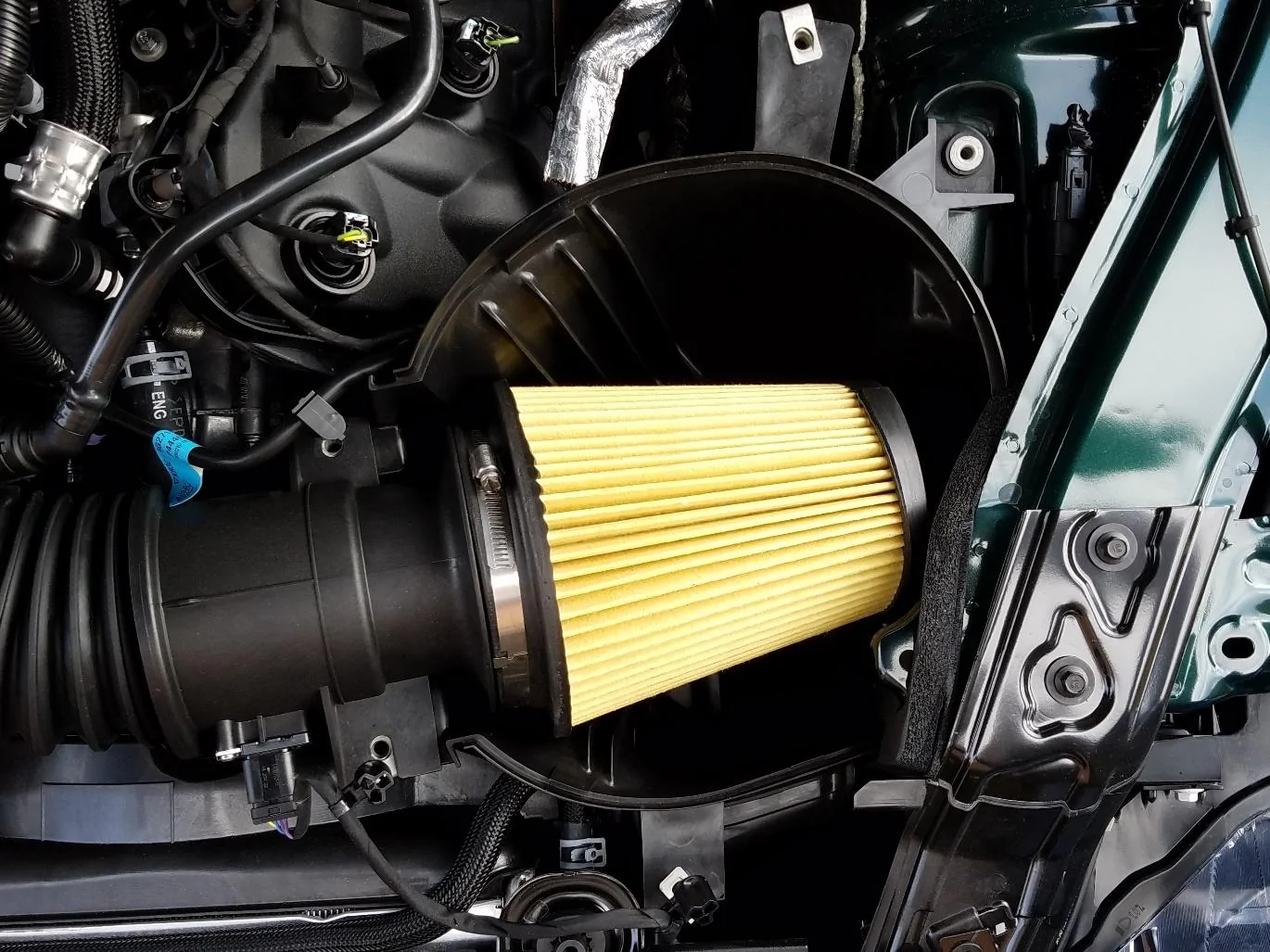

That piece is supposed to go above and below that piece of the fender. There's a slit in it that allows it to slide onto the metal. (possibly the "tear" you mentioned?)
See in this pic how part of mine is above the fender and in your pic it's all completely below it.

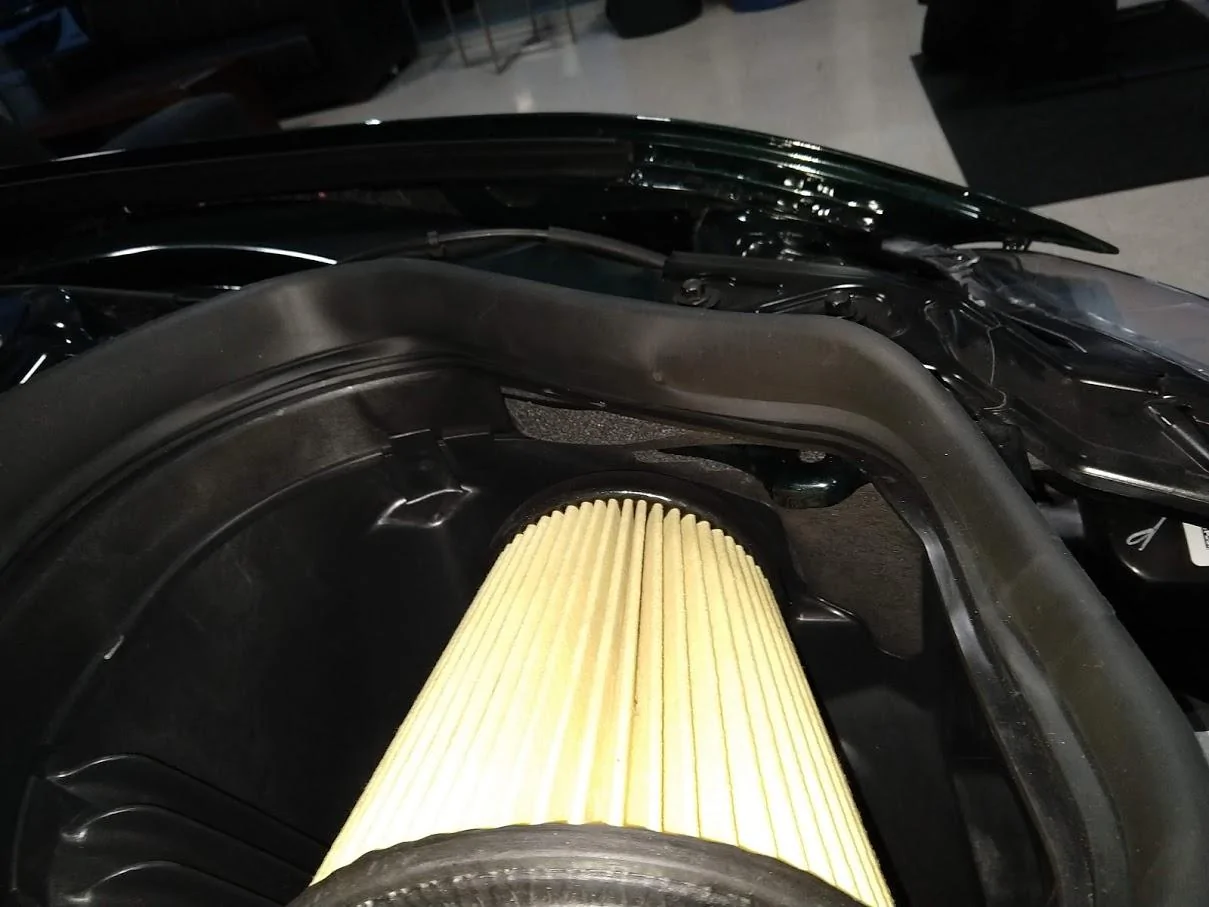

Doesn't yours have the silver grommet sleeve that's sits in hole where the gasket makes contact over the air box?

Looks like the silver grommet I was talking about was in the wrong place but I will definitely need another piece of foam as it doesn't cover the opening due to the tear in the foam. It is kind of odd how this was designed for that opening. Ford parts were given the run around to get this p/n so I had to remove the foam and take a photo so my parts guy could send it to Ford to get the p/n. How's that for service!
Do you remember how the foam was placed? I noticed there is a slit in the back of the foam so I pushed it slightly over the sheet metal from the inside of the fender to keep it in place.

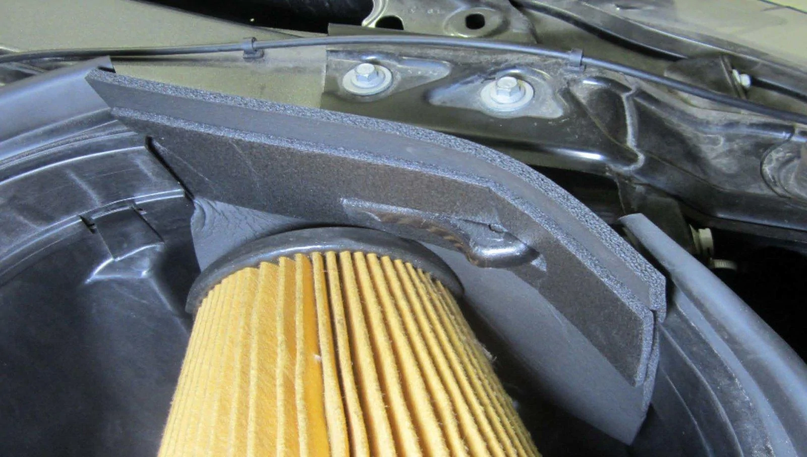

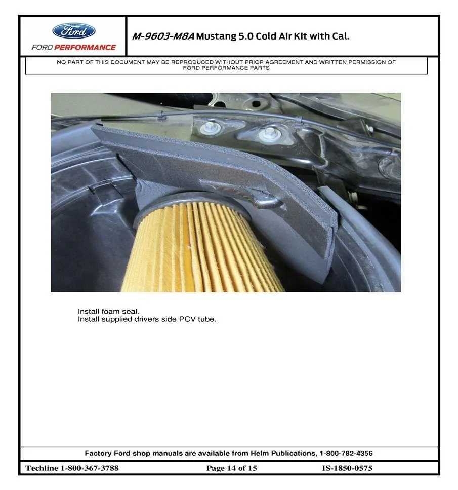

That's how it's supposed to be installed. That's what I was trying to say earlier.
You might try searching for some threads on the Ford Performance CAI's that come with their Performance Packs. That's what the Bullitt's CAI is actually.
https://performanceparts.ford.com/part/M-9603-M8A
