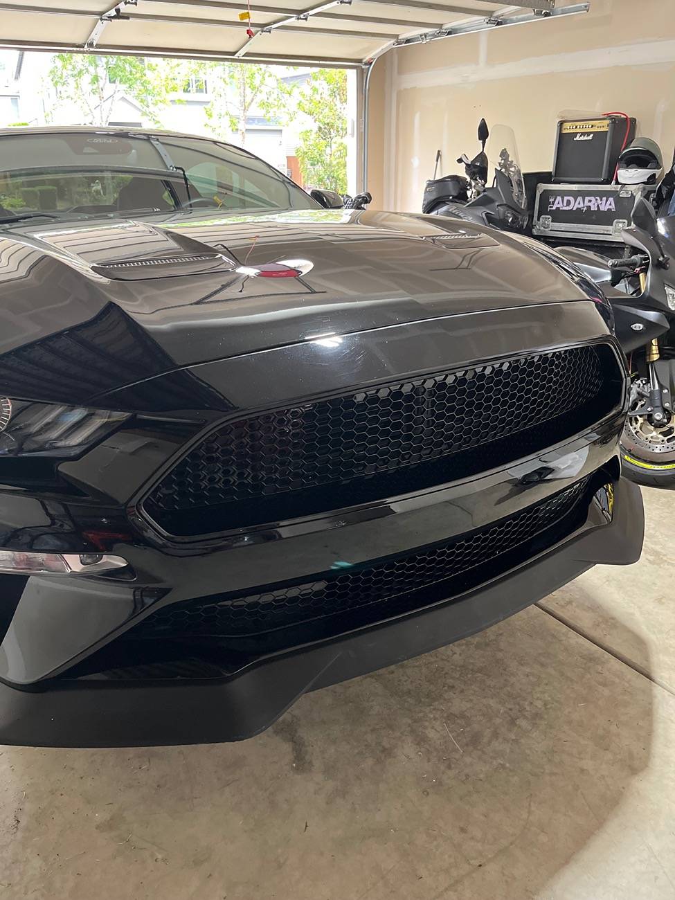

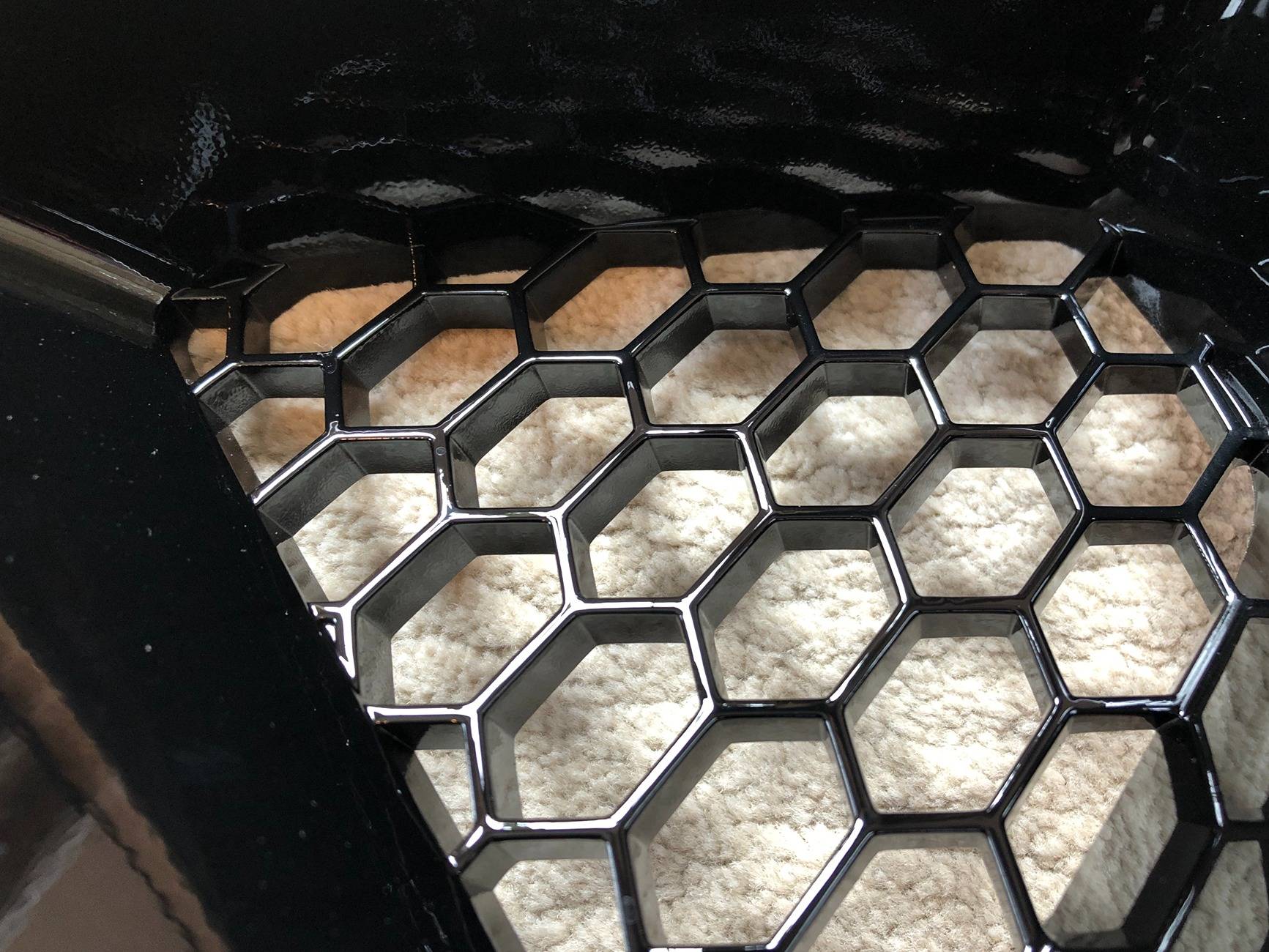

Hey WD. I can’t answer your question on the radar as I don’t have that option on mine. I have the Ford piece on mine and it is 100% gloss black. This is the USDM version, I don’t know if the Euro version is any different. I can go out and take more pics if needed
Hope this helps

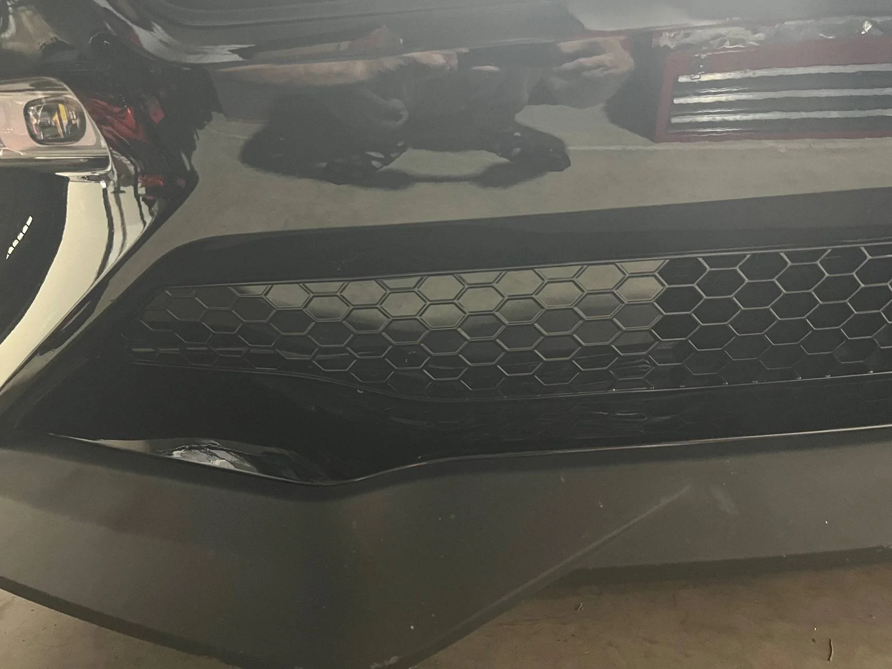

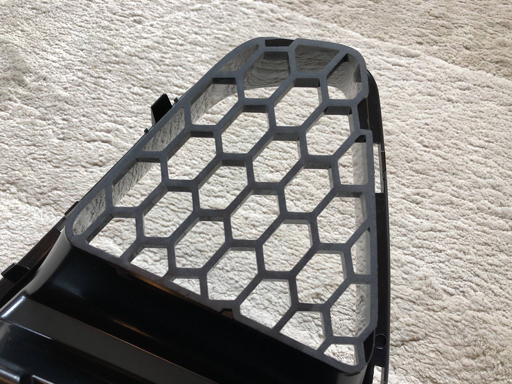

The euro version is different, I ordered it for my car with radar. It’s part number KR3Z-17K945-BA. You can see it’s more flat and much less pronounced honeycomb on the sides of the bottom grille.
That's it.
Some over here say no issues from the radar with the chinese replica USDM lower Bullitt grill, but i won't bet on this in every possible situation on the road.

as other poster stated KR3Z-17K945-BA is also used for 22-23 GT/CS lower grill for those that had the Adaptive Cruise Control.
you can see how its different looking to make the radar work if you look at it directly from front.

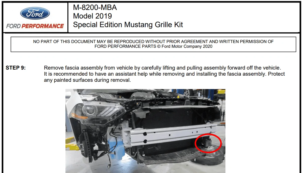

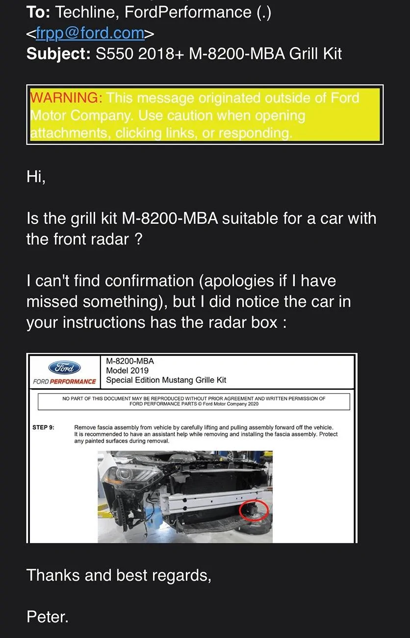

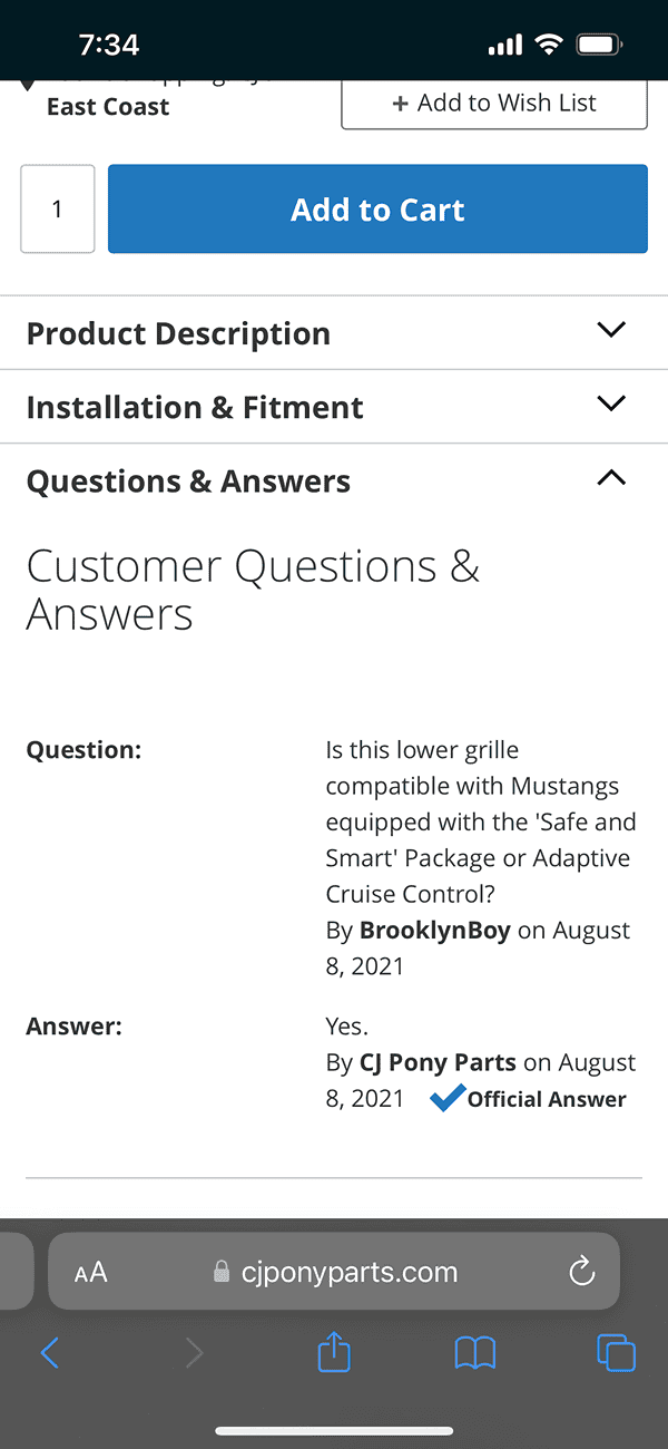

I do (much) prefer the deeper look of the FP grill, but has anyone seen if they officially state it’s suitable (or not) for the radar cars ?
Interestingly, look what’s on the car they use for their official instructions :

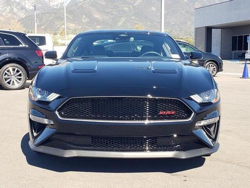

Someone asked the question to CJ Pony Parts and it seems they have verified it does work the the radar…

I have asked FP, so I will report back with what they are prepared to put in writing :like:

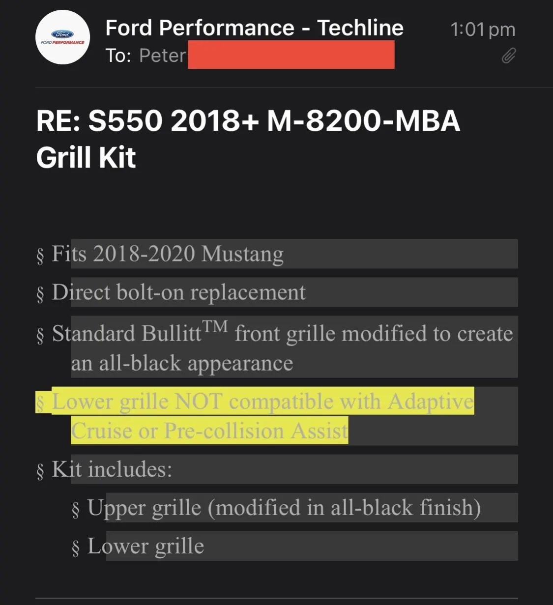

Well I asked this :
And got a simple, but direct answer back :
Note that they didn't respond to my comment about the demo car having radar ... :giggle:
All things considered, I think I'm still going to jump for the 'deep' style lower grill.
So am I right in thinking that :
A) The 'deep' grill is identical / shared between the FP kit, non radar Bullitt's and non radar CS's ?
B) The 'deep' grill is US part number KR3Z-17K945-AA ? (BA being for the radar version)

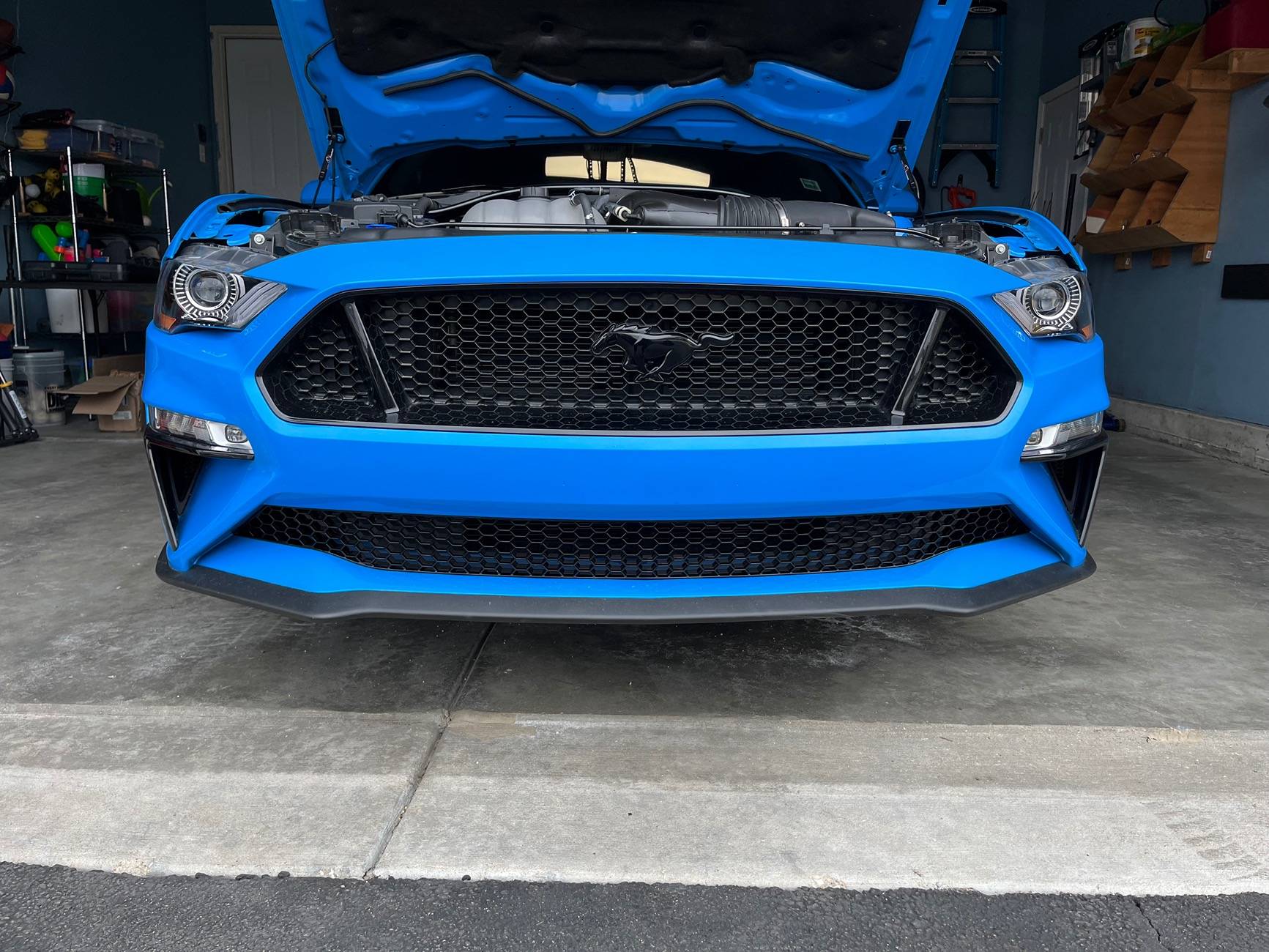

I installed a bullitt grille a while ago and the adaptive cruise stopped working after a few weeks or so. It now has a warning whenever I start the car and periodically while driving, the regular cruise control is inop aswell . I will be switching to the flat honeycomb despite it not looking as good. I also performed an ACC relearn which did not fix it.

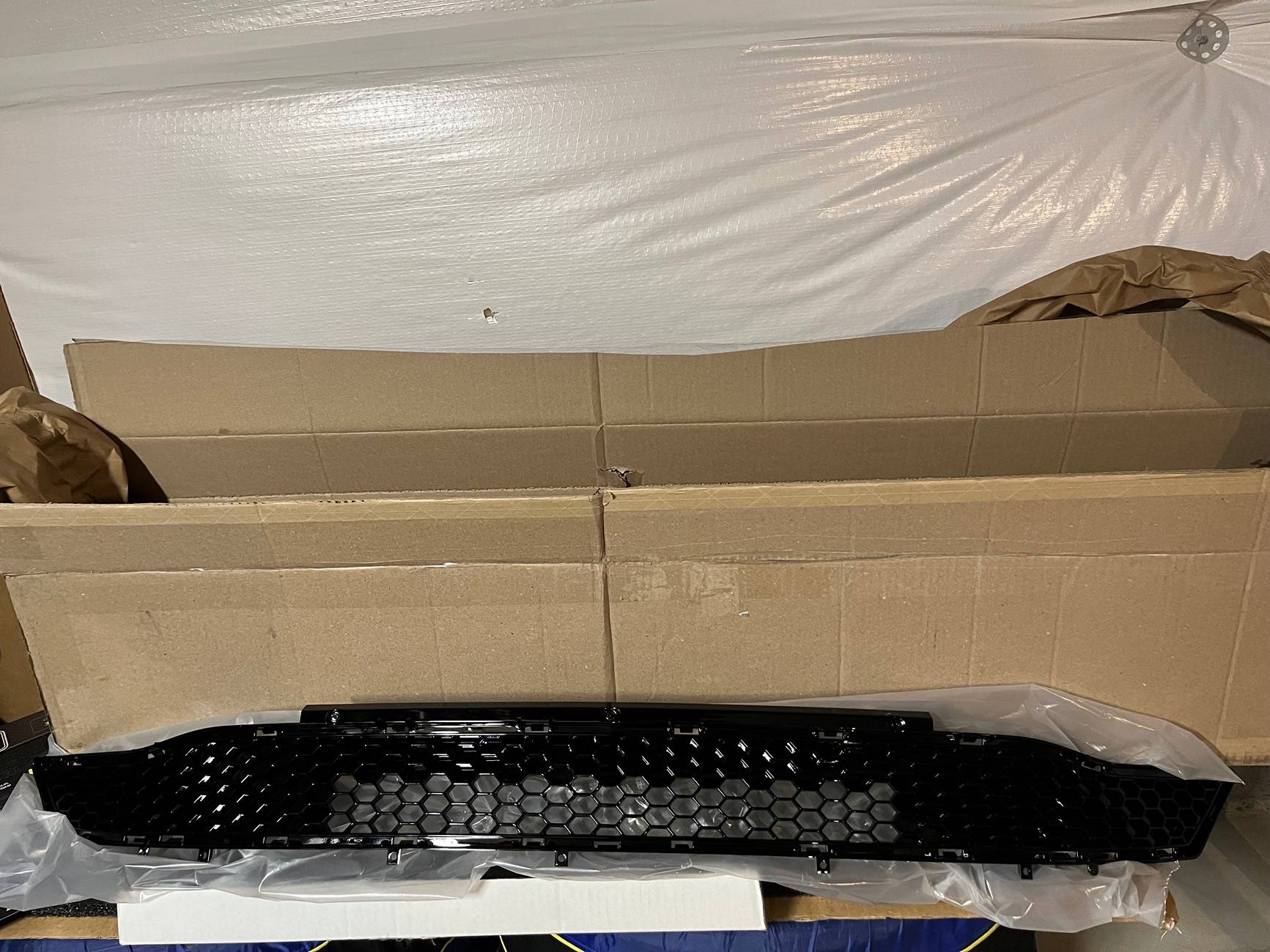

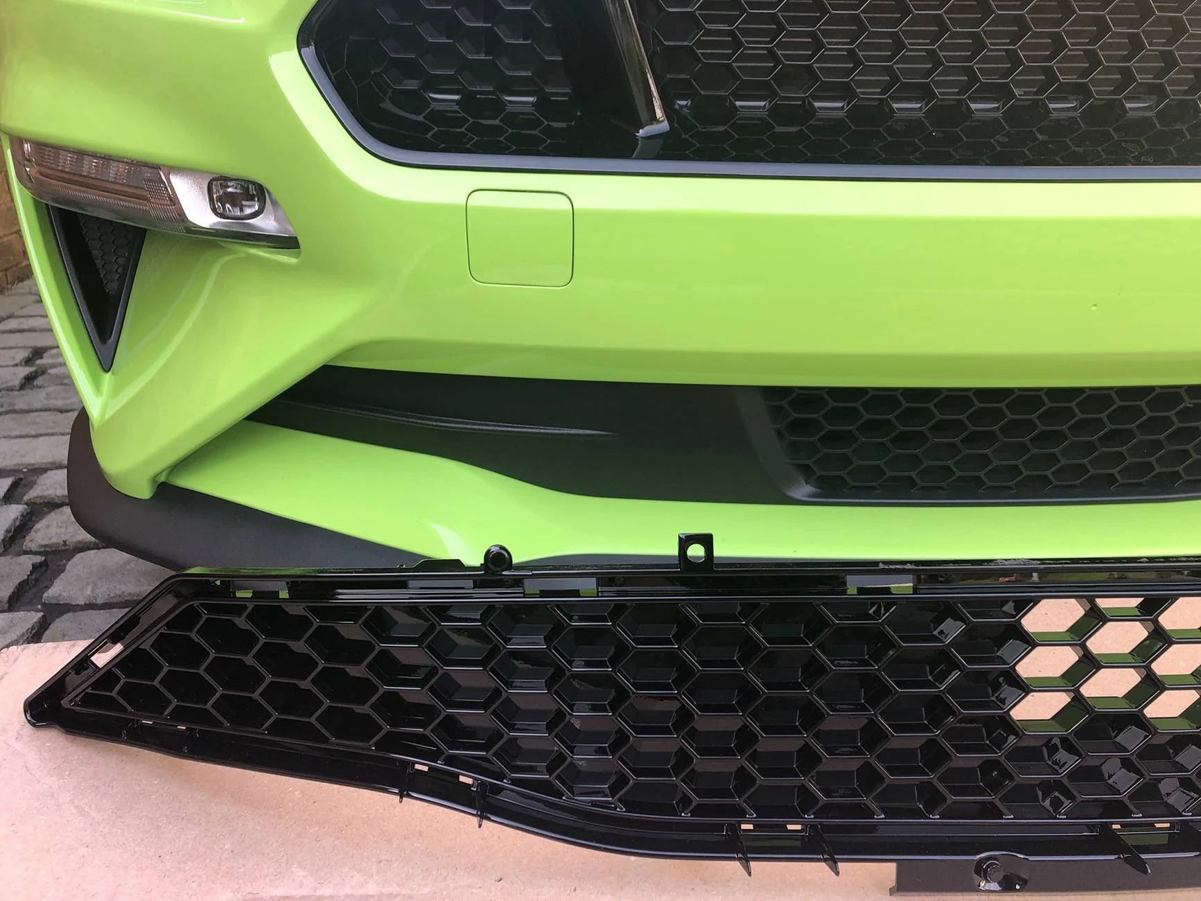

Finally …
It came in a huge box …

I'm curious to see if the ACC causes any problems, because this are the deep combs.
6,824
13,680
Yeah after the mixed reviews on that issue, I'm interested in that too :like:

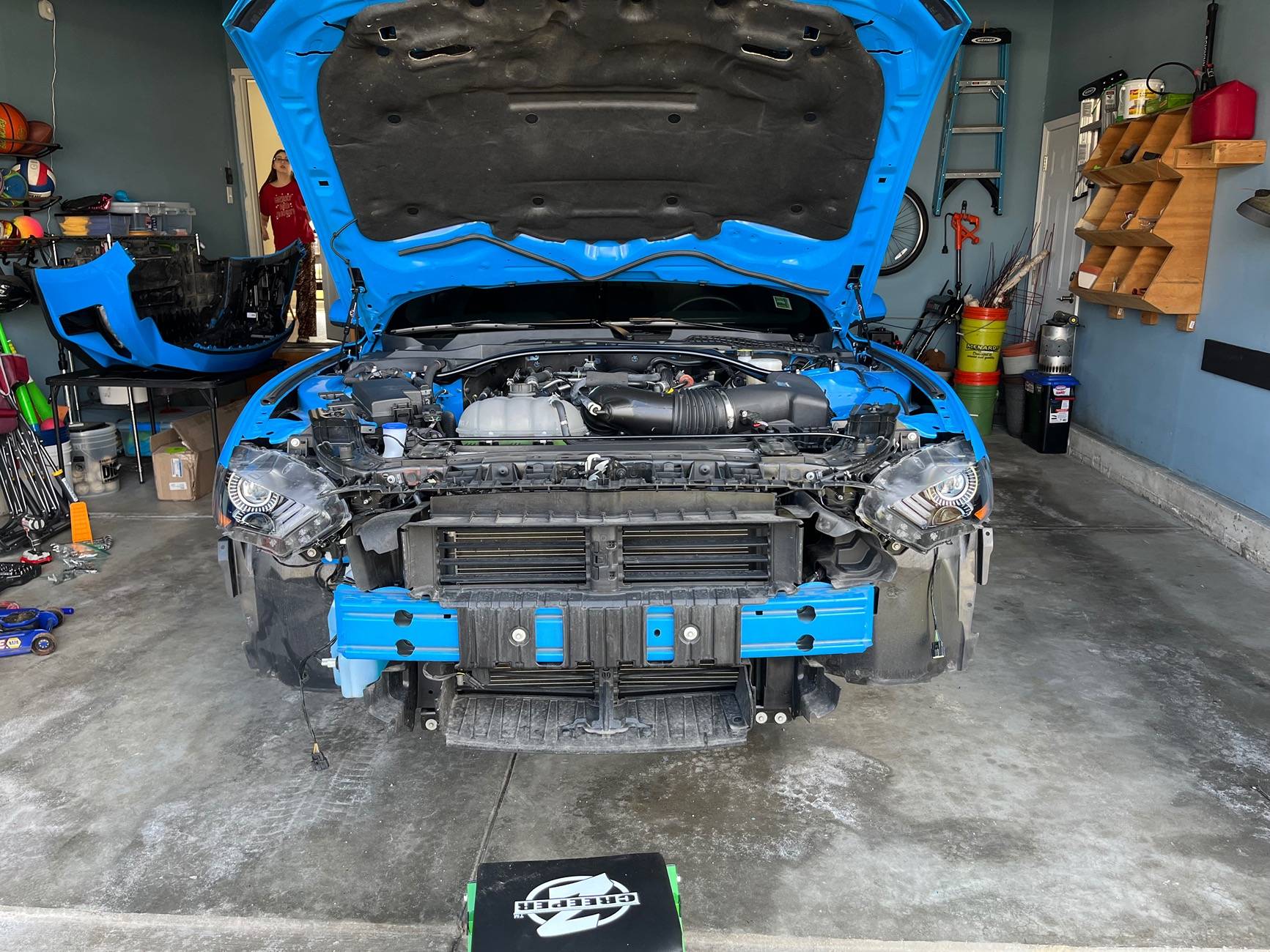

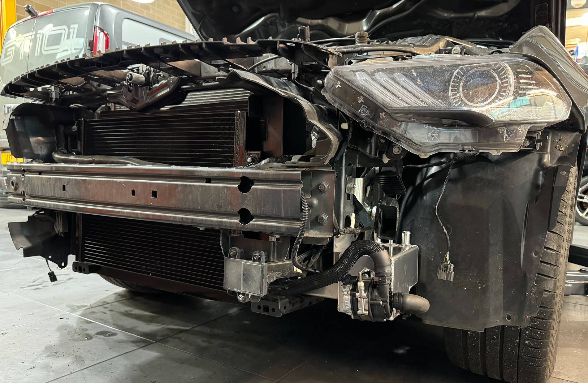

If it doesn't work or causes me intermittent problems, I had wondered about a fix that would keep the look of the deeper grill, but also the ACC functionality of the shallow grill.
Not that I would be happy about taking the front off again, but I would plan on reducing the depth of the grill from the back, just in a patch immediately in front of the radar box i.e. similar to what I did to the inlet area of the main grill :
With where the radar box sits and the size of it, I don't think that would even be noticeable (unless kneeling down looking for it) :
I would just need to consider waterproofing of the radar box and its connection (if not already well sealed) and the potential for air to escape.
