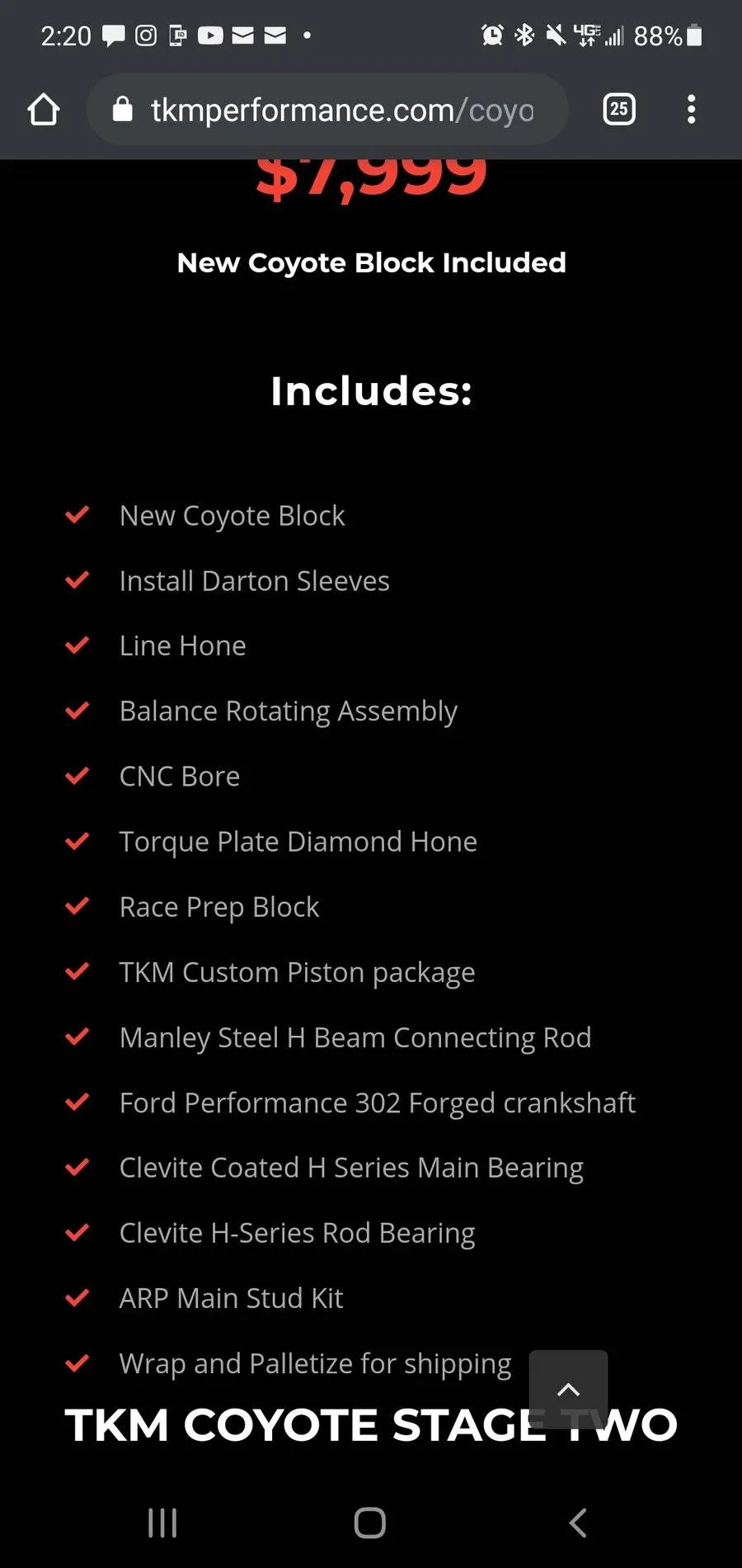

Not a bad price. Is $6800 what comes with your package? Rods and pistions? Etc etc
11.1 or 10.1 or 9.5.1 compression. Not sure what compression I want to go with. What compression would you recommend?E85 is hard to find here so I'll be on 93 until I'm ready to race... then I'll throw in some E85 in the tank
I would not go lower then stock compression.
I was thinking maybe 10:1. I'll have to run more boost but less room for error or leave it at 11:1 I don't want to run 12 tho. Aluminator blocks and the new gt500 have lower compression then the gen 2 and gen 3 motors. I don't trust 93 so I'll probably have it tuned to where the car won't rev past 5000 on 93 and when tuned for E... rev it to 7500
I think you are overthinking this.
go with 11.1 because it’s been proven to be a great combo with or without boost. 93 will do just fine as long as you aren’t over 700whp. If you ever remove boost from the car it will be a horrible turd with low compression. The key is less boost and more power. That keeps things working easier. These engines are incredibly efficient compared to the 60s and 70s where you wanted lower Comp with boost.
