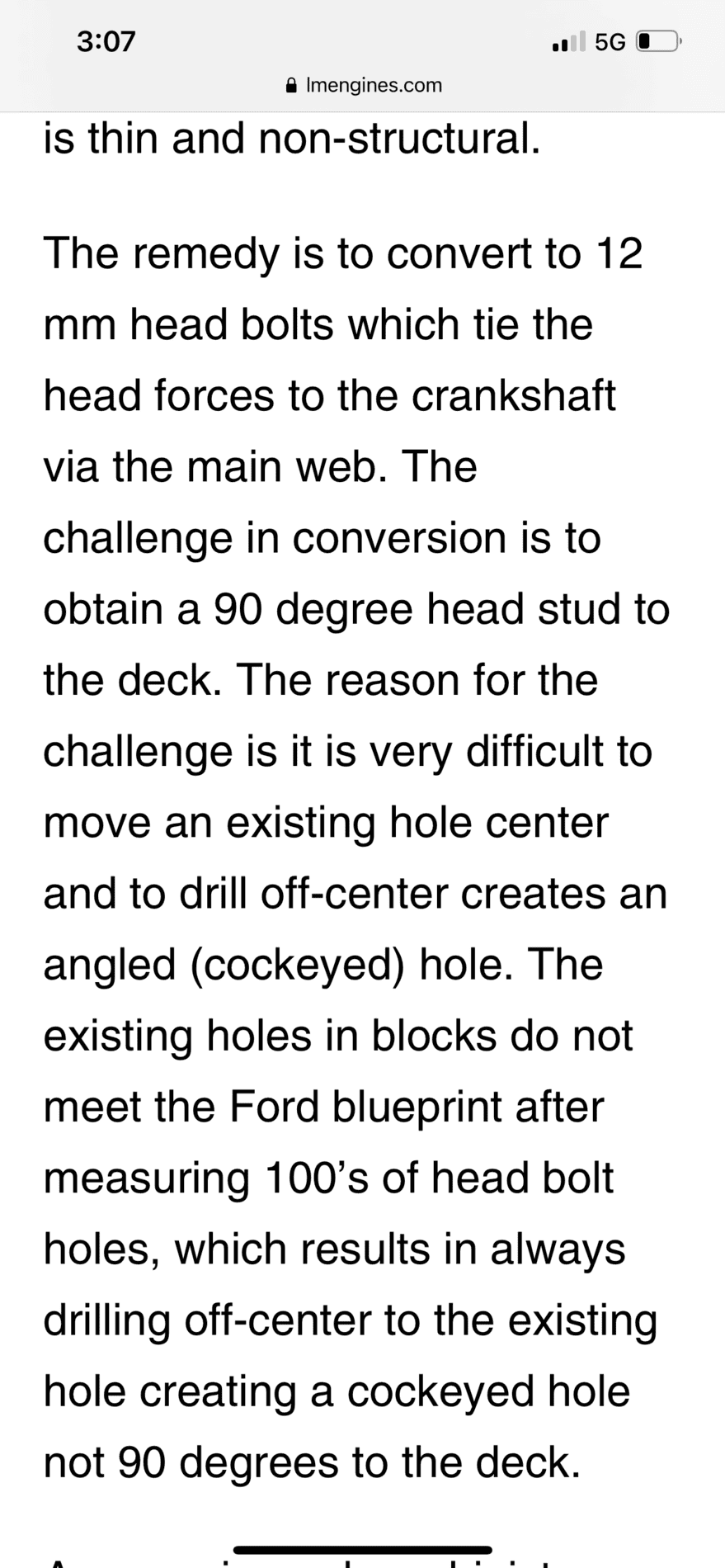

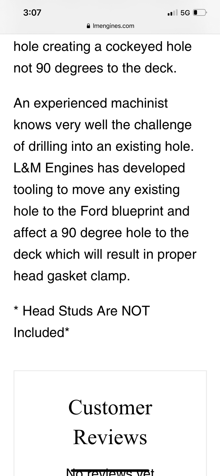

Because Ford casted in a cylinder support. The same support that gen1 and gen2 need added the gen3 comes with
Gen 3 coyote also have the longer (than Gen 1 voodoo) 12 mm head bolts (like the predator and later voodoo blocks )
11-12 Gen 1 coyote blocks used them too then they switched to the 11 mm In the later Gen 1 and Gen 2 coyote
The longer bolts help with the cracking that occurs around the knock sensor bosses that is also common - happened to me with a non sleeved Gen 2 coyote block with the sleeve supports that was loosing coolant . That’s where the block cracked .

Yes but that is a easy fix. The problem with the gen3 is that the cylinder coating can flake off and tear up cylinder and the block. I would probably go with the gen2 with cylinder supports and 12mm head studs if I’m not going to be sleeving it
