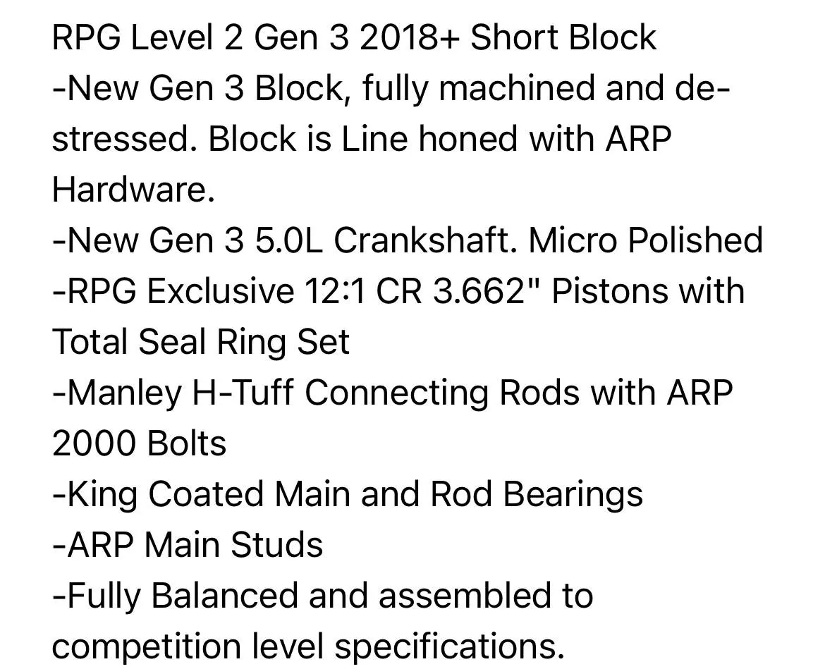

this what I got from RPG, without sleeves. RPG said it can handle 22-24 PSI, I made 980 to the wheel on about 17 PSI revving out to 5500 RPM before charge pipe blew off. so 1000 wheel is capable for sure and will still be safe for another 4-6 lbs of boost
