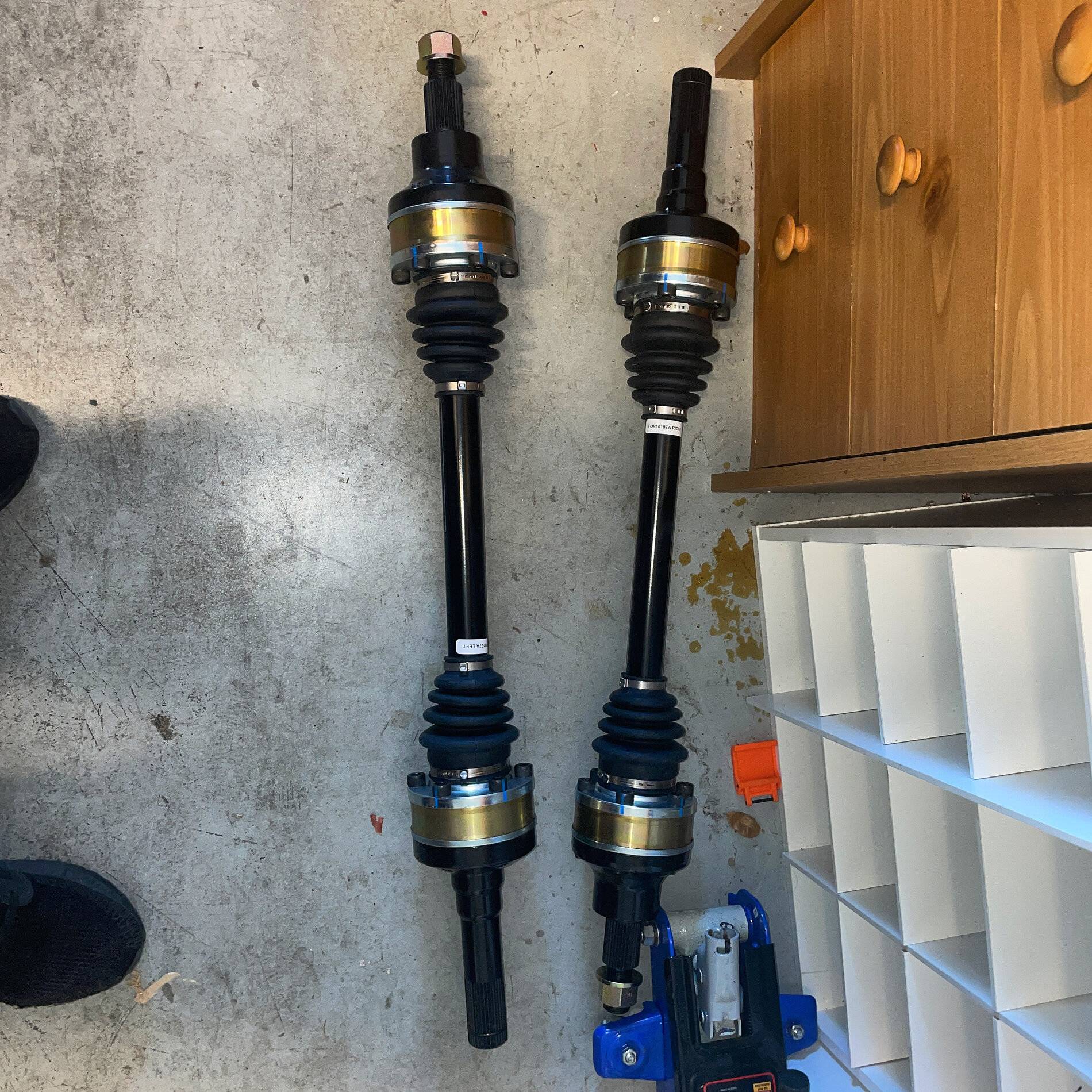

But I did opt for Gforce renegades while the dss are being rebuilt. Installed and car is doing great. Interesting not having a first gear though.
