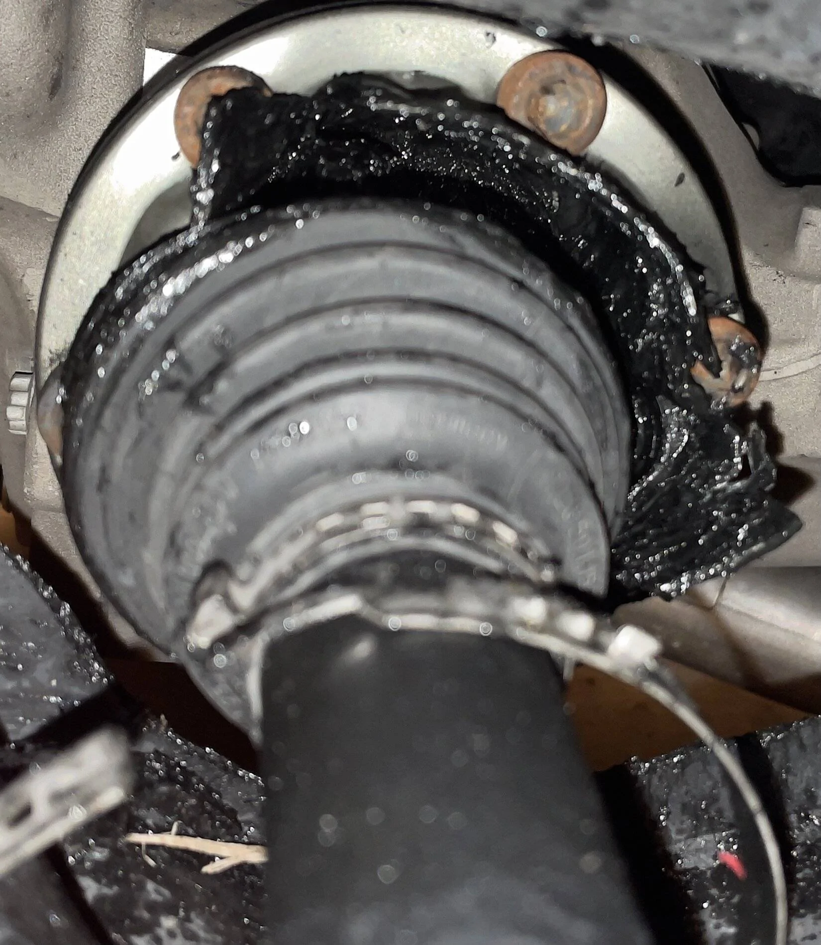

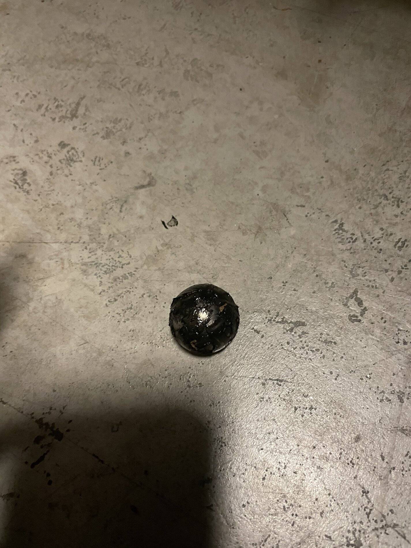

Not sure if anyone else finds this interesting but my second pass at the track I broke a half shaft.
Ordered a new one but will see what dss says.
They have been in the car since July 2018.

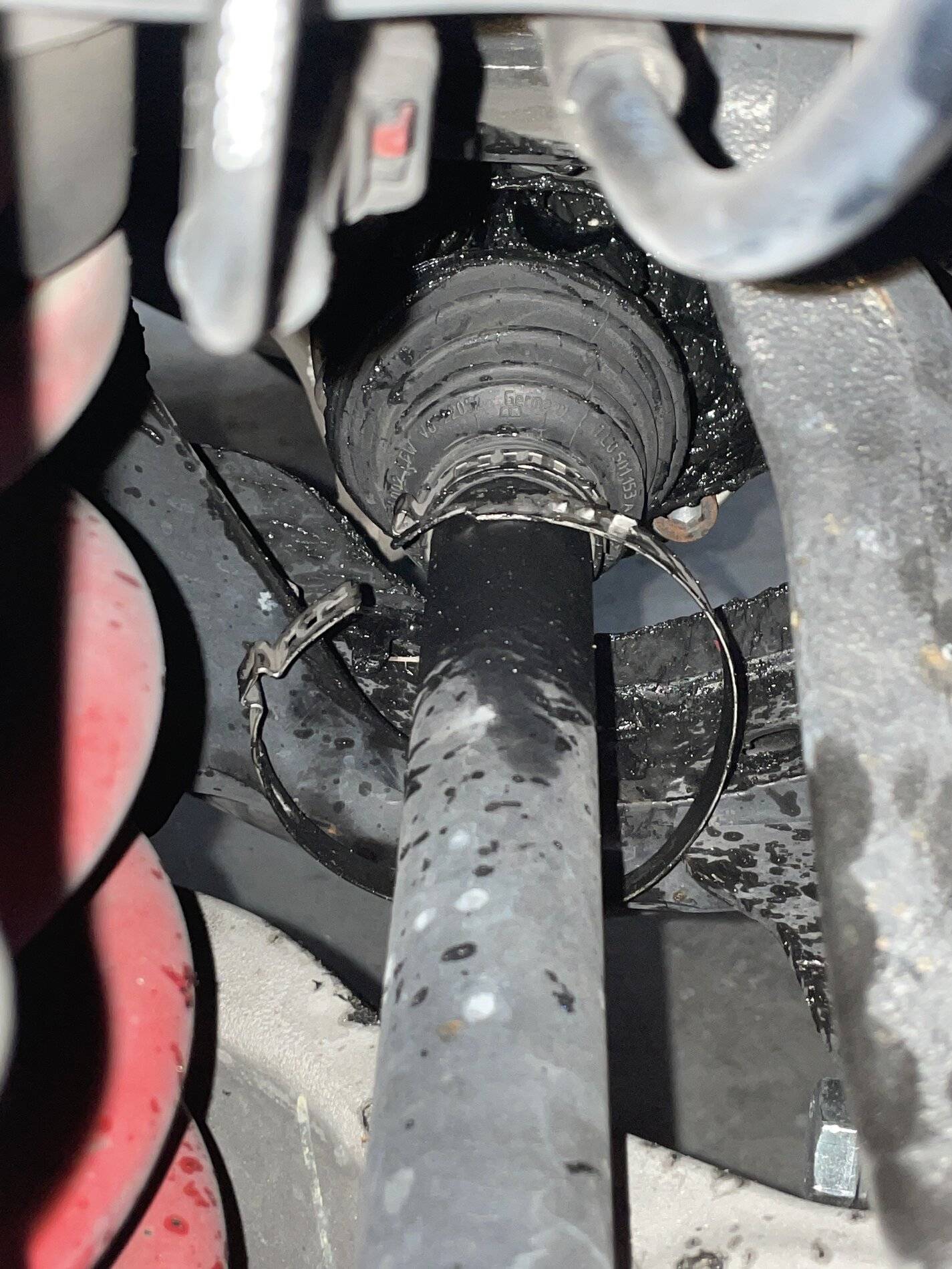

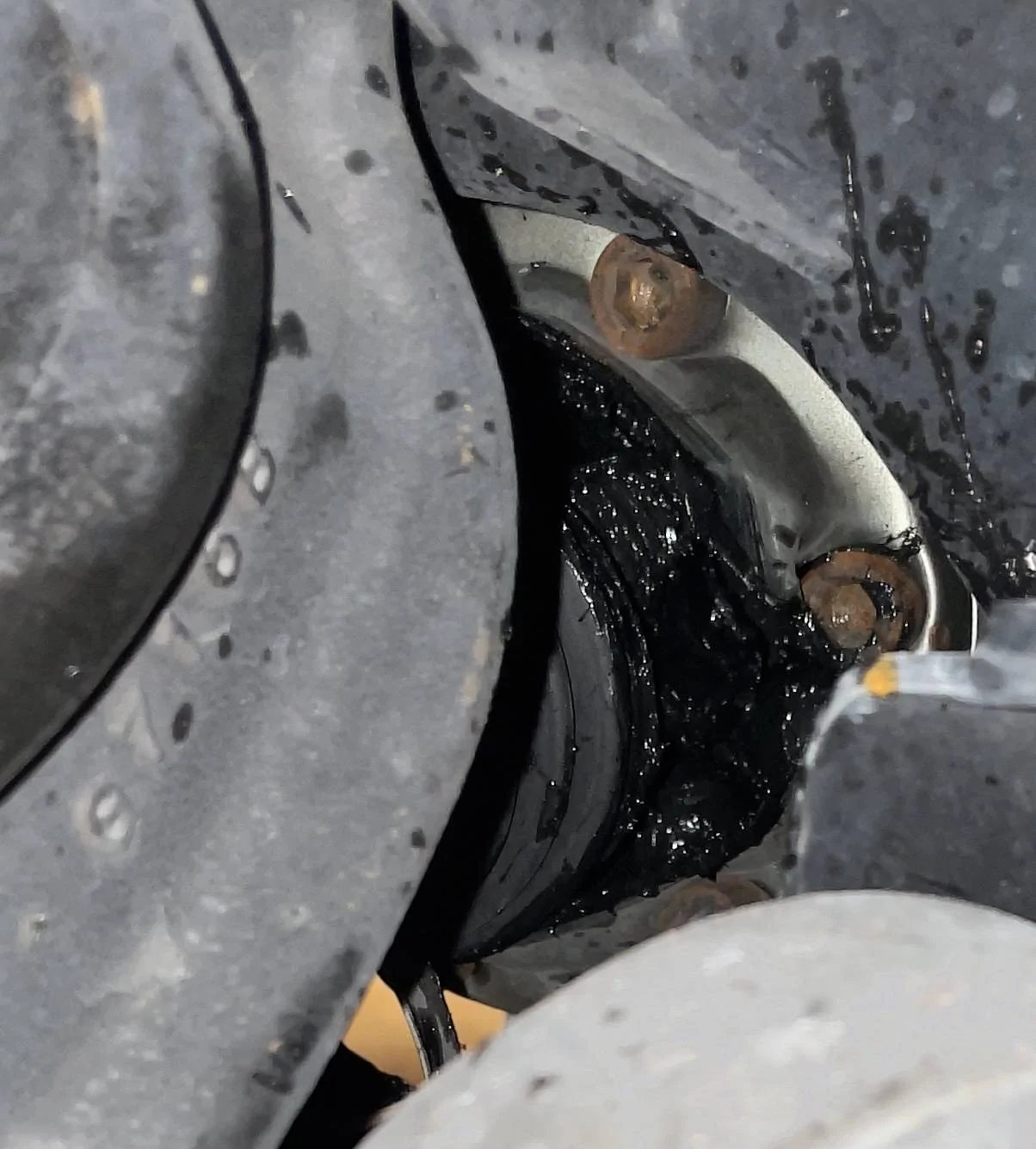

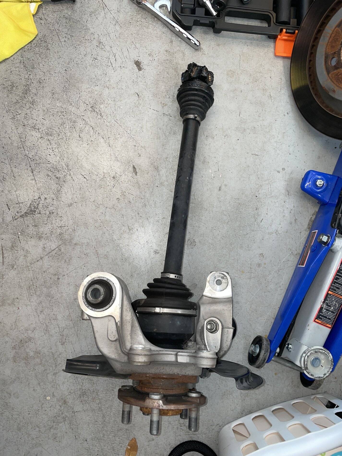

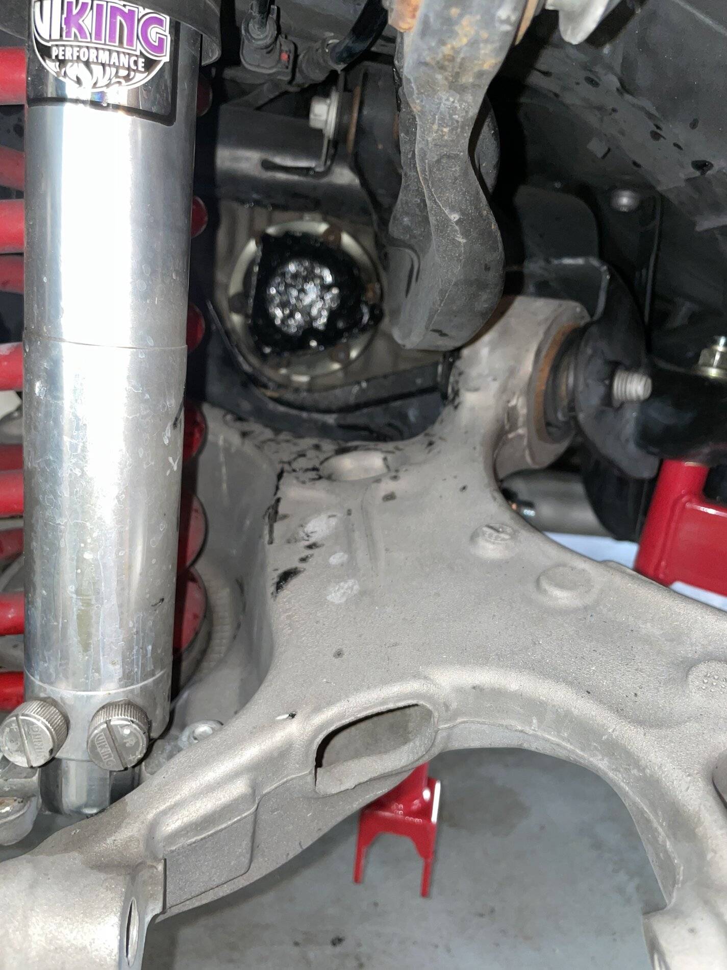

Also this wasn’t loose bolts. This was a joint busting.
You can see the front and rear are bolted in fine. the joint housing is half destroyed. It couldn’t handle the first to second shift.
I’ll start learning leave on second !
