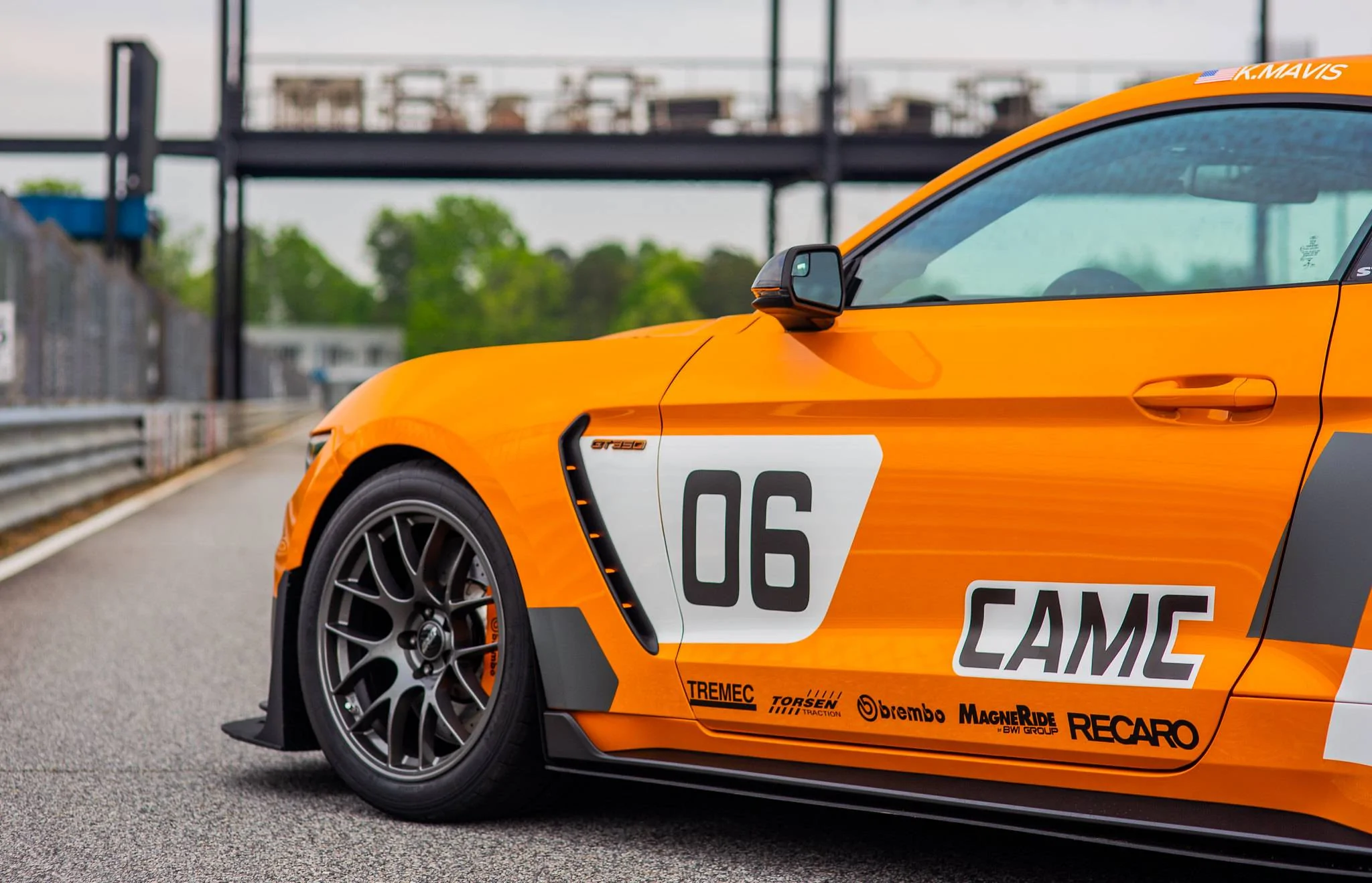

The red are nice but it wouldn't go with my paint color: Cyber Orange
Agreed. Orange is the only option that makes sense although I had considered lime green and some line green matching accents at one point.
