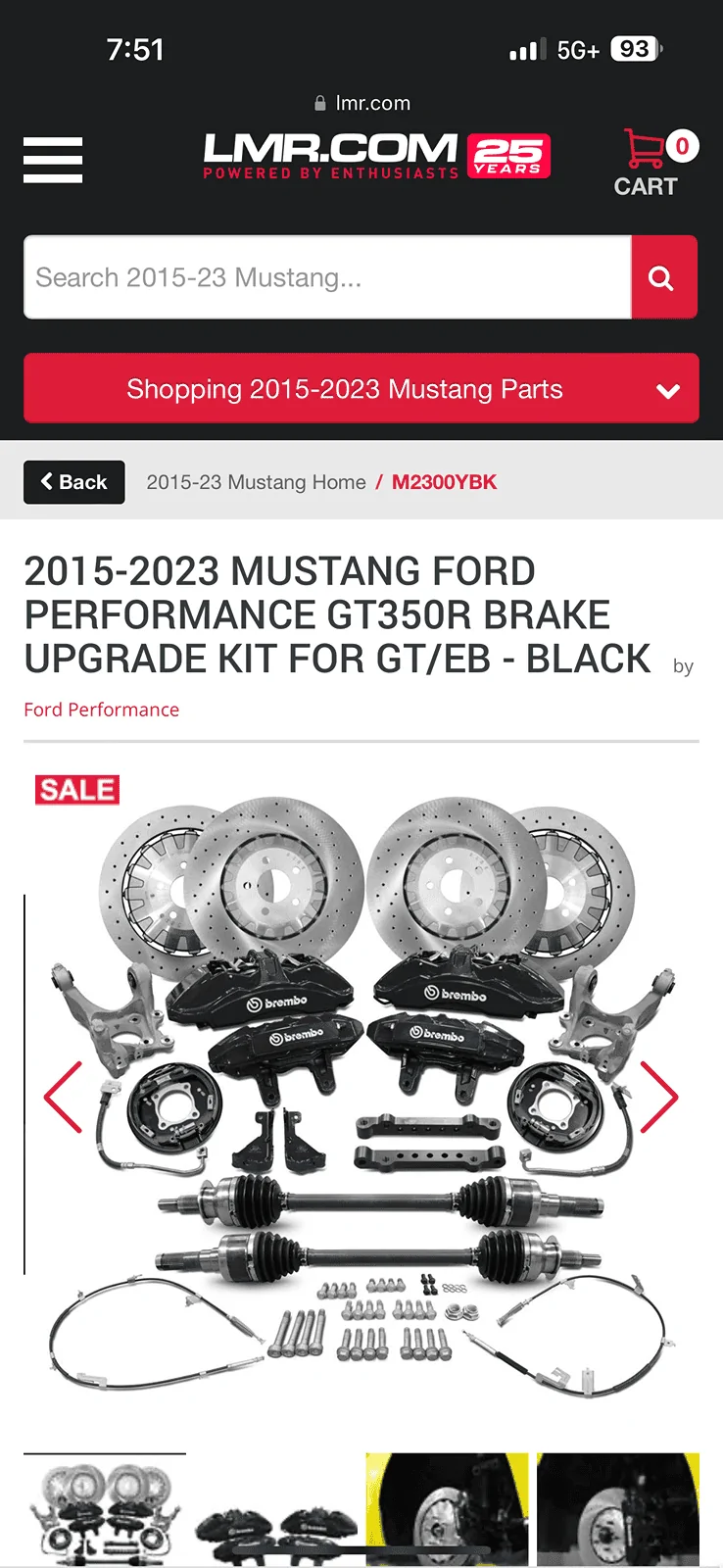

Has anyone installed these on their car & if so what are your thoughts? (they are on sale for $3700)
This is an awesome kit, will be upgrading mine as well. You'll need GT350 fit wheels for the rear.

My car has the Handling Pack but it should work, I watch the video of them putting the break set on a regular GT
What size rotors are standard in the rear of the Mach 1? Are you currently running wheels that are compatible with the offsets used on the GT350?
Note in the kit:
  • Due to the increase in rear track width, you must run the 19x10 +35mm (Normal Offset) R350 wheel in the front and the 19x11 +60mm (GT350 Offset) wheel in the rear.

The brake rotor is 13 inches
