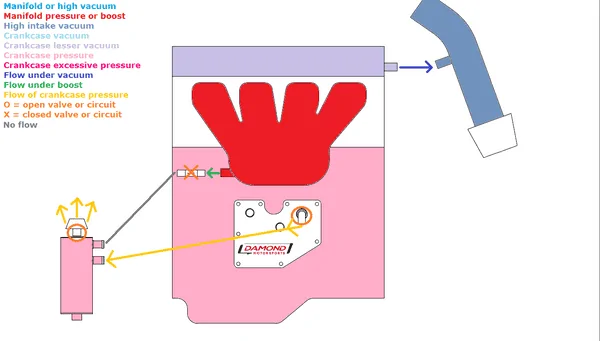

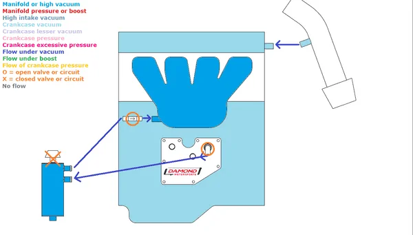

I was going to mickey mouse my own OCC together using this
https://damondmotorsports.com/colle...rsal-oil-catch-can-kit?variant=39408881369130
and https://damondmotorsports.com/collections/oil-catch-can/products/check-valve?variant=1919243524
Under vacuum, the PCV works like normal but with a catch can. Under boost the driver side can vent to the intake tube and passenger side can vent to atmosphere if it needs to. The check valve stops boost from the mani/tb from entering the can.
Basically a hybrid of Steve's closed system and the full open breather. Oh, and you can mount it wherever you want and run a drain line off the petcock.

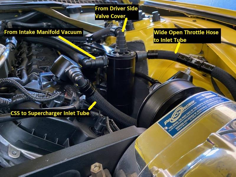

If you look at the dual valve catch can kit, and some of the single valve kits, you will see we have a CSS. The Clean Side Separator is a small separator that connects to the driver side valve cover, and has a hose connecting it to the air intake tube.
If you have vacuum applied to the crankcase (via the intake manifold vacuum port to catch can to PCV connection) then you should have a method for fresh air, or clean make up air to enter the crankcase. The CSS allows fresh air from the air box to enter the crankcase during part throttle driving, and will trap the small amount of oil splash that could escape when under boost or hard driving.

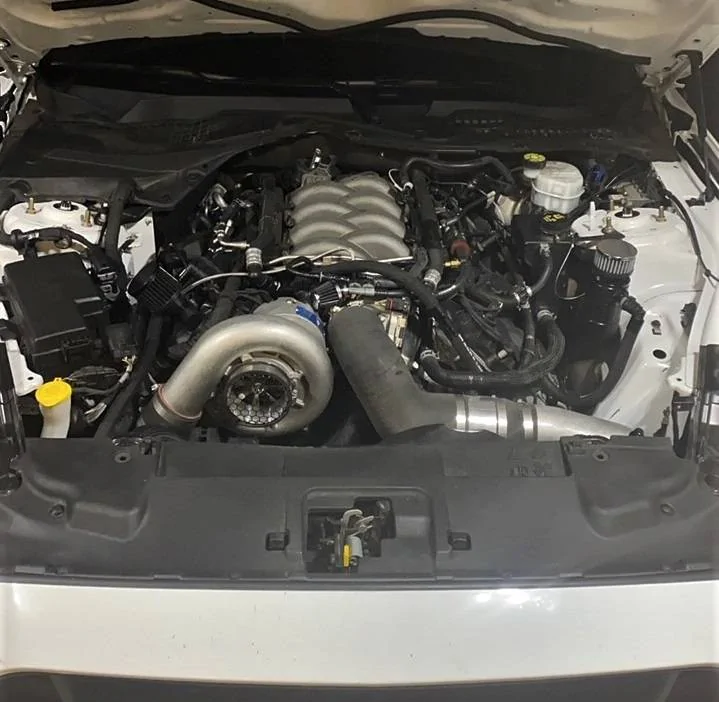

Completely agree. My breathers remain very clean for long periods of time.
