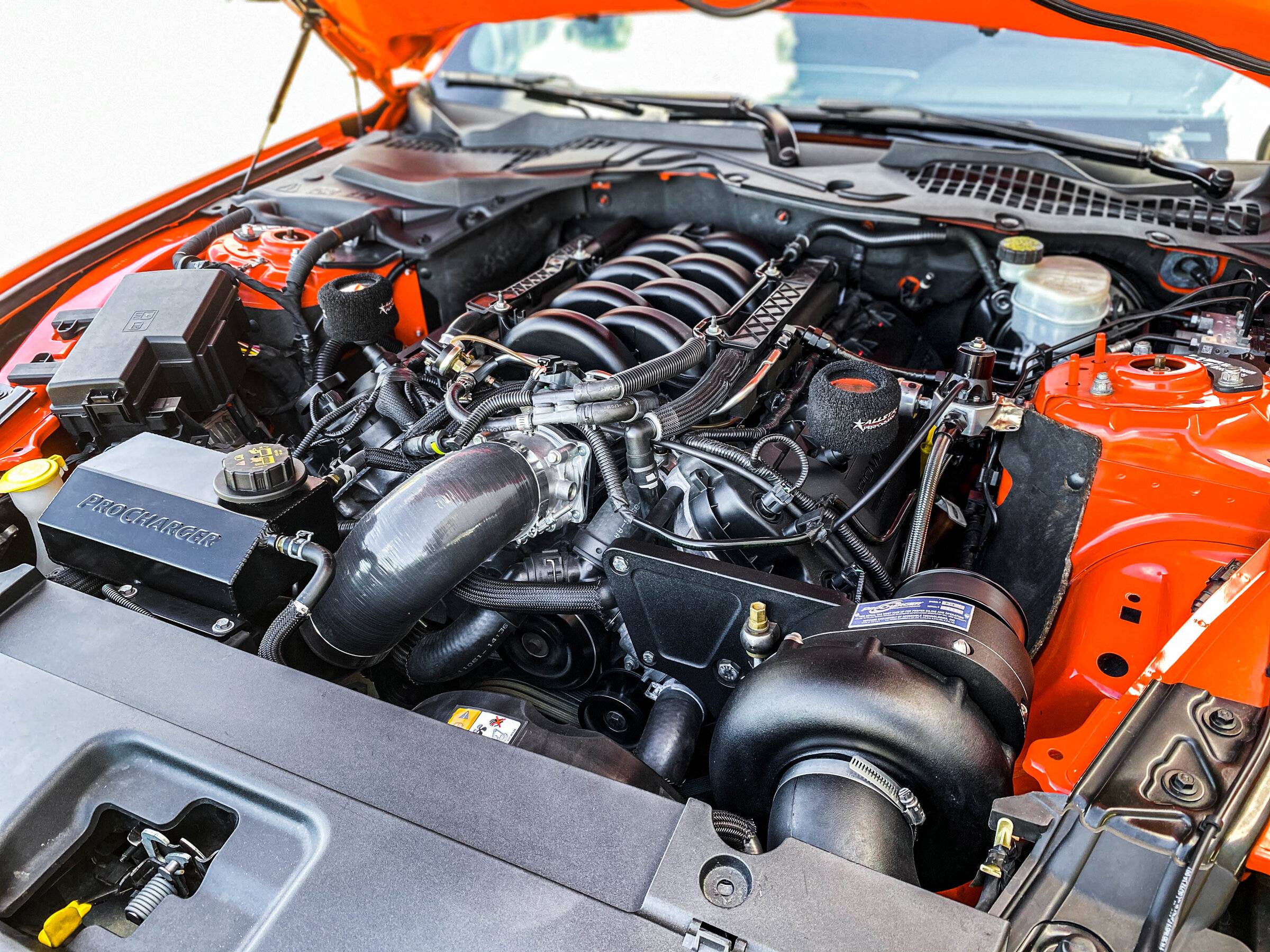

I simply run breathers in my setup.

They are disposable for most part. Most auto parts stores carry them. I am running k&n right now.

-I have no idea. I don't track the car. I am running a 4" pulley on a D1x, seeing about 17-18lbs of boost which is a arbitrary number anyway. If I were to guess, I bet I am 850hp+ mark.

I love the vent setup as there is no chance of oil flowing into your intake charge. Not that it has happened to me yet, but when the breathers get a bit saturated, simply replace them. Easy.
