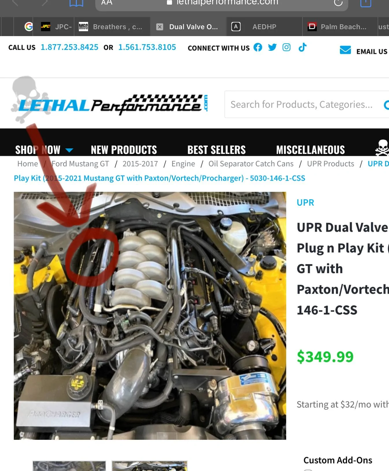

Am I right in this?
So 1 line from each Valve cover to the can
1 line from inlet tube-pre supercharger (P1x in my case)
Then 1 line to manifold vacumn
So it has a one way check valve in the “clean” line?
Is it this? Cant quite tell?
So it says it works, not at idle but under boost the check valve opens? What psi does it open?

I would hold out and get the one specifically made for the procharger. But yes, one line to the valve cover, one line to the blower for vaccuum, and one to the manifold. The check valve makes it so oil doesn't go back into the PCV and stays in the can.

So is what is circled in pic above the check valve?
Is it worth it to upgrade to the race/bigger valve ?
Yes, that's the check valve and we always recommend the UPR Pro-Series check valves on any application as they Flow twice as much air/vacuum delivering better idle, mpg, and throttle response.
These are what we recommend on any application looking for overall improved performance.
The biggest thing to remember when you're in the market for a catch can is not to get stuck with a catch can that uses generic rubber hoses and plastic fittings screwed into the catch can. UPR only uses the highest grade aluminum anodized parts and all stainless steel
Hope this helps, Joe@UPR
