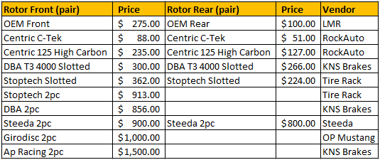

I am looking into getting a dedicated set of rotors for the track to go along with dedicated track pads. I'm curious what other people use for HPDE/track use and their experiences, whether good or bad.
I've compiled a list (not all the options but the more common ones) of possible options, their respective prices, and what website I found the info on. The prices are all for the pair, not single rotors. Additionally, the fronts are all for the 15" PP-size rotors.
Now we all know the Steeda, Girodisc, and AP Racing ones are amazing. Not arguing that. But for someone like me who is nowhere near the limit of the car and simply getting practice in HPDE, I see no use for the crazy 2pc rotors. I'm looking for cheap (but still durable/reliable) that will last me a decent amount of time. I know Terry Fair used Centric blanks on his 2018 test car before upgrading the entire calipers.
