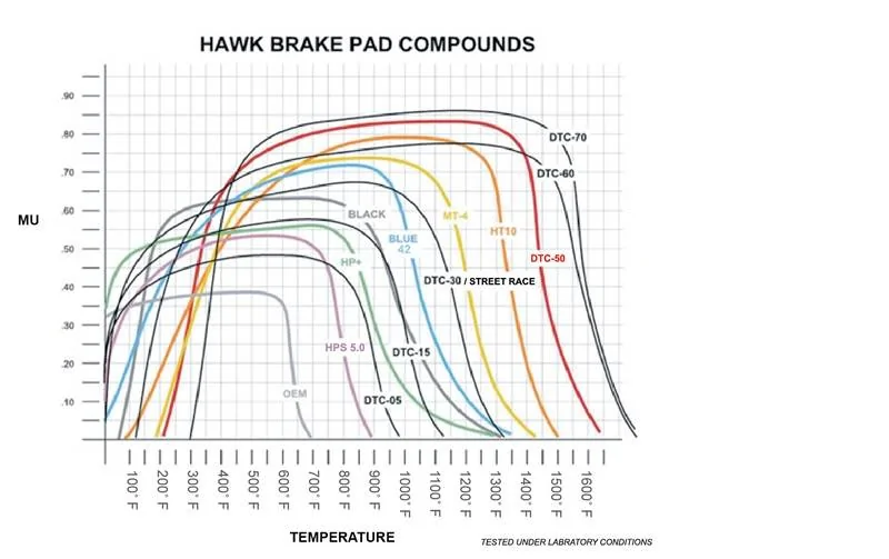

HP+ is a pretty marginal pad for track duty (especially up front). Starts falling off by 800°F and is all done before hitting 1000°F. This is friction surface 'skin' temperature (where the melting/smearing happens), which runs hotter than bulk mean pad temperature.
do you have the original URL? I'm curious what HP is referring to as the 'OEM' pad or they are just picking a representative street pad example from who knows where...

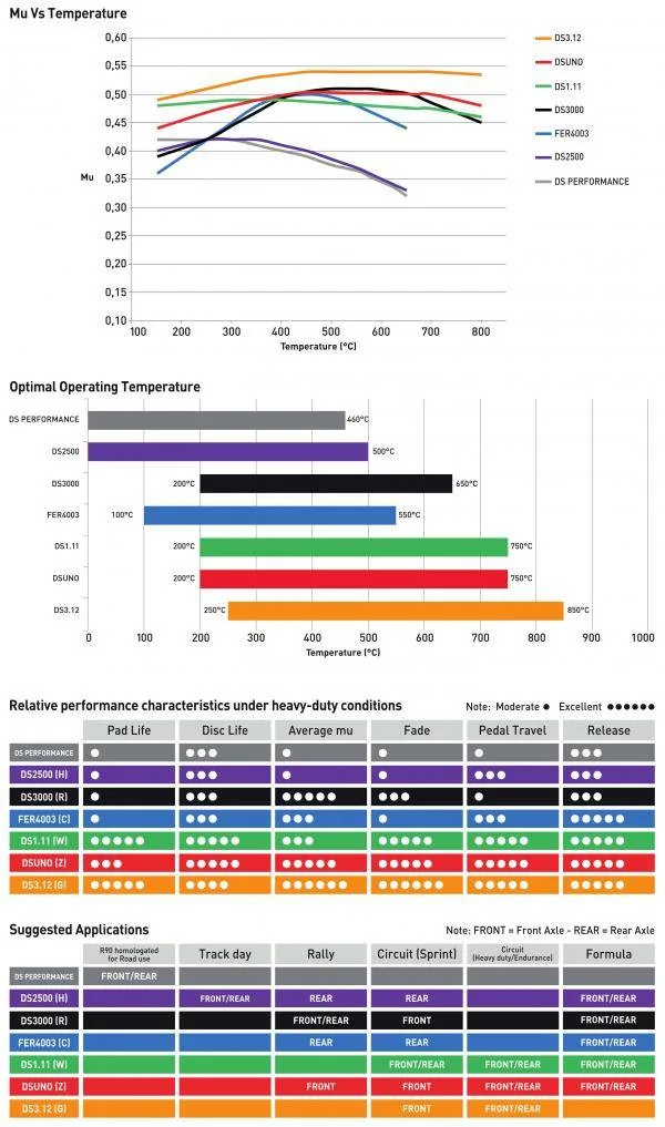

That one's been around a while, so I don't know. But here's some mu vs temperature curves for Ferodo pads (note that temperatures are given in °C (which you'd multiply by 1.8 to get a close approximation of the °F temperatures). Aren't the PP level pads DS2500 or comparable? If so, what Hawk shows for OEM is at least representative of 'base'.
