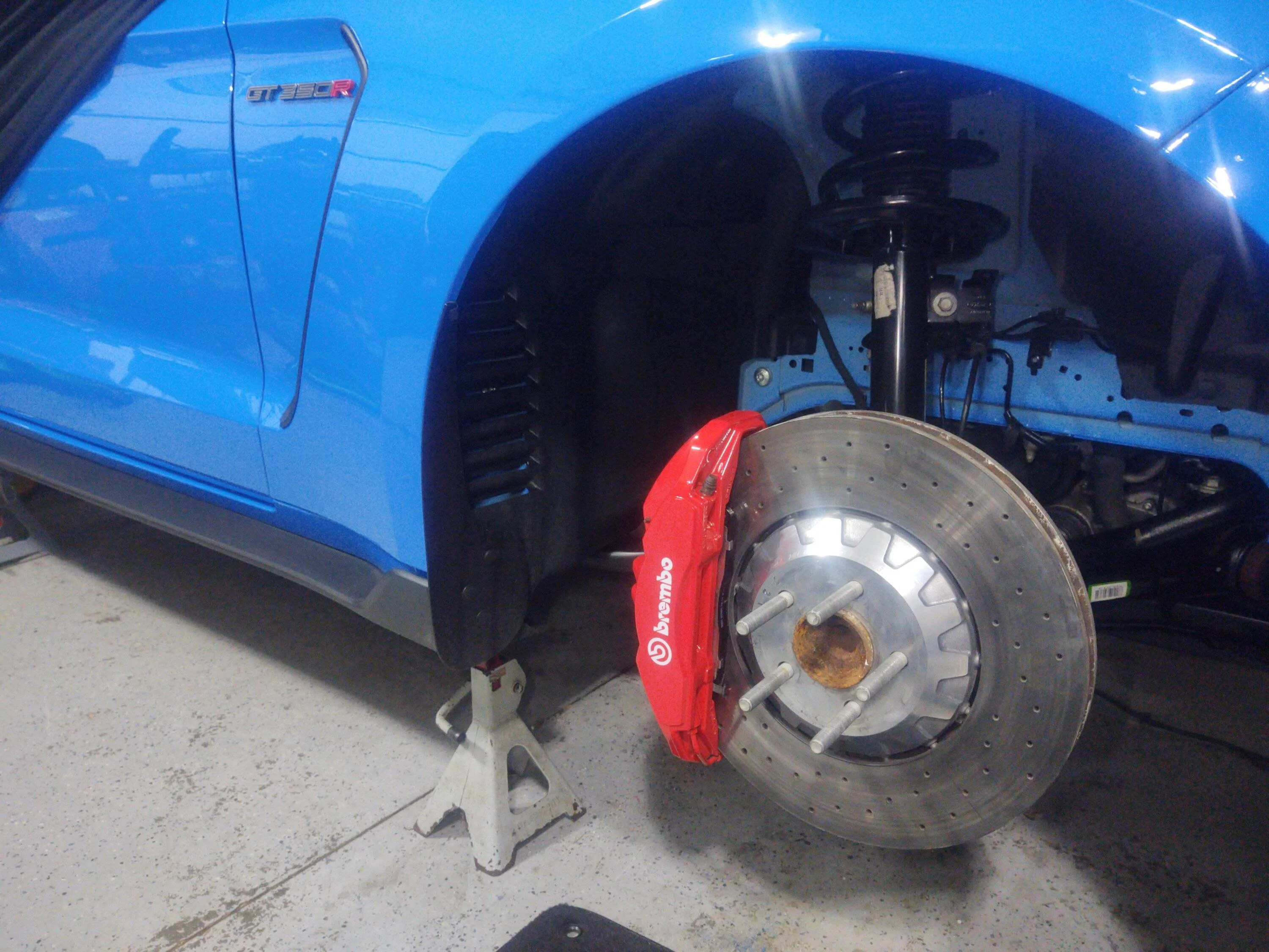

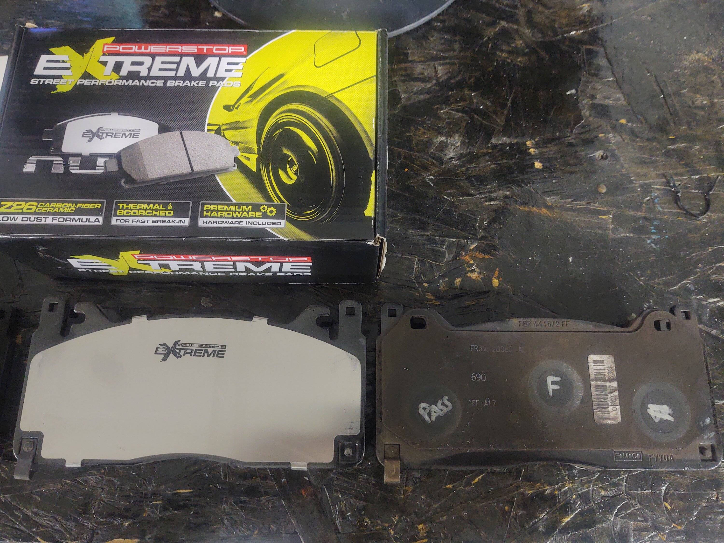

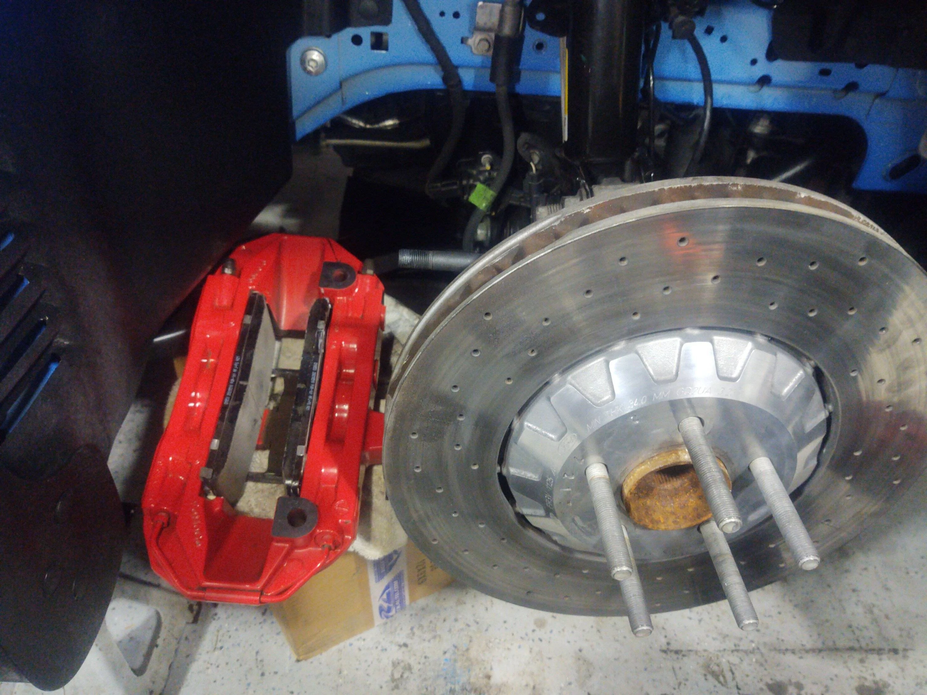

Finally installed my front Caliperfexion kit I had purchased last year. My Powerstop Z26 Performance brake pads showed up today from American Muscle (cheapest price I found by far w/ free 2 day shipping).
I used some online forums for Caliperfexion installation advice but this video from Auto Fanatic was a great reference tool. Kudos to him for a sharing many videos on the GT350 platform.
Here is the Auto Fanatic Caliperfexion installation video.

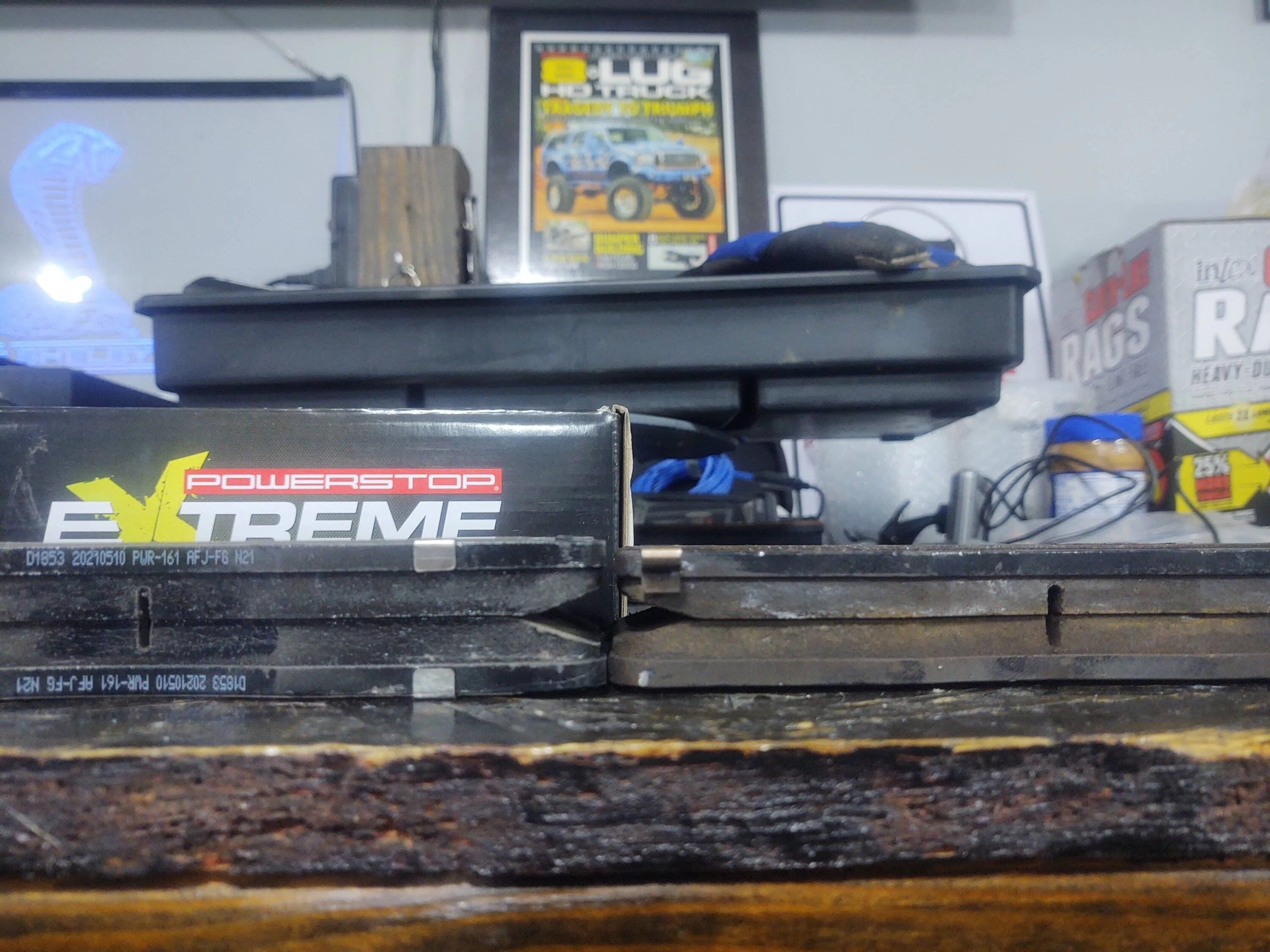

Here you can see I still had a lot left on the OEM Ford pads, hopefully the Powerstop pads cut down on the dust as everyone claims.

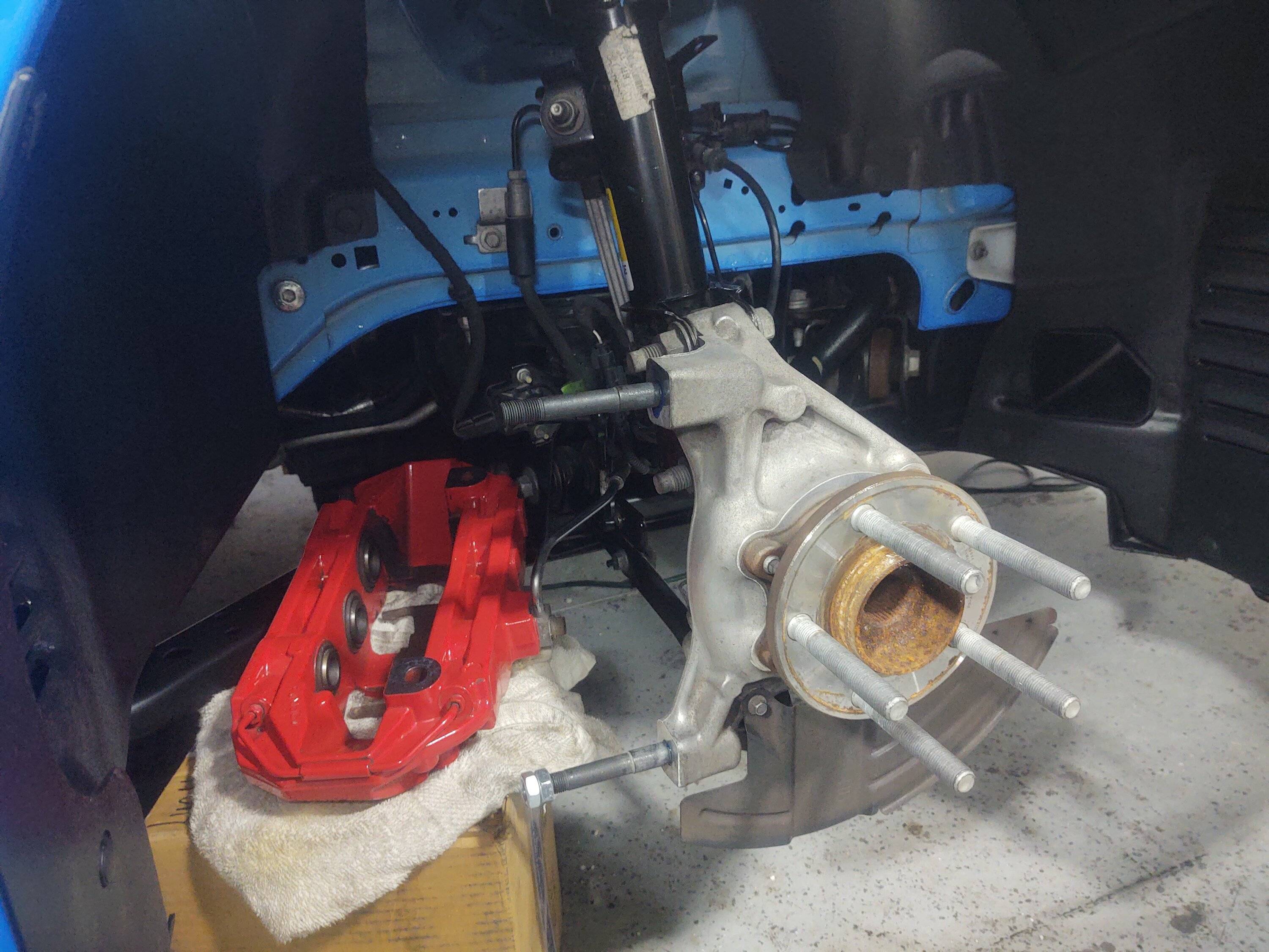

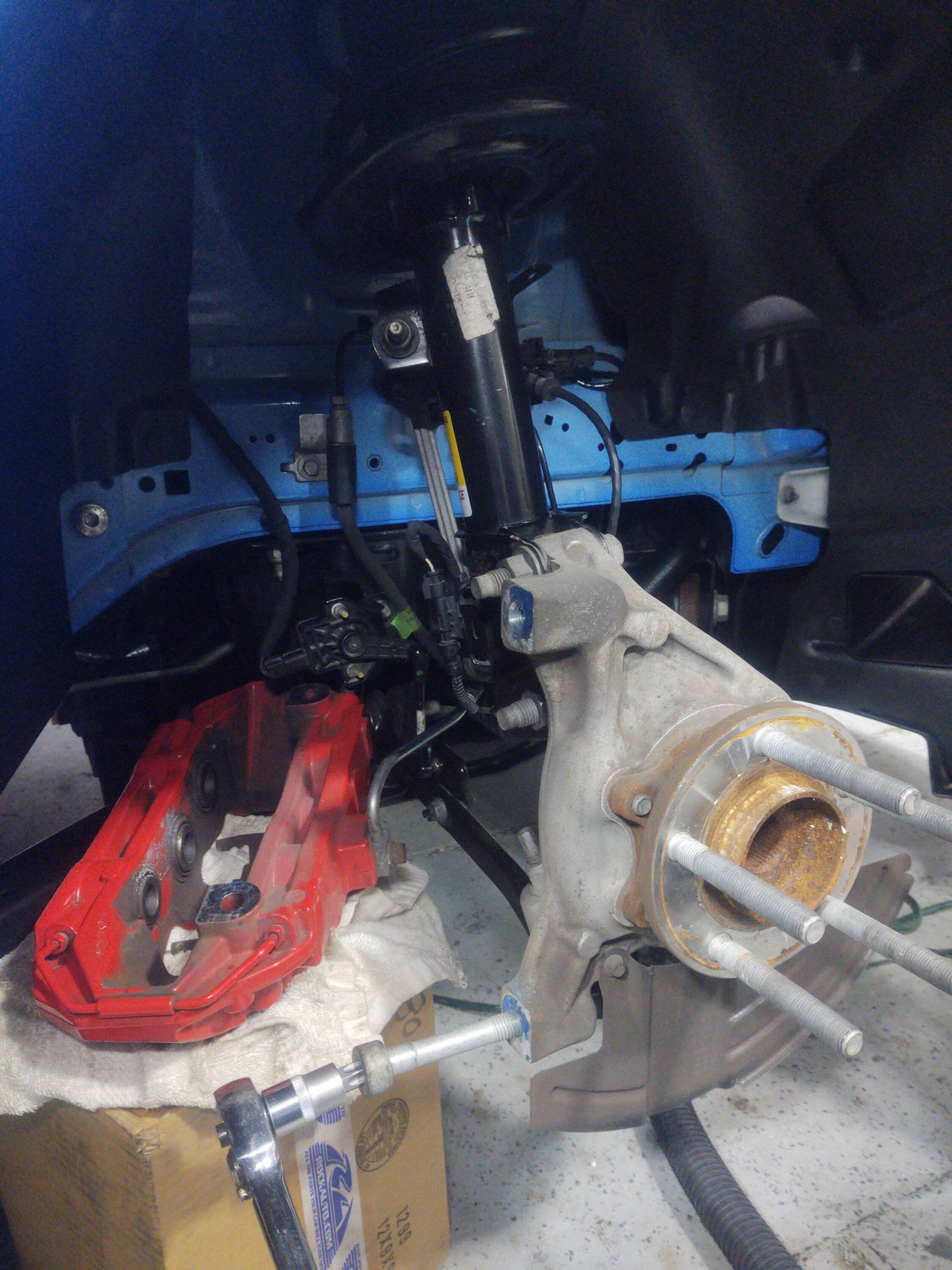

I purchased the hardened steel stud kit because, as Autofanatic on IG and Youtube was quoted stating, the stainless bolts in aluminum knuckle with stainless hardware could pose a problem later on.

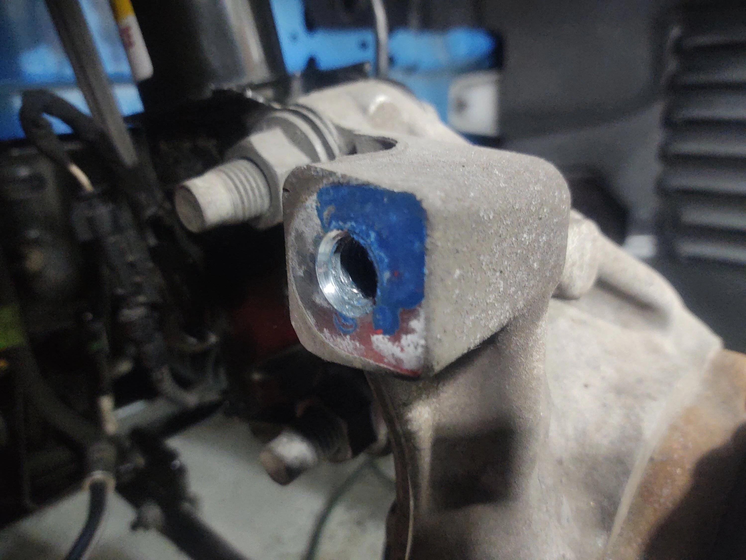

Removing the OEM bolts was definitely some work, that thread locker doesn't allow the bolts to come out easy. Again, Auto Fanatics YouTube video, he used a butane torch to heat up the bolts which loosens up the loctite for easier removal. I didn't have a butane torch and just wrenched on them slowly but surely they come out.
Taking 1 bolt and cutting a straight grove in it, it'll allow you to chase the threads in removing all the old factory loctite. This is a MUST, chase the threads with the cut OEM bolt at least 2 times. This will ensure the new Caliperfexion bolts thread in by hand.
I followed the instructions to a T, along with watching Autofanatics YouTube installation video for reference.

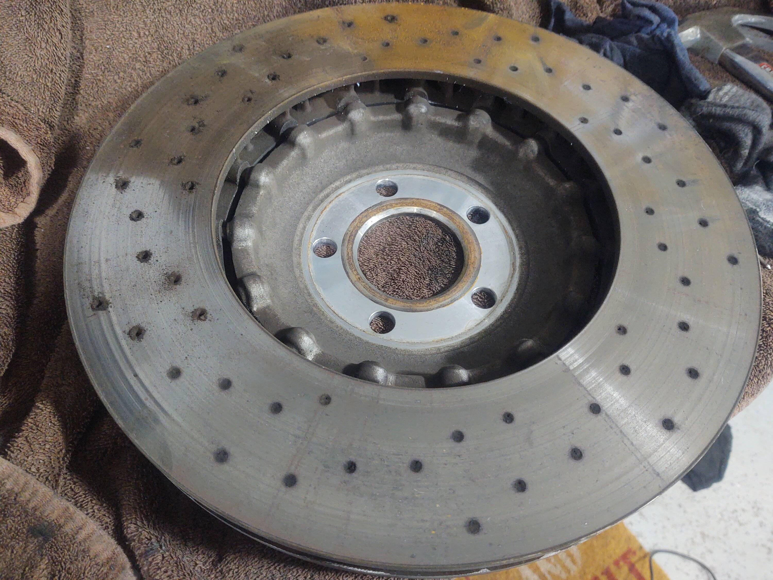

Here I had to remove some build up from the back side cross drilled holes in my front rotors.
I did opt to use the provided ARP assembly lube on my upper stud threads. Doing so, I torqued the nuts down to 90 ft lbs. If you use the dry (non assembly lube) it's 105 ft lbs.
I also have the Caliperfexion screw on extensions for ease of brake pad changes in the future.
