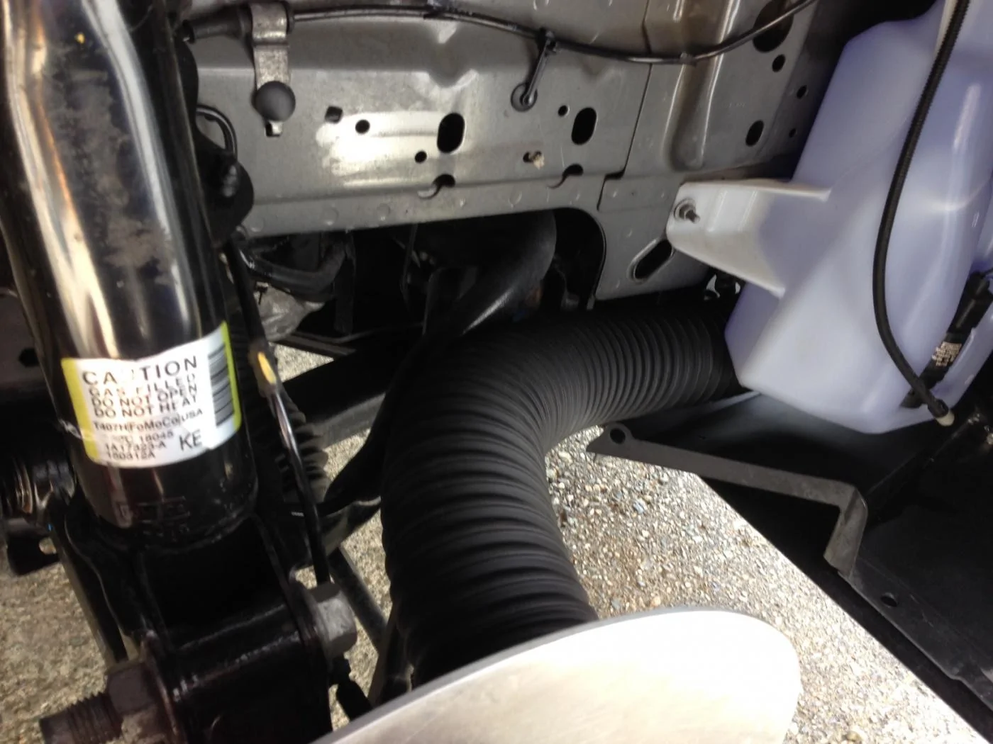

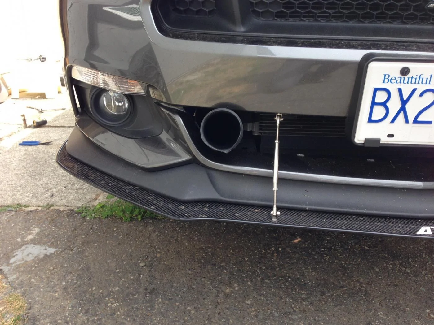

This is where the hose will go, just put it in temporarily. The small part I cut out earlier allows a perfect path for the hose.

It is just a rubber hose with the spiral wire, but fairly heavy duty.
I think the splitter will cause more front end pressure above it so it might help force more air through the ports.

What kind of splitter are you using, got pix?
