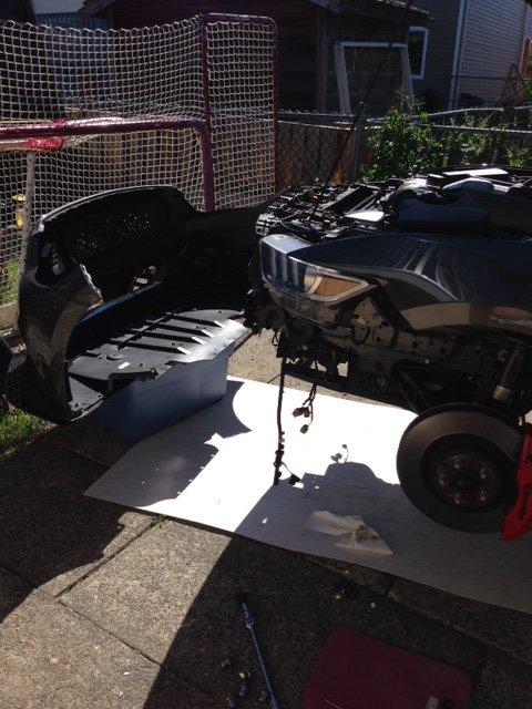

Grill is almost done. I will have the parts home this weekend and finish the install, pics to follow. Didn't turn out quite as good as I hoped, but considering the angles and curves of the factory grill, the apprentice did a great job.

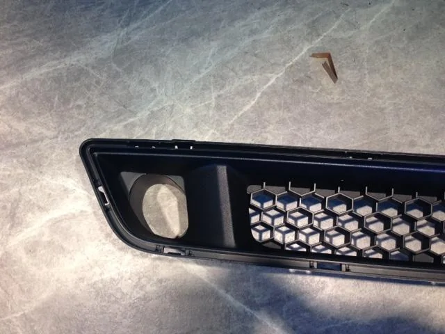

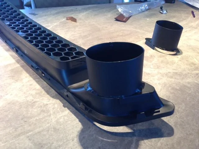

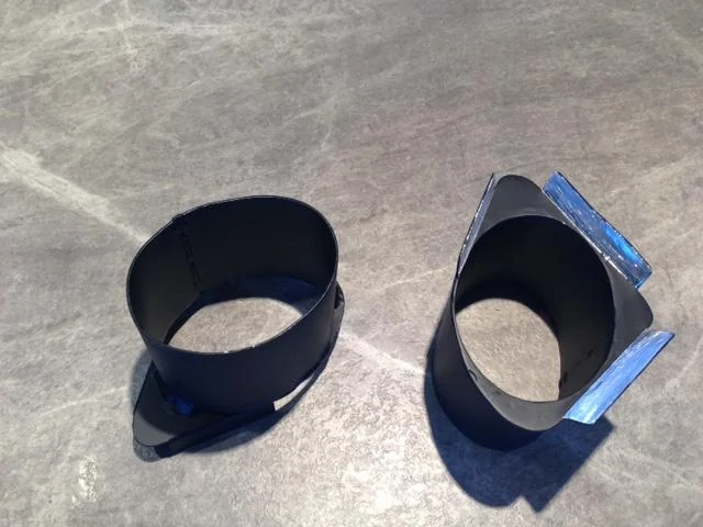

The ducts will be glued to the grill with black Sikaflex. Because of the curves they weren't able to have the duct opening the same size as the grill opening and results in a bit of a flat face as you will see in the pics
Here are the 2 parts
