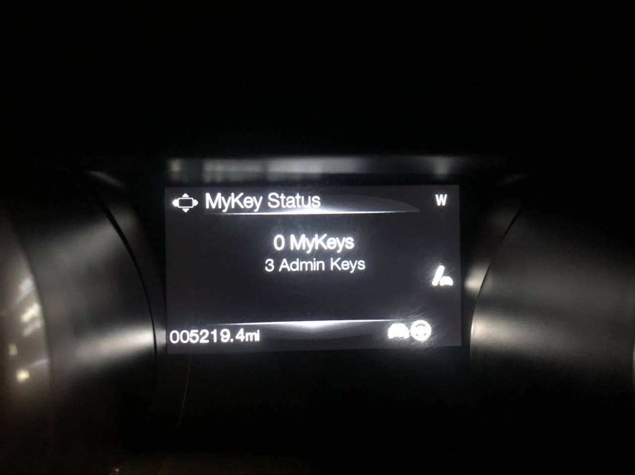

I do have a question. The other day I was scrolling through all the electronic menu such as hill assist, oil life, etc... then i ran into Admin keys and it showed number 3. So i searched through manual, found out more about admin keys and mykeys. I only received 2 keys when I bought this car. That means theres a 3rd key somewhere. That concerns me. Somewhere out there, there is another key that can start this car. Is there a way to delete it? Or reprogram the keys I already have so only the 2 keys I have will work on this car? The manual only talks about programming Mykeys. From why I read, i probably have to go to dealer but if anyones knows how to delete that third, i would appreciate it.

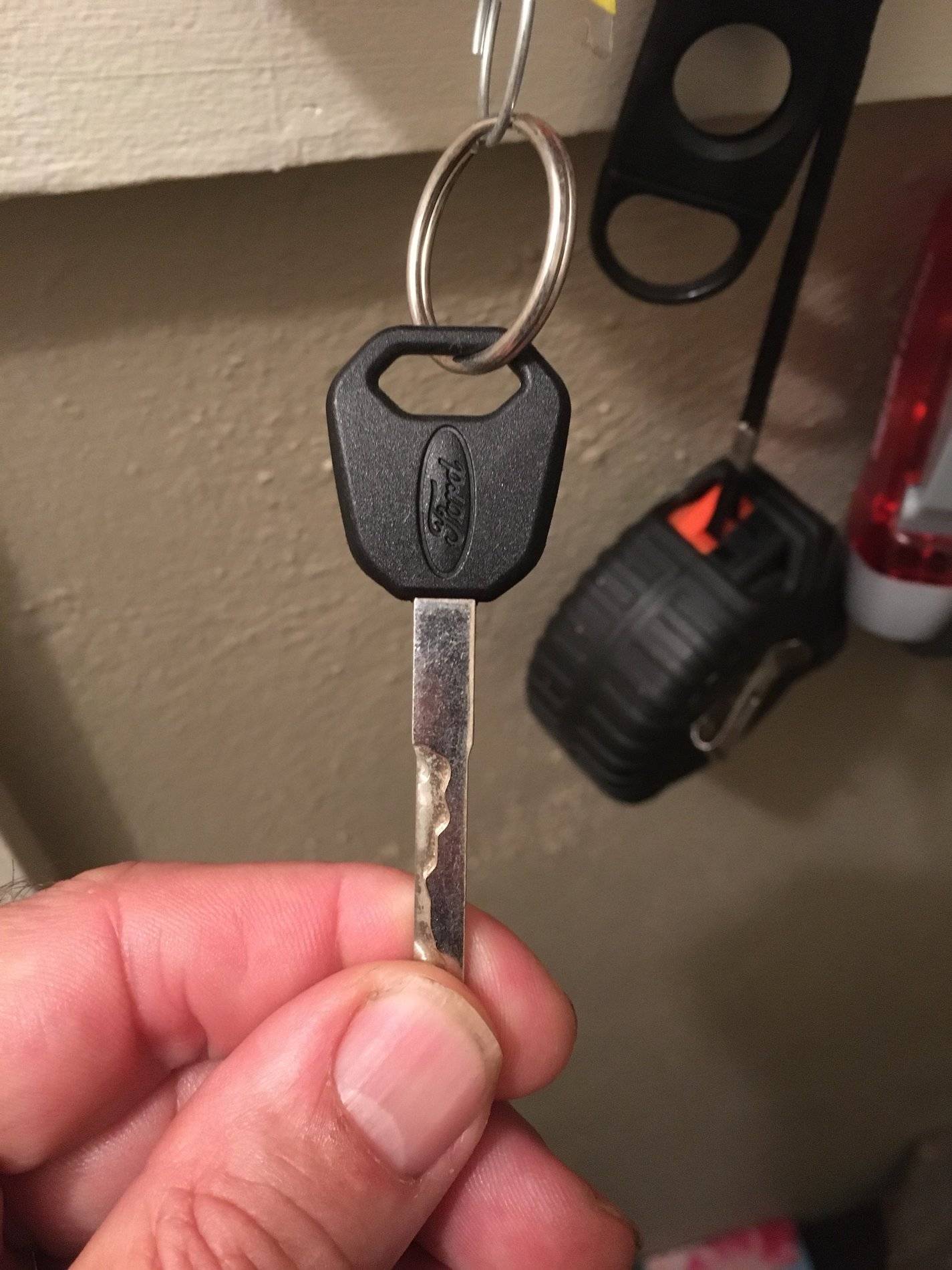

This came with mine. I never used it, but think it can only open the door and lock the glove box.

The car comes with two (admin) keys. It requires two admin keys to program additional keys. You can delete the third key if it bothers you. Are all 3 keys admin keys?

Thanks for the responds. But yes, i am saying all 3 are admin keys. I’m assuming previous owner lost one of the original keys, so they had another one programmed? Maybe they just wanted an extra set of keys? I wouldnt know but just the fact that theres another Admin key somewhere concerns me. When I called dealer, they werent really sure, told me to take car back to check it. I guess i can go back, just thought i could try to save a trip and reprogram the keys myself, somehow delete that 3rd Admin key.

Probably what happened was the owner programmed a spare key to keep the originals nice. Thats what I do. You can delete the third key if you want to.

I have to talk with a tech pertaining to another issue at the end of this week or early next week. I thought it was a simple matter of going into the settings and removing a key. One of my Rs has 4 admin keys. I didn't see a way to delete some of them. I'll get back with you when I have an answer.

I just spoke with a Ford tech and he says that the third key cannot be deleted via any car interface. He says that it has to be done with IDS which is a (dealership/tech tool). I asked about using forscan and he said he didn't think that it could be done via that method.
So, if you bought your car recently from a dealership, take it back to them (along with your two working admin keys) and ask them to delete the third key (I'd make them do it for free).
Or you can do nothing. I'm like you. I wouldn't want a third key floating around.

Thanks for helping. I’ll have to go to dealer then and get that 3rd key removed. I wonder how many people buy preowned like this and never realize there are other keys to their cars floating around.

When I picked up my 2016, 4 1/2 years ago, It came with two fobs, each of which has a "blade" inside of the fob transmitter itself. The owner's manual, (pg. 43), shows you how to access it, and use it, in case of battery failure or frequency interference issues. The key you have won't fit inside the fob, so I don't what the deal is. Glad I could help you out.
