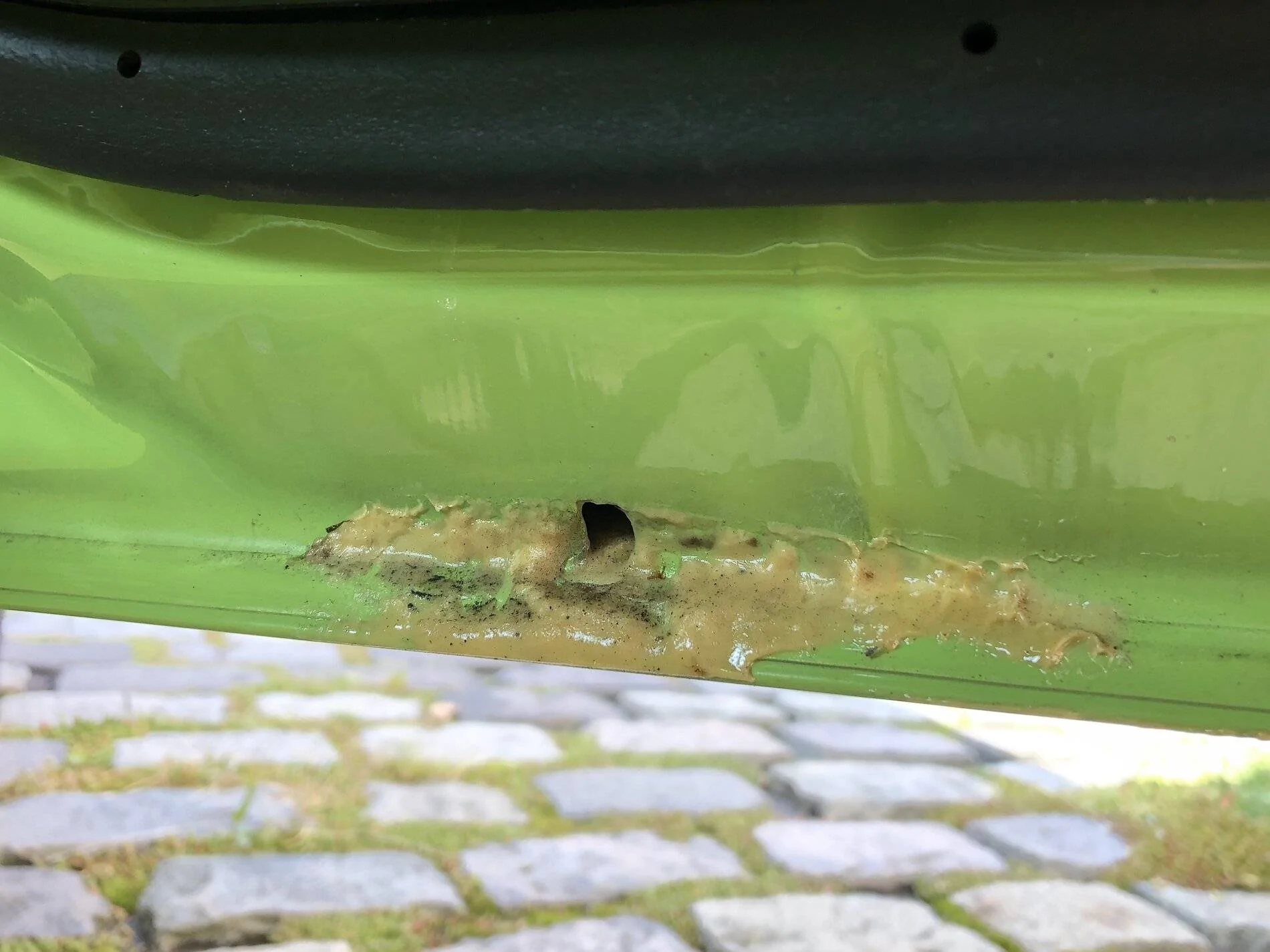

This is what the factory was looks like :
Does that appearance/ texture look familiar ?
WD :like:
No... No it does not. Then again it doesnt look like that anywhere on my car. Also thats covering like 5% of the seam. Seems a bit pointless.

It's the inside of the seam that needs protecting, not the outside :like:
That's the wax that Ford inject inside the body panels to protect them.
That photo is the bottom of my door 'as supplied' straight off the back of the delivery truck (once the white tape was pulled off that area). It still drips eight months later ... lol
I am not sure if Ford apply that wax in the trunk lid, but looking at your photo it might be a good preventative measure if they don't (or if your body shop didn't) ... :frown:
WD :like:
I can 100% confirm that my 2017 GT has no wax in the bootlid, and that it has oval shaped plugs across the lower rear edge to stop anything running out over the bumper... which makes me think.. "should there be wax in there"? Think I'll sort that out.
