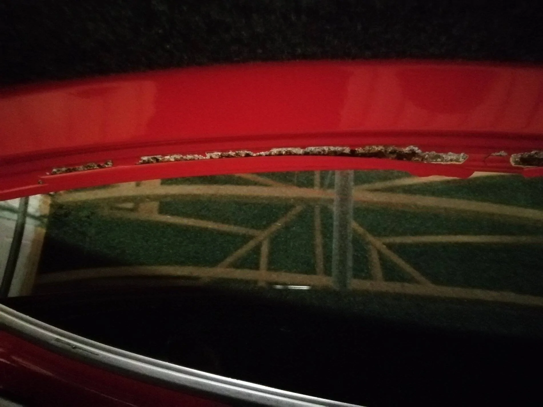

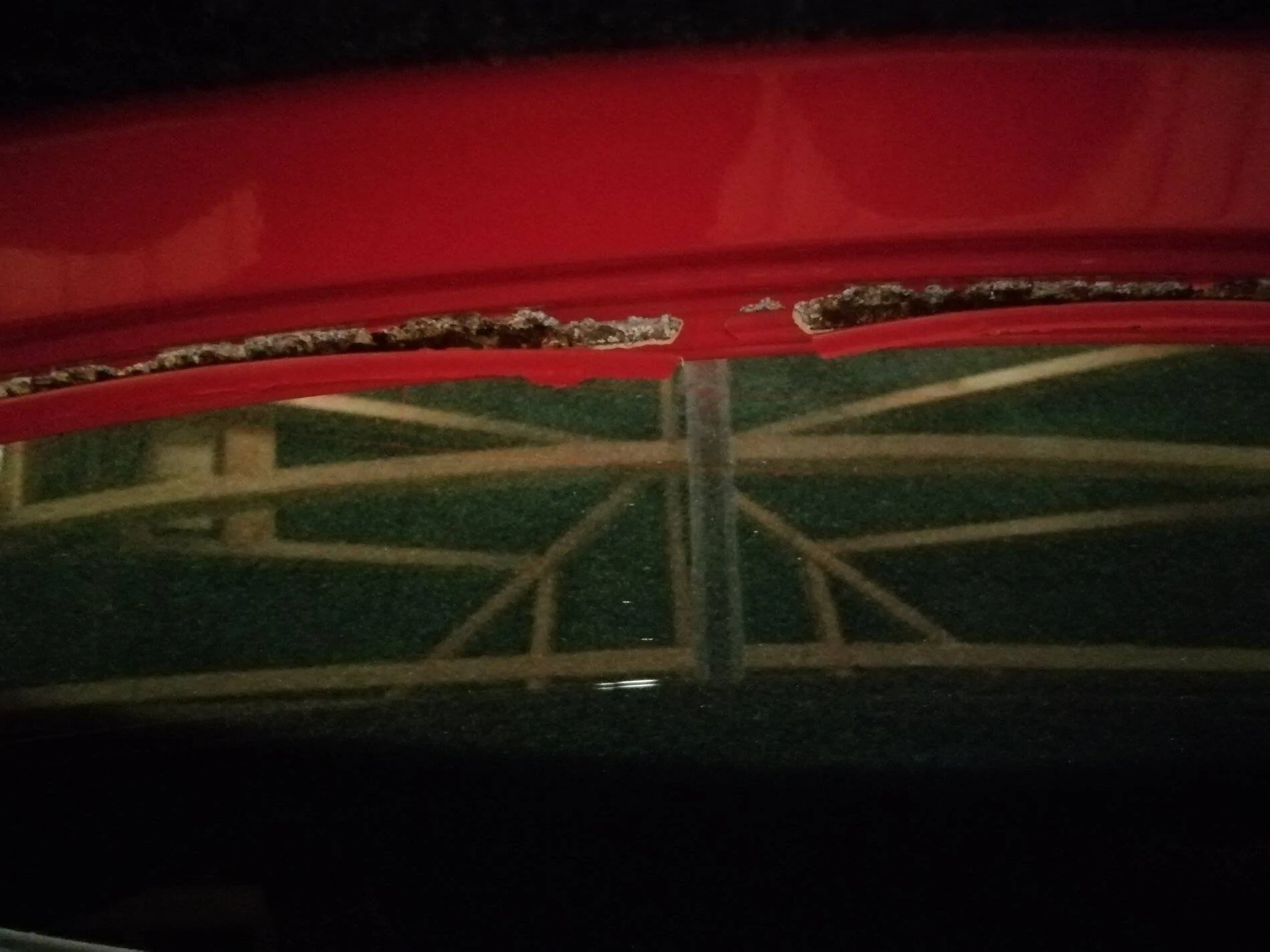

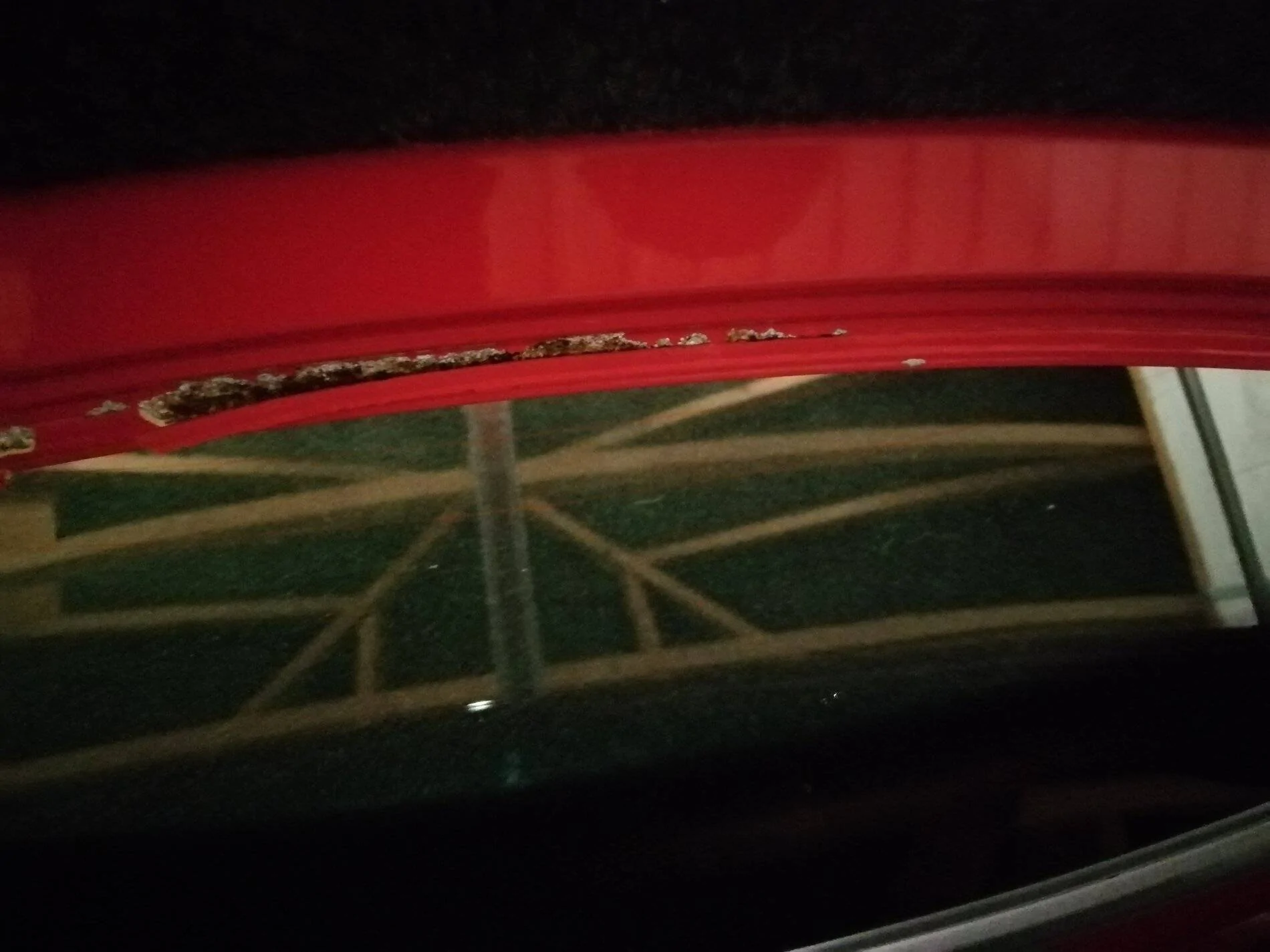

Have just noticed on my new to me 2018 GT really bad corrosion under the boot lid right on the back seam where it meets the rear window. Would appear that the metal welded over the seam had water ingress and is now hanging off with rust all around.
Before purchase I checked the usual spots on the hood and fenders and they were clear, didnt expect this on the inside of the boot. Obviously i am annoyed with myself for missing this but so did the garage who sold it to me, apparently.
Car is still in warranty and has annual service stamps, although I dont see anything specifically related to paint. But this should still be covered under the 3 year paintwork warranty right?
Anyone experienced similar or have a positive paintwork warranty claim experience at any ford garages around Leicestershire?
Some pics for reference:

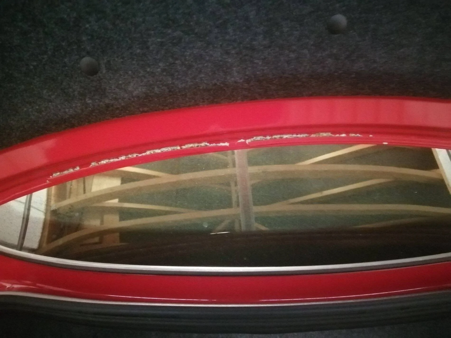

If the car is only a week old, then how is that corrosion? Looks like seam sealer to me from what I can tell. The photos are blurry.
Edit, I just noticed you added a third pic. In the last it does look like rust and missing paint.

It's commonly refered to as the "clinch flange".
The outer panel's edge is folded around the edge of the inner panel.
Then a sealant is applied, before paint.
Looking at the pictures, it seems as though moisture has got under the bead of sealant & corroded the metal.
At the recent annual service for my GT, I paid ÂŁ20 for the paint & body inspection.
I was told there was a 12 year Ford warranty for paint & body, provided the annual P&B inspections were carried out & also, that any defect was not the result of damage, such as a scratch through the paint, down to the metal. As an example.
Looks to me like a simple & water-tight case for warrantied replacement.
