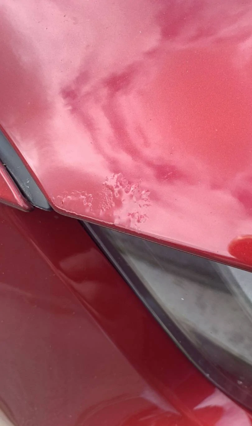

Hi all... anyone else had issues with bonnet corrosion on circa 2016 Mustangs?? Noticed this (in image) a couple of months ago.
Took it to independent Bodyshop who suggested paint defect. Local Ford dealer didn’t want anything to do with it (‘sorry mate... out of warranty’) and in fact wouldn’t even look at it.
I complained to Ford Customer Relations who offered to make a goodwill contribution to repair once I had it estimated by Ford Approved Bodyshop.
Ford Approved Bodyshop reported the defect was down to bonnet corrosion from defective paint job at manufacture. Recommended whole new bonnet (£3k) of which cost is covered in full on corrosion warranty of 5 years !! Thanks Ford

I got nowhere at all with my local dealership... in fact they flat out refused to even look at it as ‘the warranty wouldn’t cover it’. I went straight to Ford Customer relations and complained and they have been very helpful (although I don’t think they expected a £3k bill for a new bonnet) !!
They guy at the Ford Approved Bodyshop looked at the bubbling paint and immediately diagnosed corrosion from manufacture and said a respray would only delay more corrosion coming through....hence a whole new bonnet. Hope you get sorted

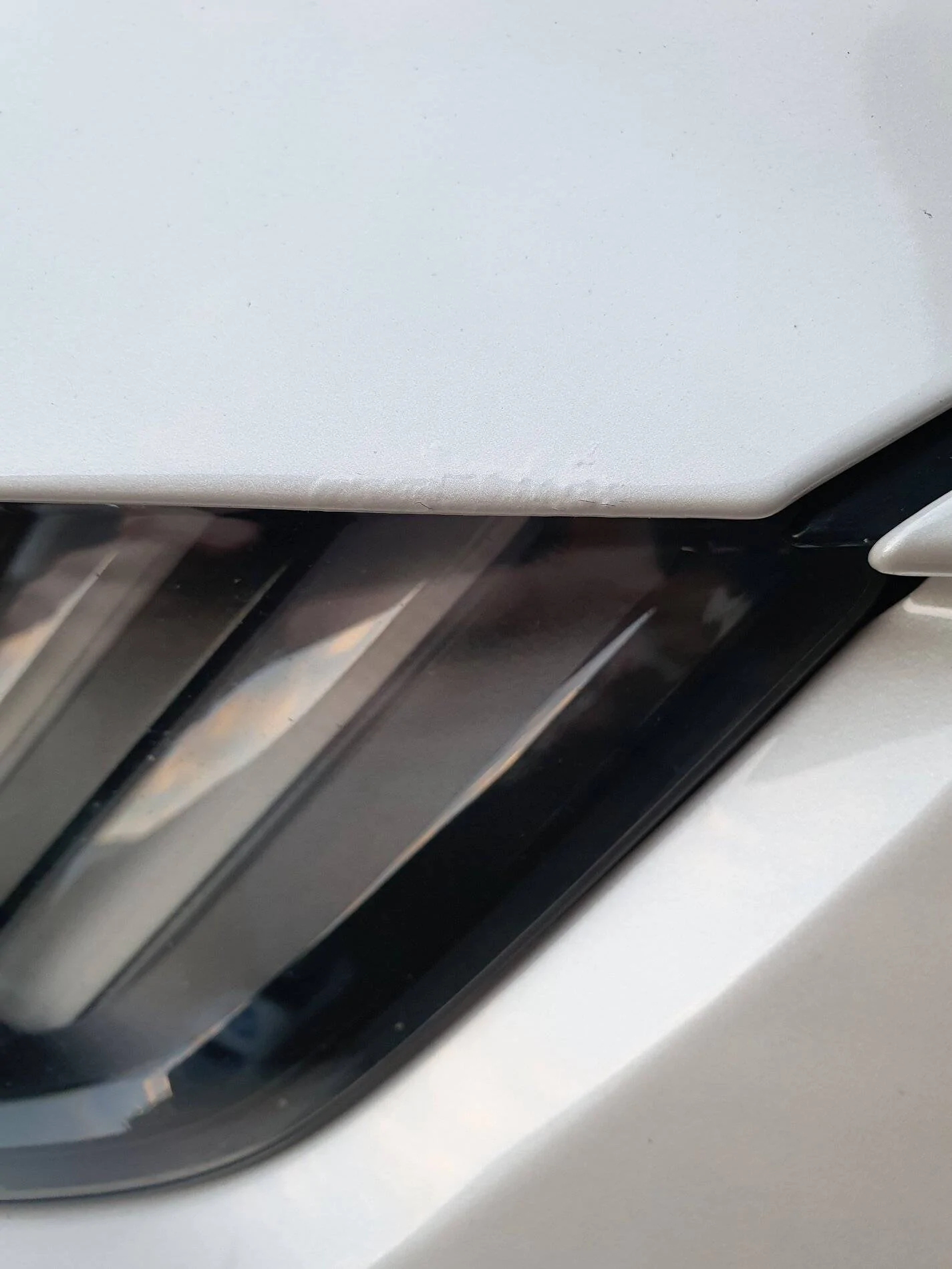

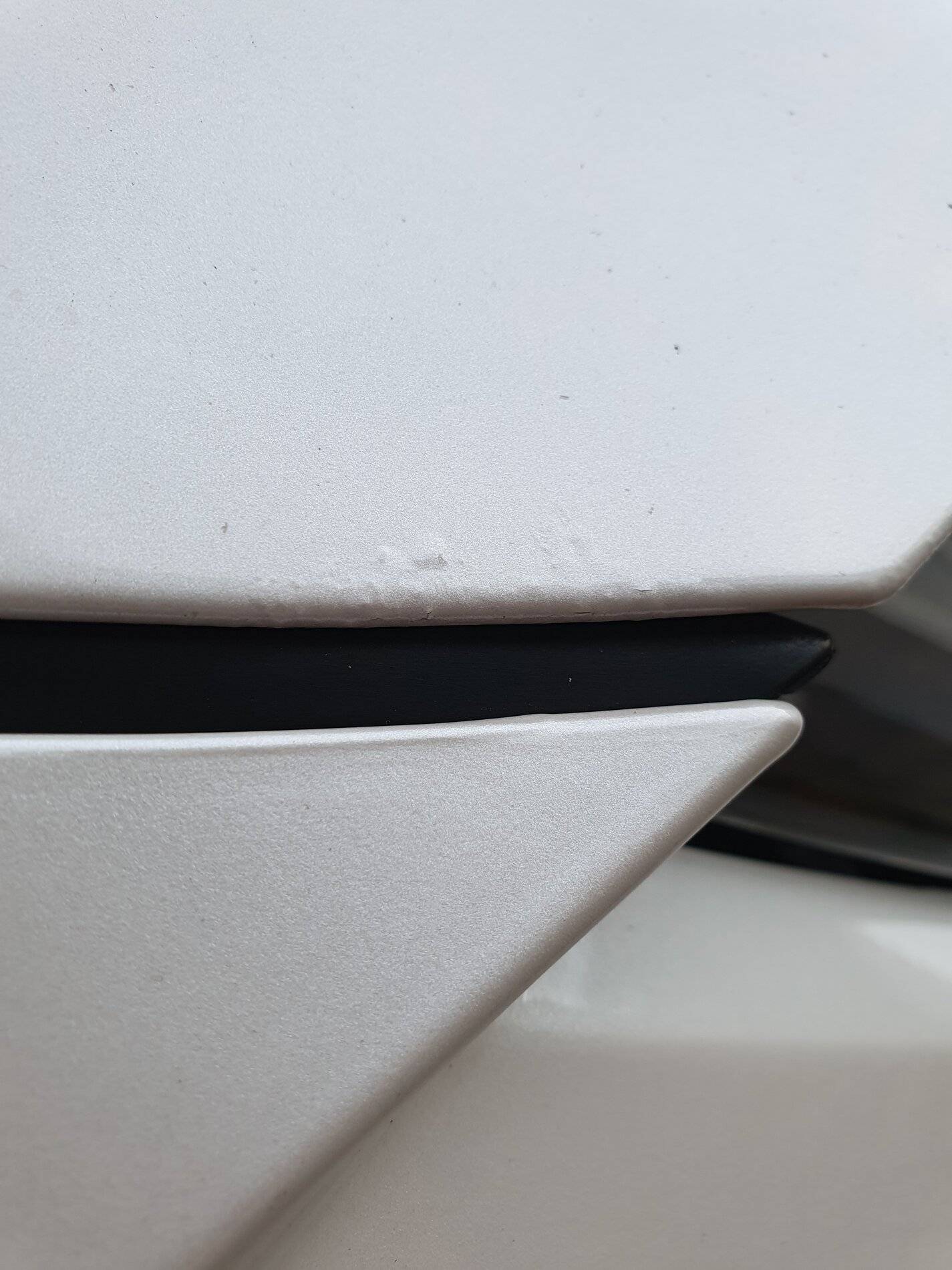

Saw this thread and decided to check mine, late 2016 EcoBoost (in a 2017 white platinum colour somehow). Have minor bubbling on edges of both sides, and couple other weird under the paint issues in other places. Had the car used last December so don't know of any paint checks. Don't really wanna get into any debates with bodyshops but just wouldn't like it to get worse either as it's not really all that noticable.
(Rust spots are in the boot drainage recess).

After going in for the bonnet replacement, I then found proper rust in the seams of the boot lid (it's steel). I felt a bit weird going in again but the paintshop guy said straight away - "it's like the old Mondeo's". My local Ford paint shop had lost count of Mustang bonnets, F150 wings and Mondeo doors he'd done over the years.
