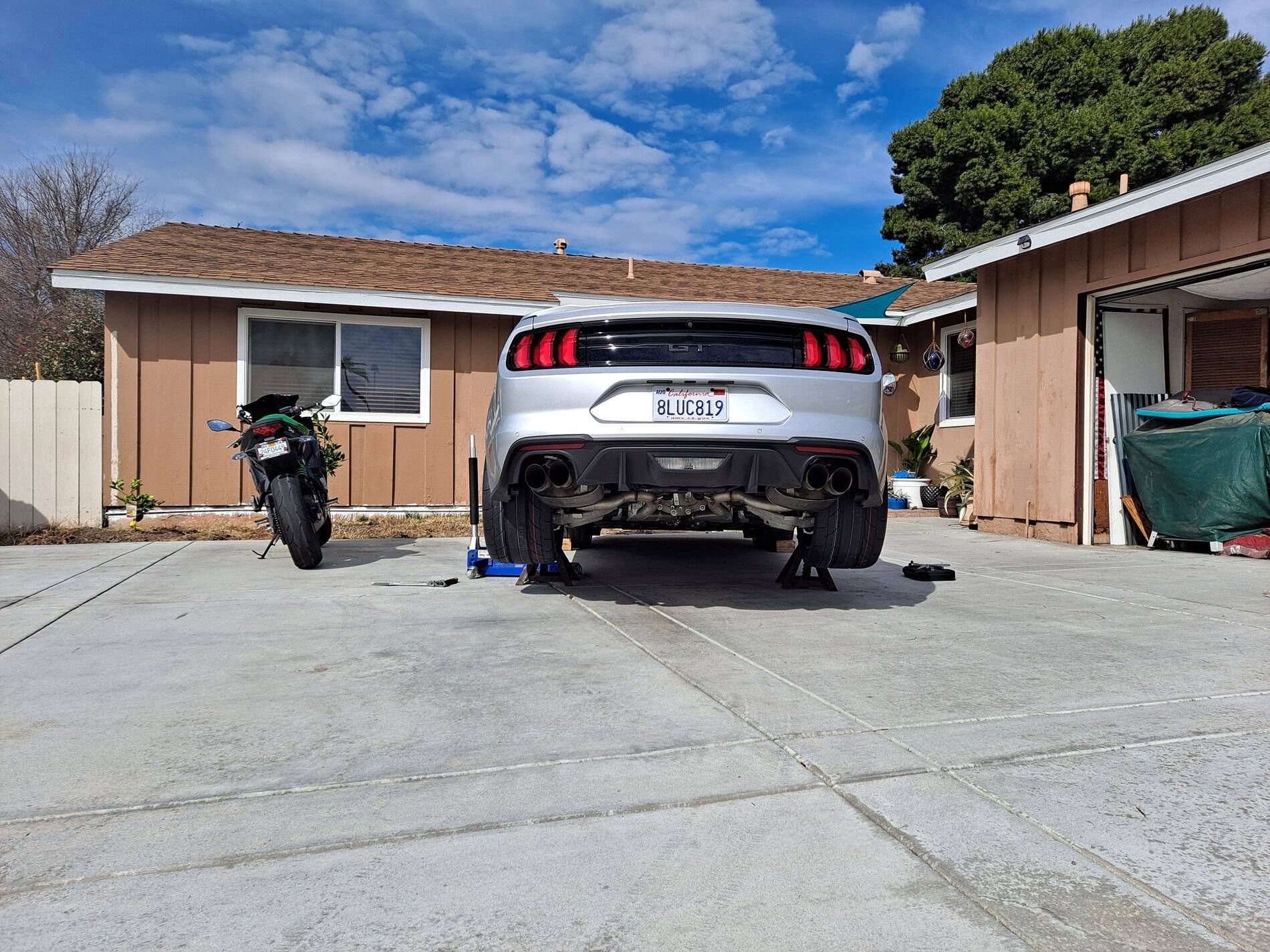

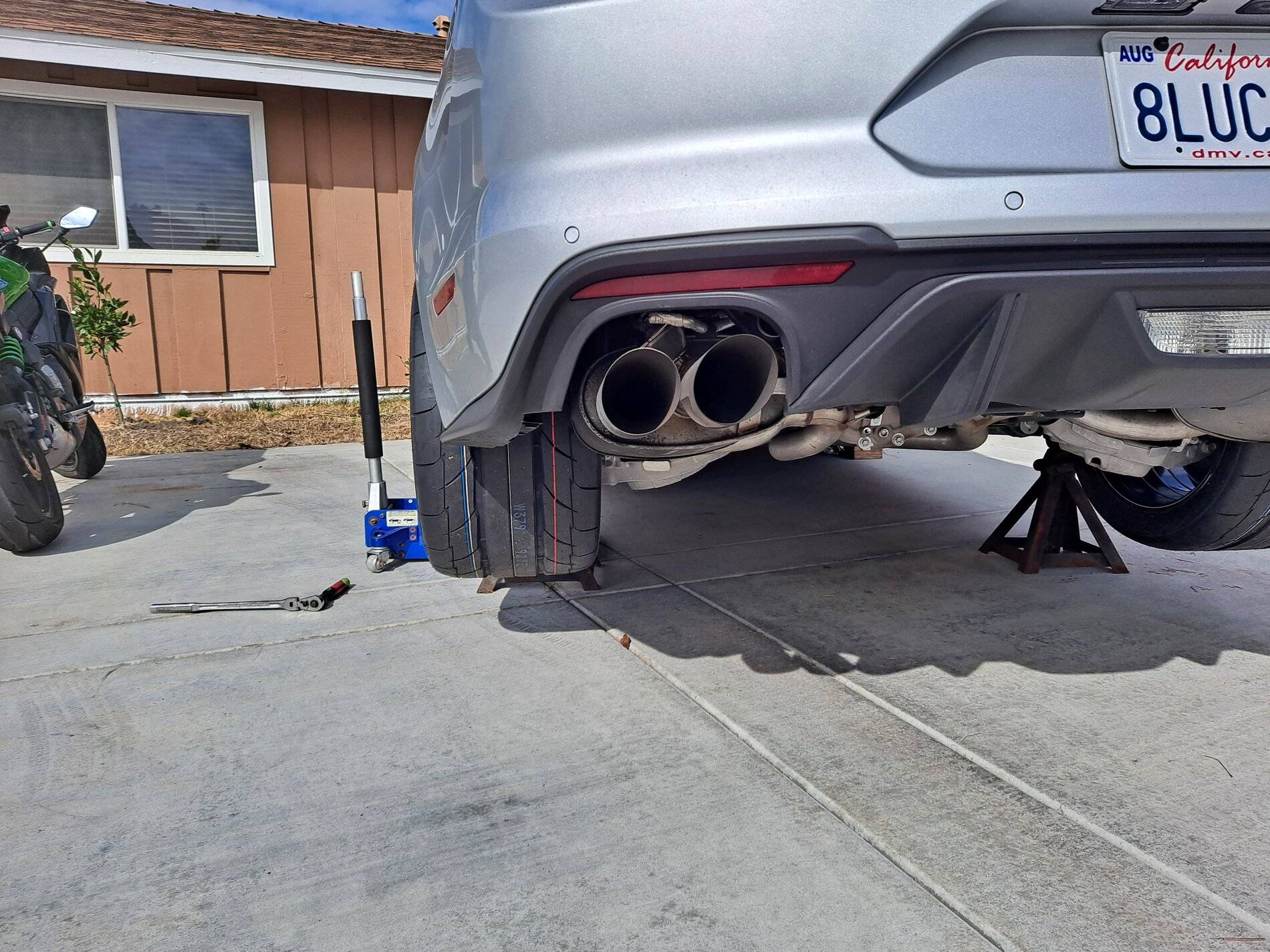

What wheel combo are you using to cram a 345 under there? Any side pics and wheel fitment pics?

They are project 6gr Five in 19x10 front and 19x11.5 rear. I actually don't have pics of the side I will take some tomorrow. Side note with the stock rear shock mounts the tire was like 1mm away from touching, I used a die grinder with a sanding disc to give more clearance but plan on changing them out for ones that have 1/2 more clearance than the stock mounts just to be safe
