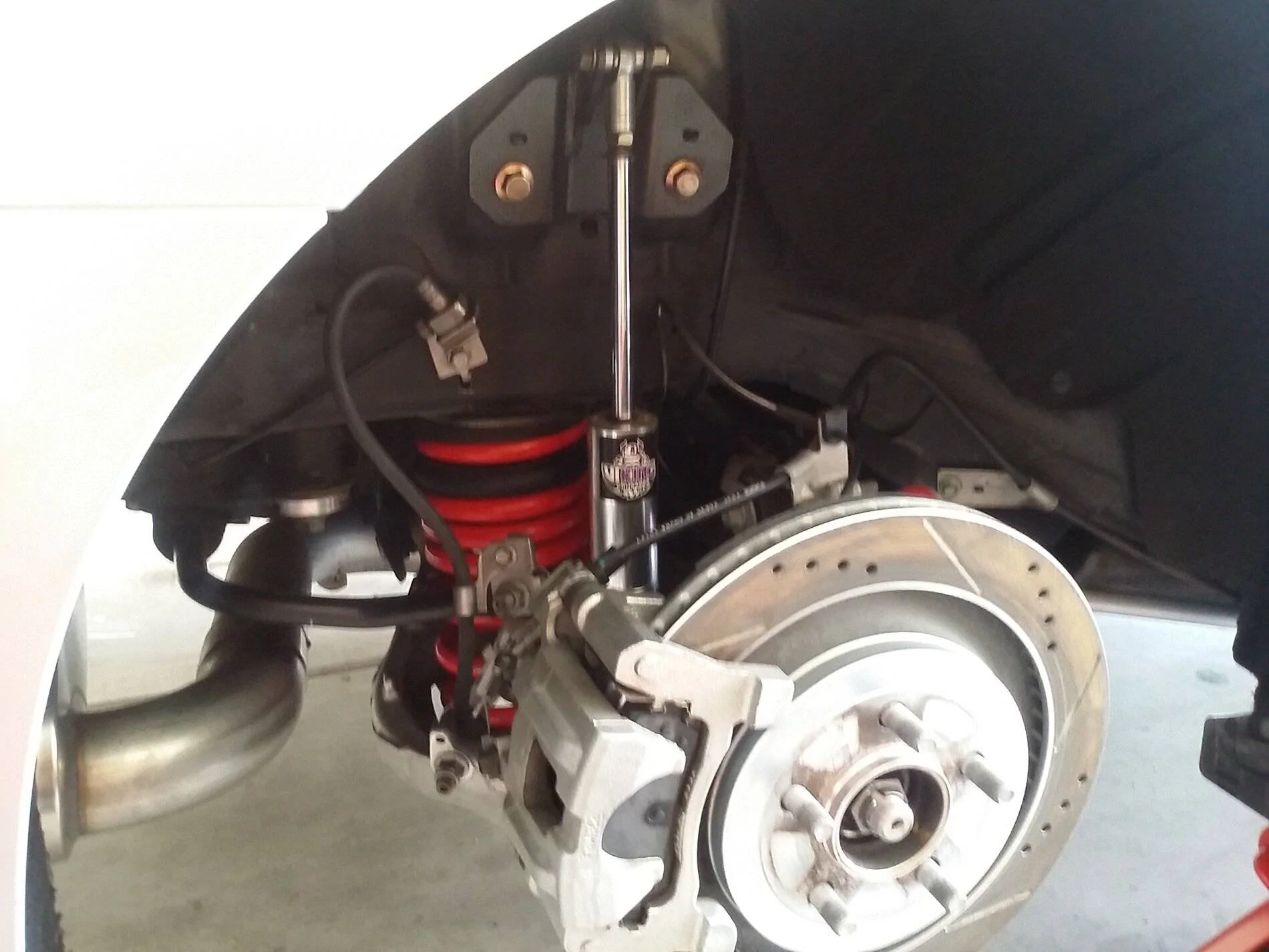

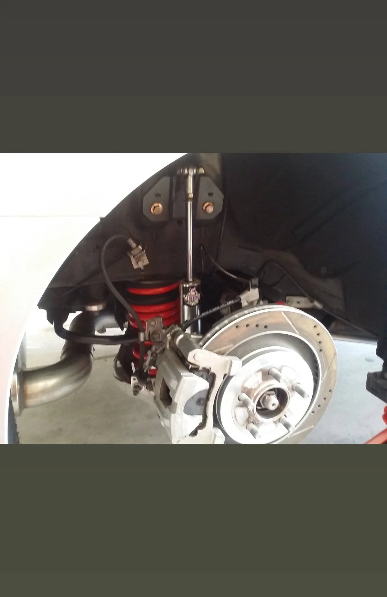

I'm in that power range , 305/30/20 nt05 , hooks good . Rear suspension mods are steeda cradle lock outs , axle lock outs , sub frame connectors , bmr vertical links , shock mounts , eibach sport lines , and to tie it all together viking crusader shocks . Daily car and doesn't see the track .
Thats awesome, thanks for the info!
