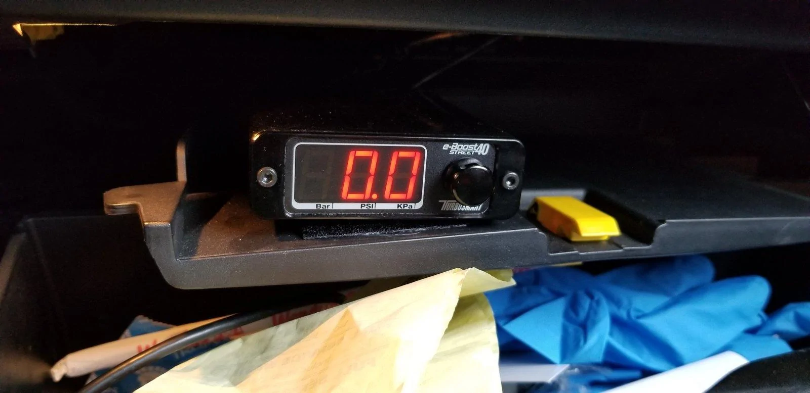

I dont think it belt slip I have the 8 rib setup. But I do have a boost controller that I have no idea how to work. I need to find out what wastgate spring I have. I have the turbosmart e-boost street. The guy I bought it from says there is a high and low setting. I think it set to low. The most boost I've seen is 10 pounds then it'll start to drop. What wastgate spring should I have?

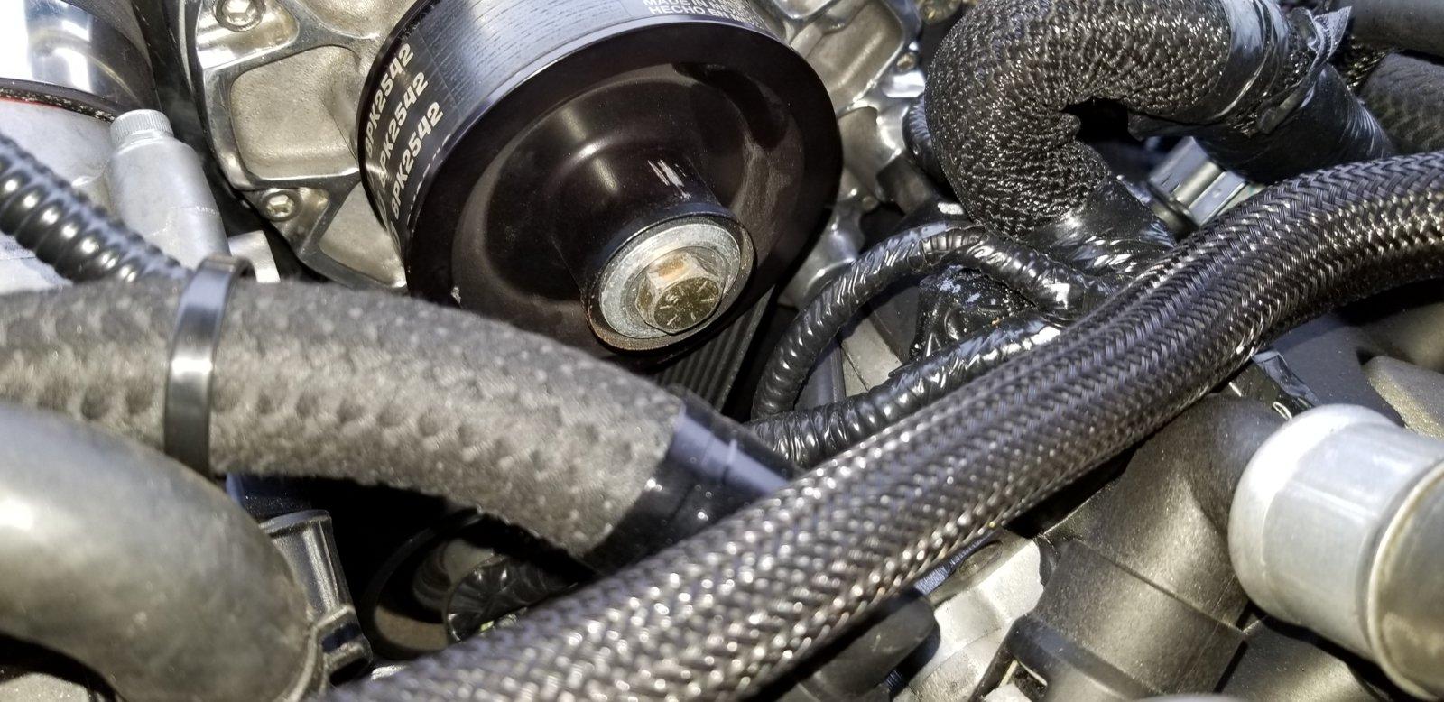

Don’t discount belt slip without looking. I was skipping my Whipple 10 rib. You will see a fine black dust around the pully.

I have no idea how any of this works lol smh. I'm new to boost. This boost controller thing.... I'm scared to touch it.

Is this the dust your talking about around the pulley? I hope this pic uploads

No it would be a lot worse. That looks like normal dust.

So yes you are supposed to climb in boost with rpm. BUT you are gated. So once the controller sees “10psi” it will open the gate and bleed off pressure.
How much boost are you loosing and what rpm? After that pic I would say controller issue.
