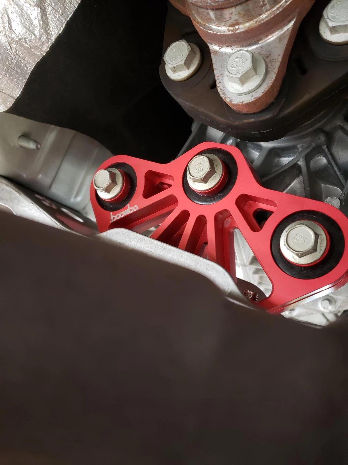

If you want. The vibration occurs if I ride a gear for a min instead of shifting or just normal acceleration between 1800-2500 from. Even giving it some gas does not smooth it out.
So I dropped off the car yesterday to get an alignment done. The only other concern I have, which may not be much but as you can see in my photo the trans bolts look fo be just a hair off center from the bushings...not sure if this is normal.

Car is now aligned (except front as I do not have Caster/Camber plates) and the vibration is there though it does seem more manageable now. However, it is still a little more than I like (expected some) so I am going to go through what I have read is about a 450 mile break in period and see how it is afterwards.
Might just order the 60D mount or even just go back to factory with an insert since I do not mind some additional vibration/noise. The 70D just feels a little off, though, when I drive with my windows down I dont seem to notice it, lol

We would forsure say to step down to the 60D, especially if its a daily. The 70D is more oriented to frequent track days.

It's not my daily by any means but the vibration is a little distracting so I went ahead and grabbed the 60d so I can compare...grabbed the short throw as well so I'm excited to see what waits.
