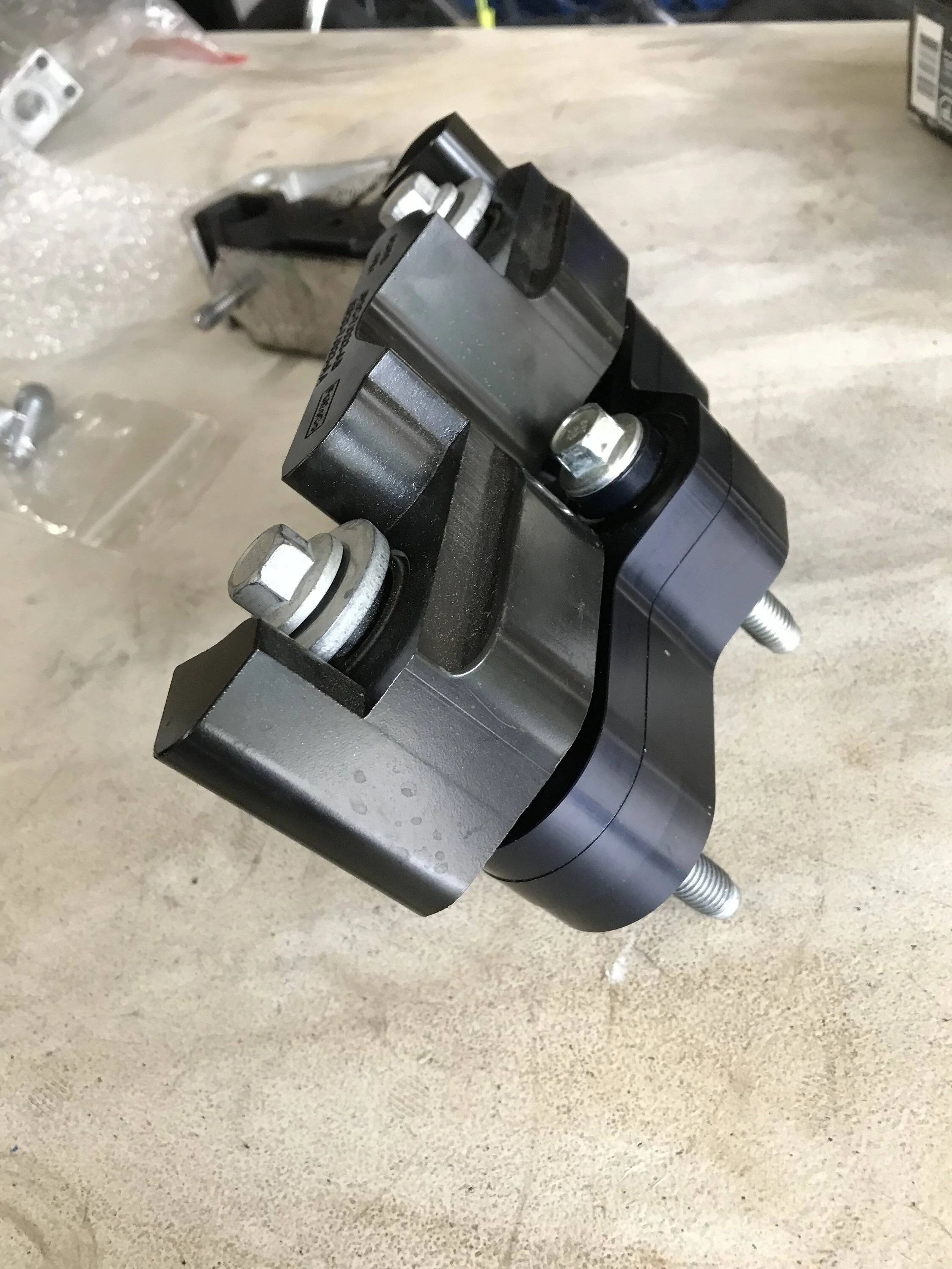

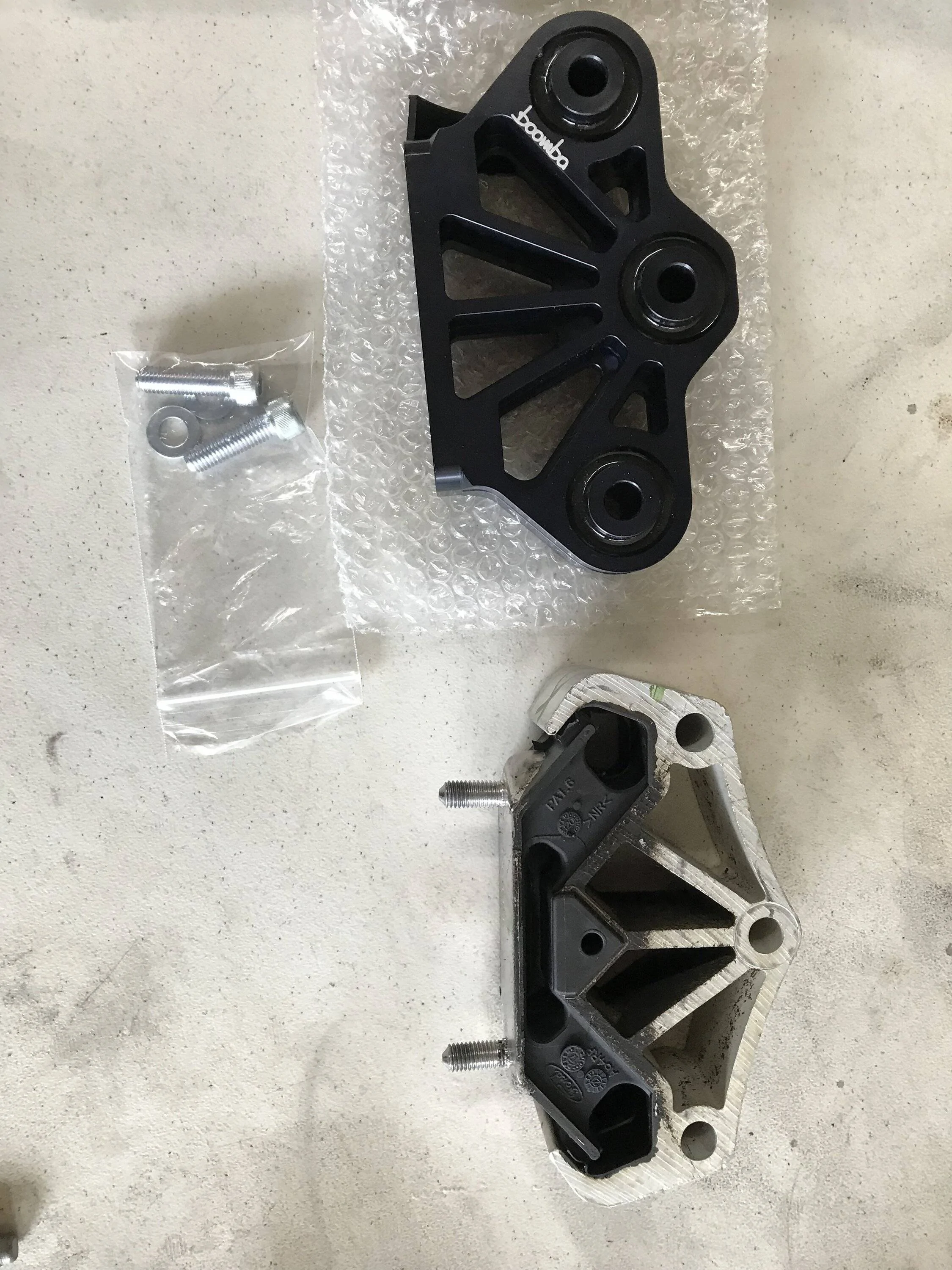

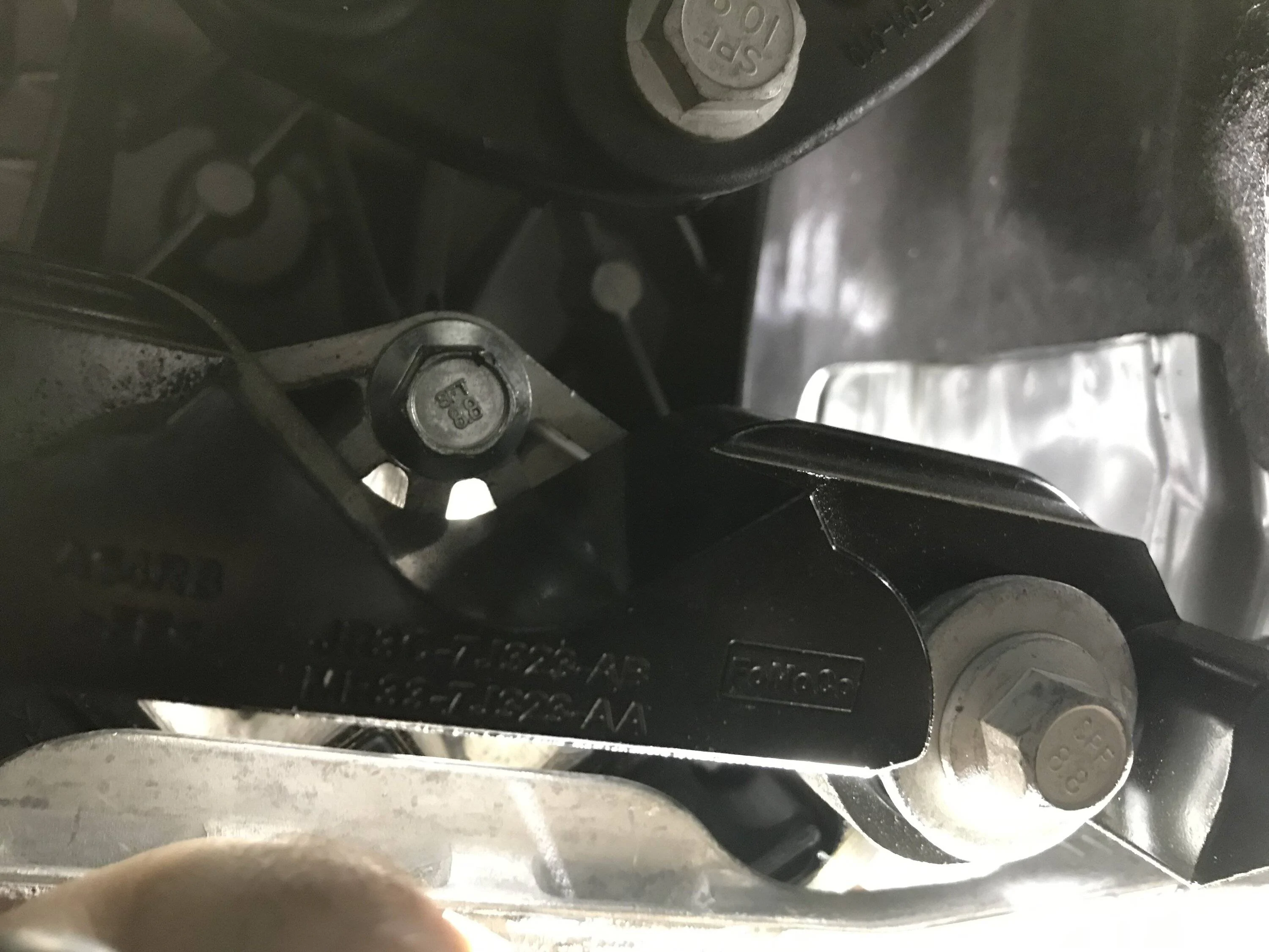

Installed the street spec trans mount from boomba today.
I discovered my 2021 appears to have an additional bushing I haven't seen on pictures/videos. Its a bit of a beast at 4.2lbs. I went ahead and installed anyway, combining the boomba piece with the fomoco piece.
The good news is a nice reduction in shifting slop. The bad news is that there is noticeable vibration above 2000rpm. I will see if that reduces over time, but as it is - not for me.
First pic - stock
Second pic - comparison (both 2lbs)
Third pic -boomba plus stock bushing (or whatever its called)
