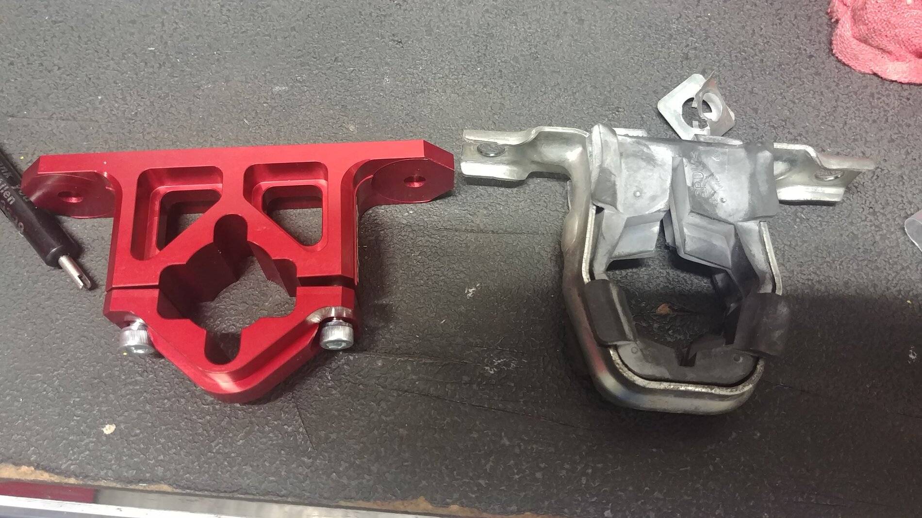

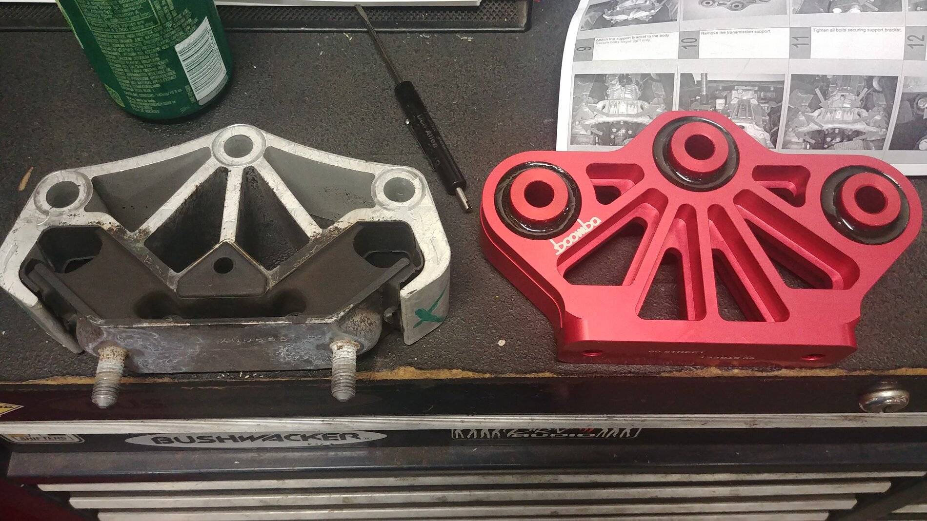

I'm running the Boomba trans mount (street version) and the shifter mount. I'm happy with the upgrades. Never had a problem with mis-shifts or lock outs after these 2 pieces and the BG Synchro fluid change. My car is a fun, street car. I don't track it or take it to the strip, just something fun to drive around in.
Here are some pics of the original and boomba replacement parts I took during the install.

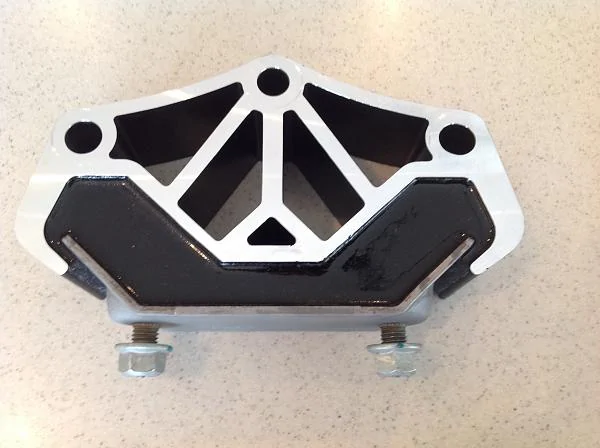

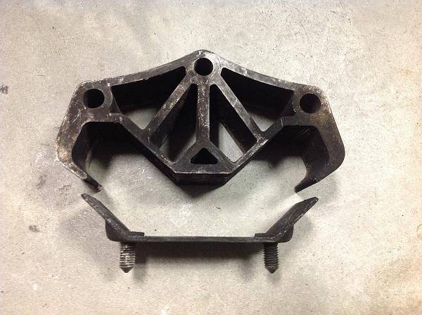

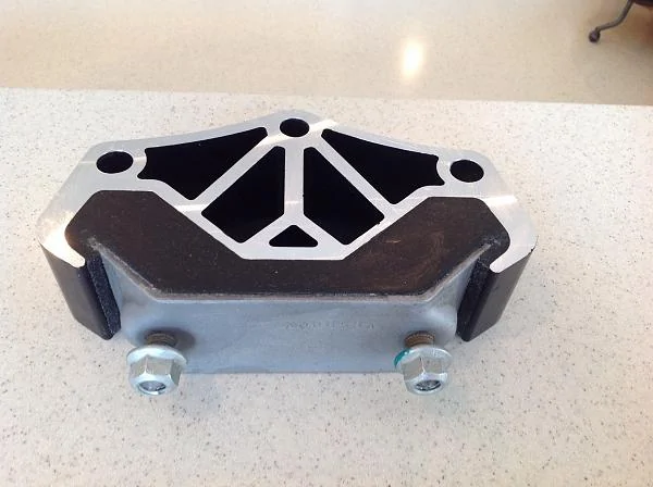

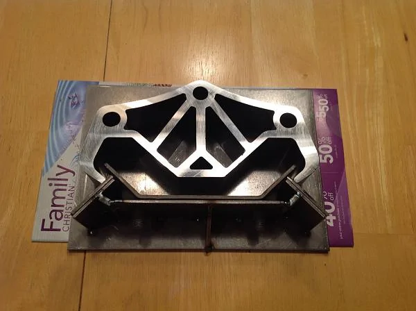

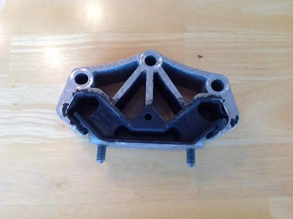

The Boomba trans mounts look very nice. I was just going back through old photos from when I was modifying my 2013 Mustang GT and I found these pics from when I enhanced a factory trans mount. I started off by cooking the rubber off in an old BBQ grill, had my buddy fab up a jig and I ordered some liquid polyurethane and poured my own bushing. It turned out very nice. I ended up selling the car without installing it. I don’t even remember where it is now. It does look the same as what’s in my 2019 Bullitt though.

Additional info. for you if you do it yourself. I placed the jig plate and trans bracket in a box, after I bolted the bracket down to the jig plate. I then packed sand (got some from the craft store) around the perimeter. That’s what keeps the liquid urethane from leaking out before it has a chance to harden. I also rubbed a coat of beeswax on the jig plate first, so that the mount would separate easily after the urethane hardened.
