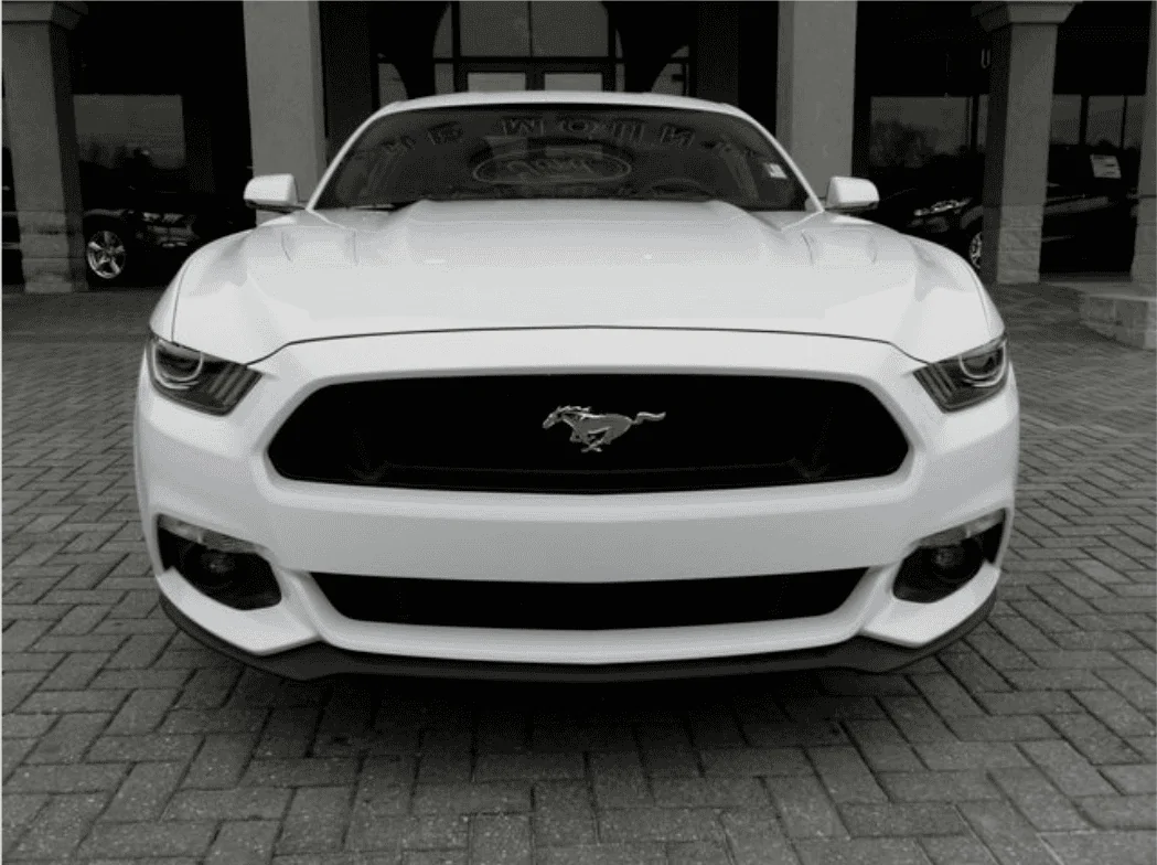

Just curious if this is the typical hood gap that others are seeing? I don't have to opportunity to visit this car before purchasing and have been told that the price I'm receiving is crazy and that i should be skeptical on the quality. Any input is a huge help! Thank you!
http://www.filedropper.com/screenshot2015-02-17at33423pm
Can you copy and paste or upload the screenshots directly to the forum? I don't want to join file dropper to see it. Thanks.
That site is sketchy as hell. Here's the embed.
And no, that looks like a uniform gap, although it does seem raised. You might be able to get away with adjusting the hood to have it shut a little lower.
This is how Ford advertises the car at shows (and how it should be). Notice how the hood and fenders are completely flush and uniform:
This is the problem people seem to have every now and then:

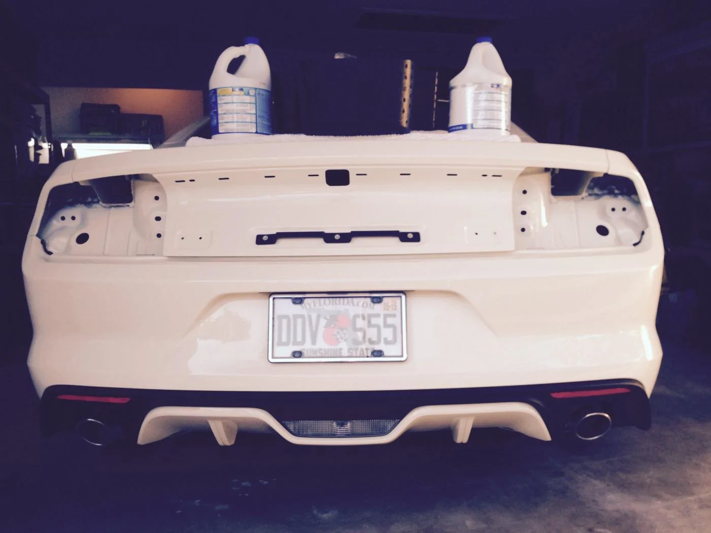

I would like the "Tolerance Police" to bet me a $1,000 Bill that they can slide their bill across the door into the Front Fender/Rocker Panel/Door interface and not see it disappear under the Fender. If it disappears, it's mine.
This photo shows the alignment of the trunk lid with the fenders, after adjusting the gaps and flushness. If this matches, the creases on the deck lid will not be aligned, although they are close. To have the deck lid creases align, you would have to move the trunk lid aft, which would have the deck lid sticking out past the fenders, and also affect flushness with the fenders.
Also, the angle of the three trunk lid bends (the back, the tuck and the folded under lip) don't match with their counterparts on the fenders. Lots of pounding and bending matched a bit, but still work to do.
To the left of the bath mat on the trunk, you can see the lip of the trunk lid that meets up with the sail panel near the rear window. I had to pound down the right side of the interface, because its slope was different from the quarter panel, due to the whole left side of the car drooping. This might be because of the weld jig, or it's just a stamping issue which leads to the glass drooping up near the roof.
Once the deck lid is aligned, you can mount the tail lights, but the left one interferes with the corner of the fender/trunk well. I bent all these in (which was done after this photo) to allow the light housing to go back as far as possible. All attempts to align the lights with the plastic trunk lid panel have failed. With this design, you really can't do it. Something is gong to have to be sacrificed to give you the most important or pleasant appearance.
Will update later when I have a more temporary/permanent solution.
You can make it look good from 4 to 5 feet away, but will still see problems up close.

Now YOU scare me! Are you saying that we have a car were the alignments have to be fixed with a "hammer"? I thought the back lights have "only" be taken out and then put back in place to align with the trunk lid? Now the back of the car is wrong welded/bad parts used? I am getting depressed right now.
But it explains why the rear part of the car looks so twisted. Window, lit, rear panel and tail lights, trunk lid and so on. I am getting a bad idea that the whole frame of the car is somewhat twisted and someone tried to pull the panels in place to weld it together. (If that makes sense what I am writing.) :faint:
Bay1Stang
Nov 9, 2014
1,055
226
Magnetic '15 V6 051a
Wait a minute you're telling me if the trunk lid is misaligned it's because the parts on the car don't match? That's some sick joke, right?
