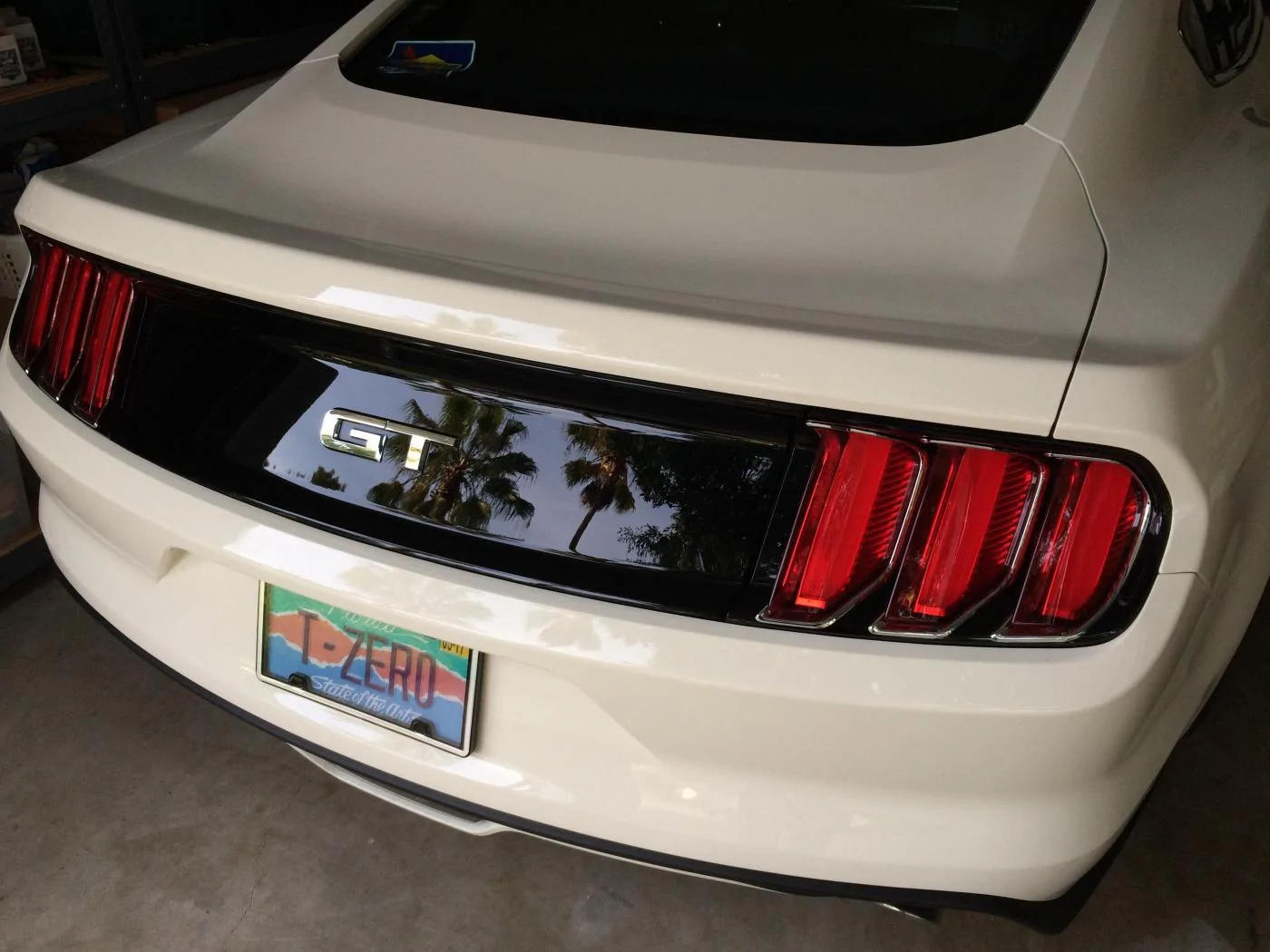

Trunk can be adjusted, but lip width over tail light is different than quarter panel width over tail light. Wrap-around of bumper meeting quarter panel at tail lights is designed that way. It's on their CAD drawings for the body panel specs.
