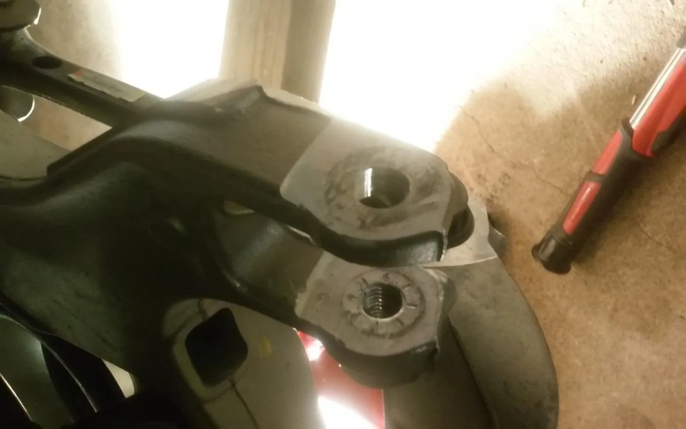

I can't get one of the vertical links to go into the bottom. Think is was caused by user error :shrug:
Cutting to the chase - Link was originally installed without one of the black insterts on the bottom, it was torqued to 129 that way. I noticed it had a little play when I wiggled by hand. Installed other Link, 10 minutes easy, but noticed it was solid, no play.
Preparing the box to put old links and noticed the black washer :frusty:
I think torquing without the washer has now made it too tight, and I am trying to come up with a way to pry or wedge it enough to get it started on the bottom. The spherical bearing moving is not making it any easier lol.
Any hints?

I can't get the bottom started, because it too tight. I was able to get the old one wedged start a little, with some grease and a mallet. Think I will let it sit that way over night and have a go at it in the morning. Worst case scenario, I want to be able to get the old one back in. I may have really screwed this thing up, by juuuuuuuuussssst a hair lol

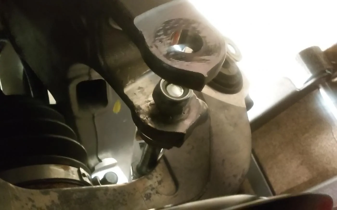

Kelly, is this what you were describing to start?
Kelly, am I starting in the right direction? It was a b*tch getting this far. Had to take another bolt of to allow me to pull some and get a socket on the bolt.
Don't want to go any further if I am mucking it up :)

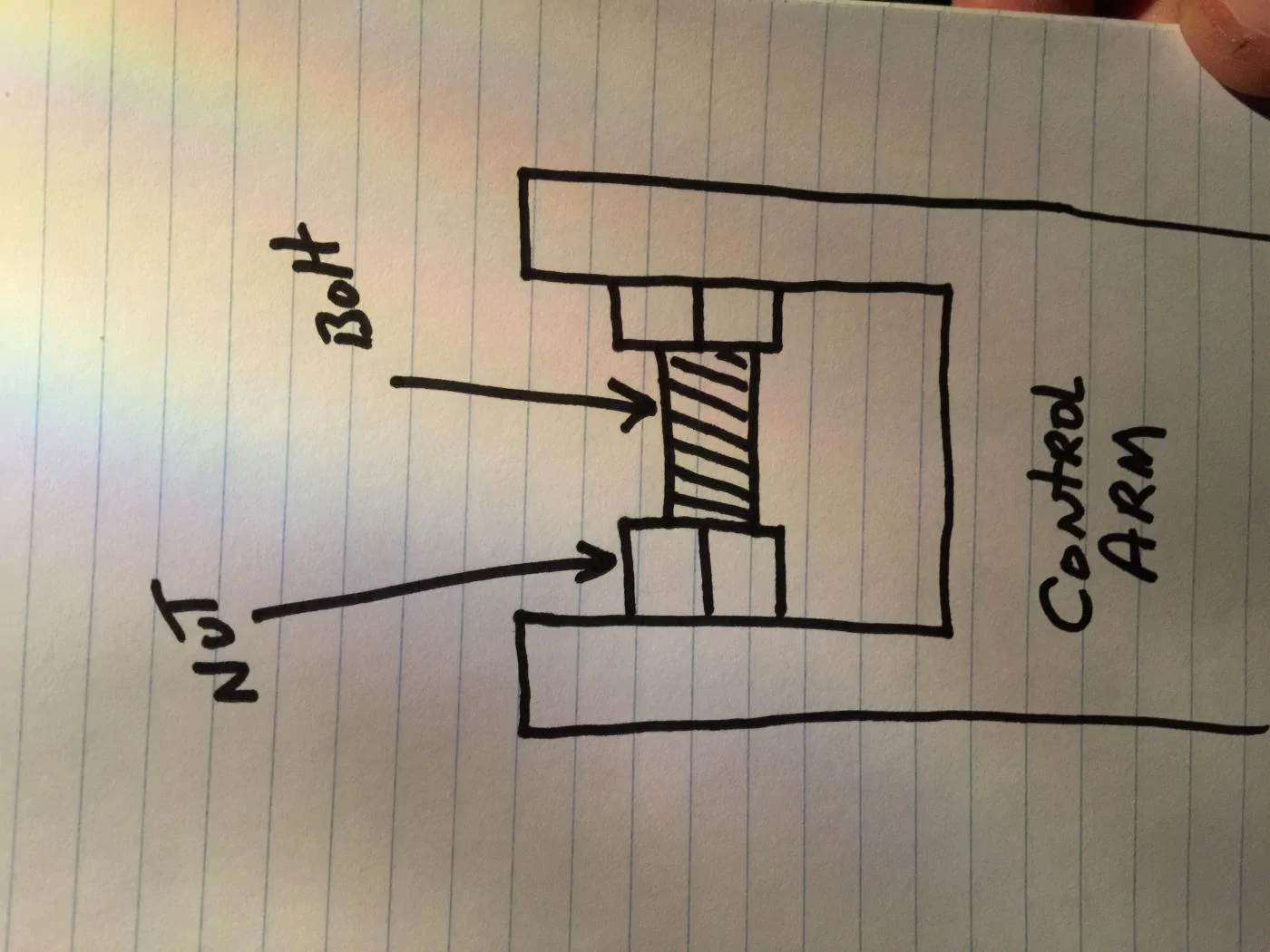

Better hope you don't bend it to much and fracture or break it. How much wider do you need to open it up? Take a 2x4 and cut it into a wedge about 1/32" - 1/16" wider then the link. Hammer it in place all the way through. The aluminum will have some spring back. Or take a bolt that is slightly smaller then the opening with a nut and install it between the opening and loosen the nut so it spreads the opening apart. But use a large bolt 3/4" or larger diameter.

Only need to open the width of 1/2 a washer (really small). I think I will try the second option here, versus trying to get the 18mm bolt through the back. I will have to take a lot of stuff off to get it in

Sorry for the 1st grade drawing, I'm in my work truck and all I had is a sharpie.
Install the bolt and nut as shown and loosen the nut.

Excellent art work, going to try this in the morning
