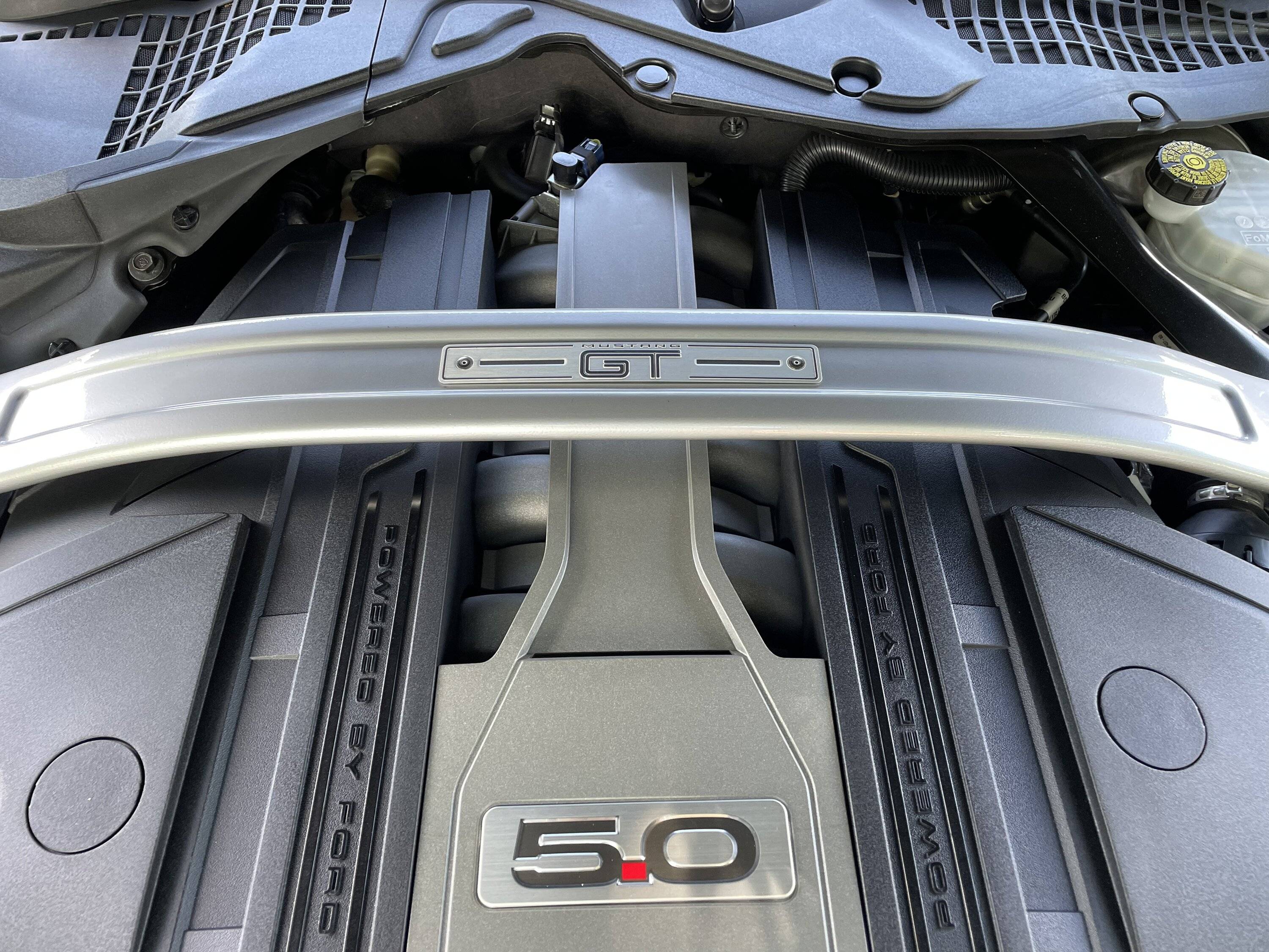

Thanks for the detailed info and actually listing parts. The question I have is my PP2 has the GT upper stut brace. Which brace are you suggesting?

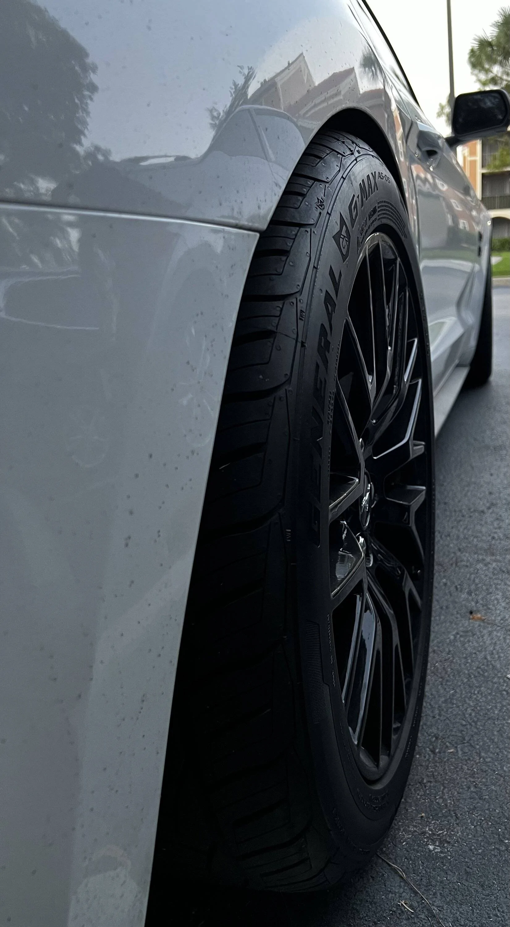

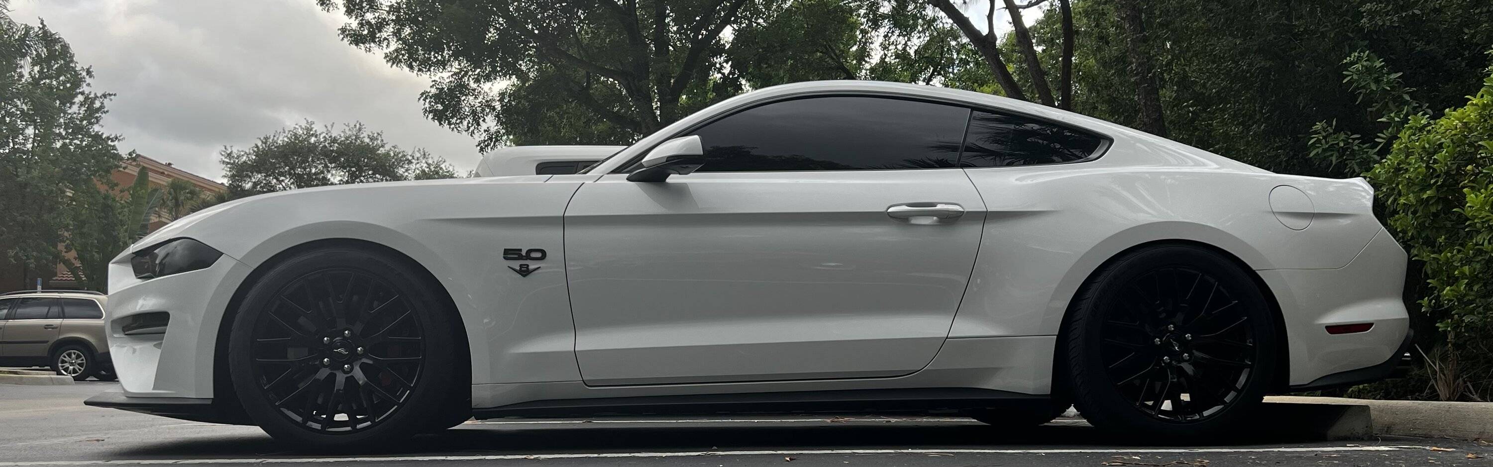

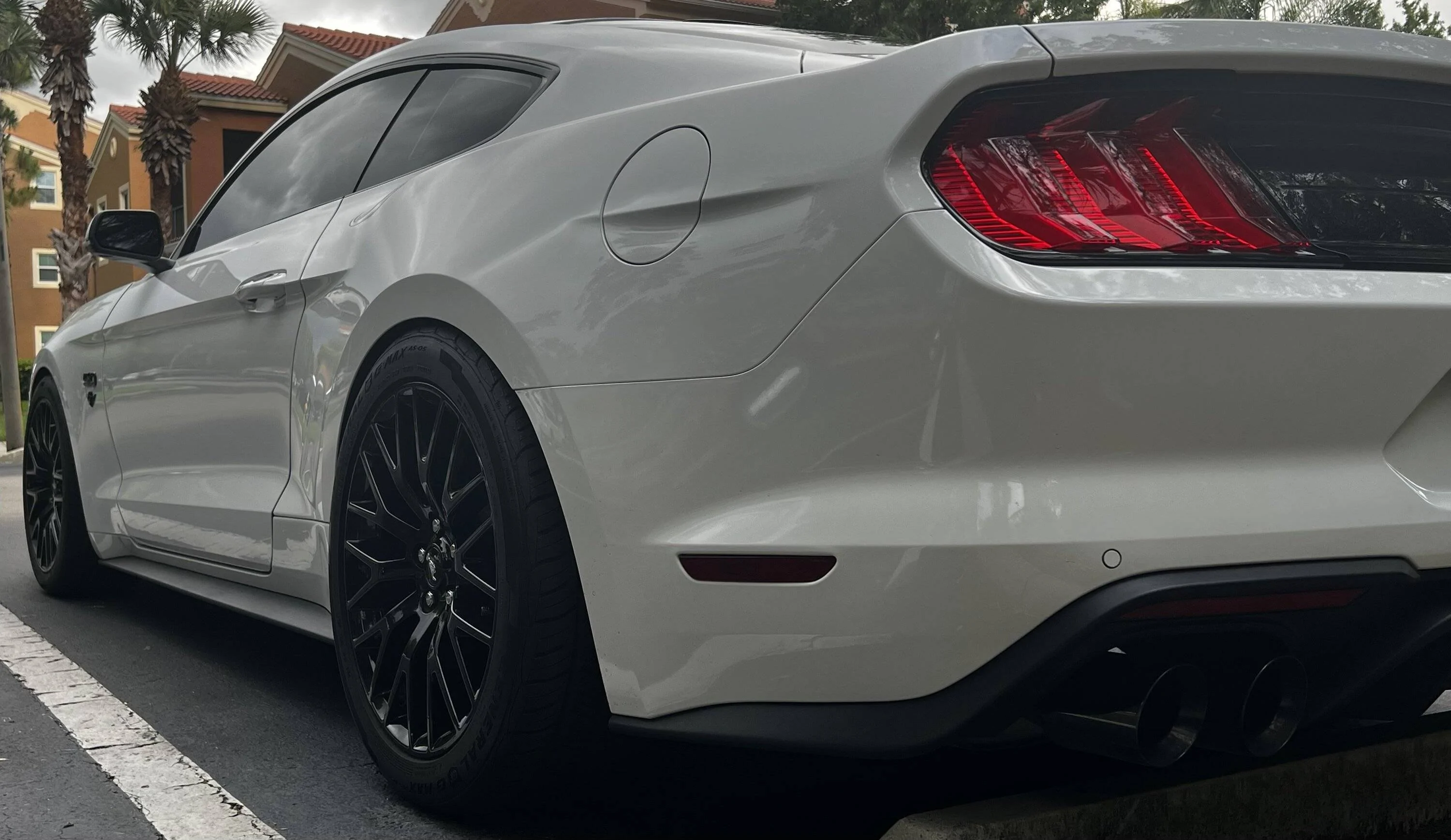

I have Steeda subframe bushings, front lower crossbar that ties the subframe together, rear subframe braces, Steeda Active shocks and struts and Steeda progressive springs. Car rails turns and rides better than stock (PP1 suspension). Its a great deal for the money and I love it. I added wheel spacers because I love my wheels and look at how they fit. Doesnt get much better than this
