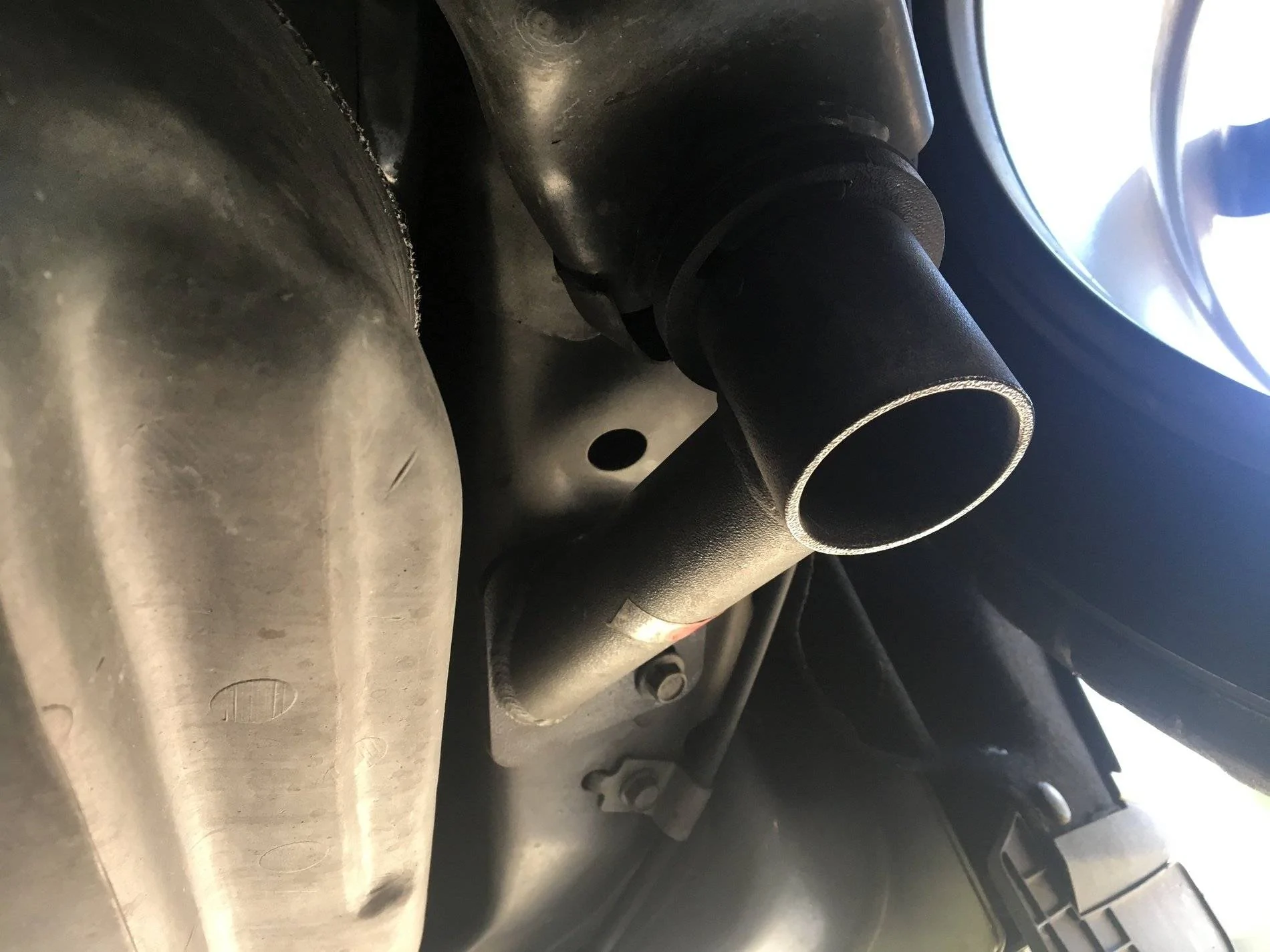

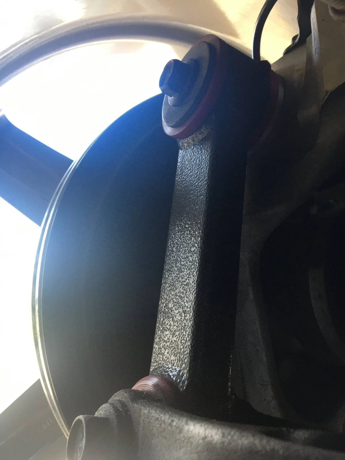

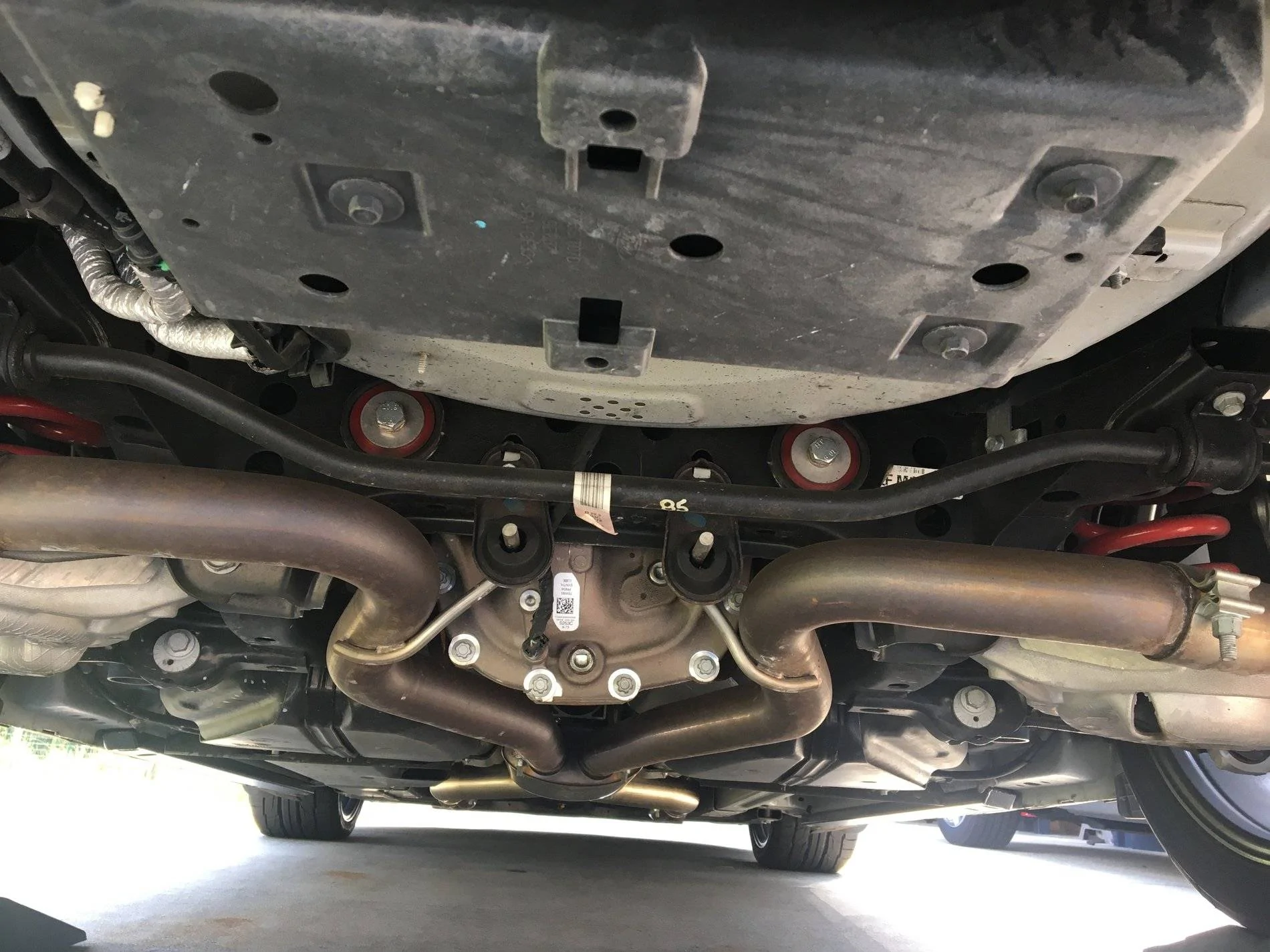

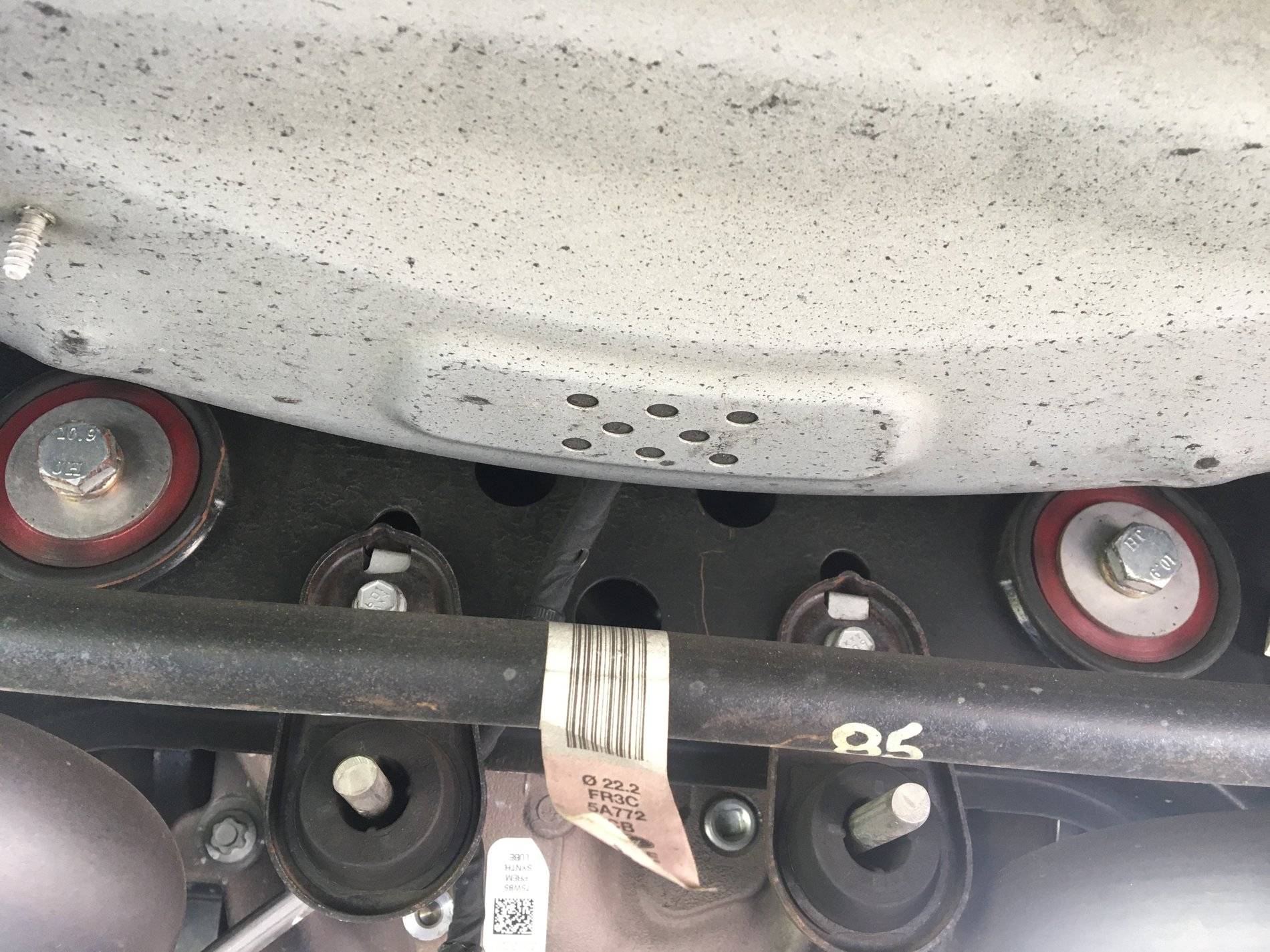

I uploaded some pics of the rear suspension components. Nothing looks out of place to me...

If it's only happening in gear, then the diff bushing inserts (or are they the bushing replacements? I can't tell) are probably the culprit. They convey all sorts of strange noises straight into the cabin. If they are the full blown bushing replacements (BK049) then you are screwed because short of replacing the entire subframe, you can't go back to the stock bushings.
