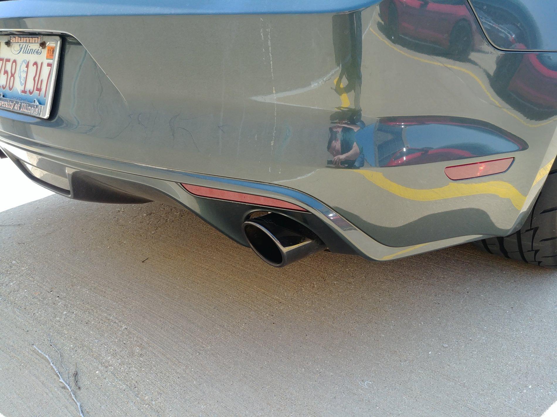

I decided to do something I'd been toying with for a while, but if it never happened, I would've been happy. I was able to trade my Corsa Sport catback for a Borla ATAK catback locally. I will say this: there is nothing wrong with the Corsa Sport. It is an amazing exhaust and one that I would recommend highly. I was yearning for a slight uptick in growl/bass without losing the high RPM scream. The ATAK delivers on this. It's probably just a smidge louder at WOT than I want, but it's not as loud as the Xtreme...roughly halfway between the Sport and Xtreme. Overall I'm really happy with it, and just like Corsa, the ATAK delivers absolutely zero drone.

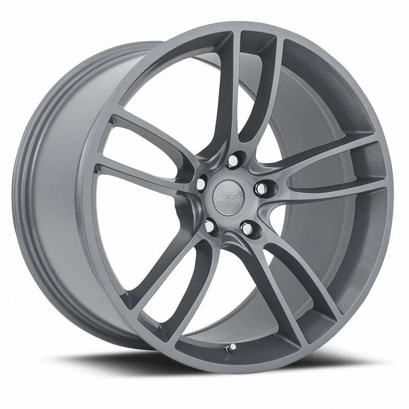

Curious what made you go with those over some lighter options you've been somewhat interested in previously? Certainly one of the easier ones to keep clean!
Niz55
May 10, 2015
358
3,674
1,285
Us
17 GT350
They are good wheels. Flow formed and light.
What tire size are you going with ?
BmacIL
BmacIL
Enginerd
Sep 21, 2014
69
14,989
8,911
Naperville, IL
2015 Guard GT Base, M/T
They're in the same ballpark on weight as anything else that's remotely affordable, and I got a really good deal. Also they'll definitely be easy to clean!
19x11 et50 all four corners with 305/30R19 RE71R

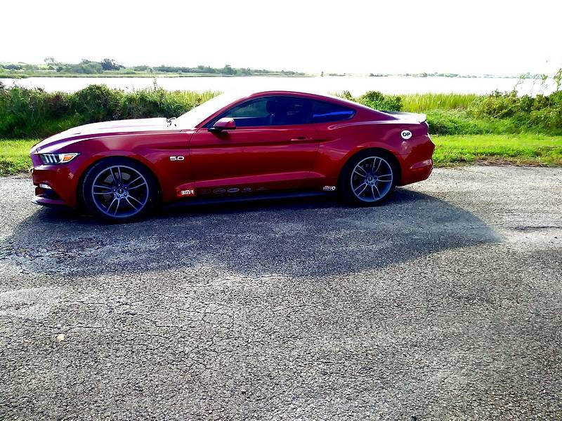

I have the same rim in 19x10 sq. wearing 285/35/19's 35's for comfort & look's as I am dropped. You notice the difference in rolling weight on your butt dyno too. Graphite or black or bronze?
