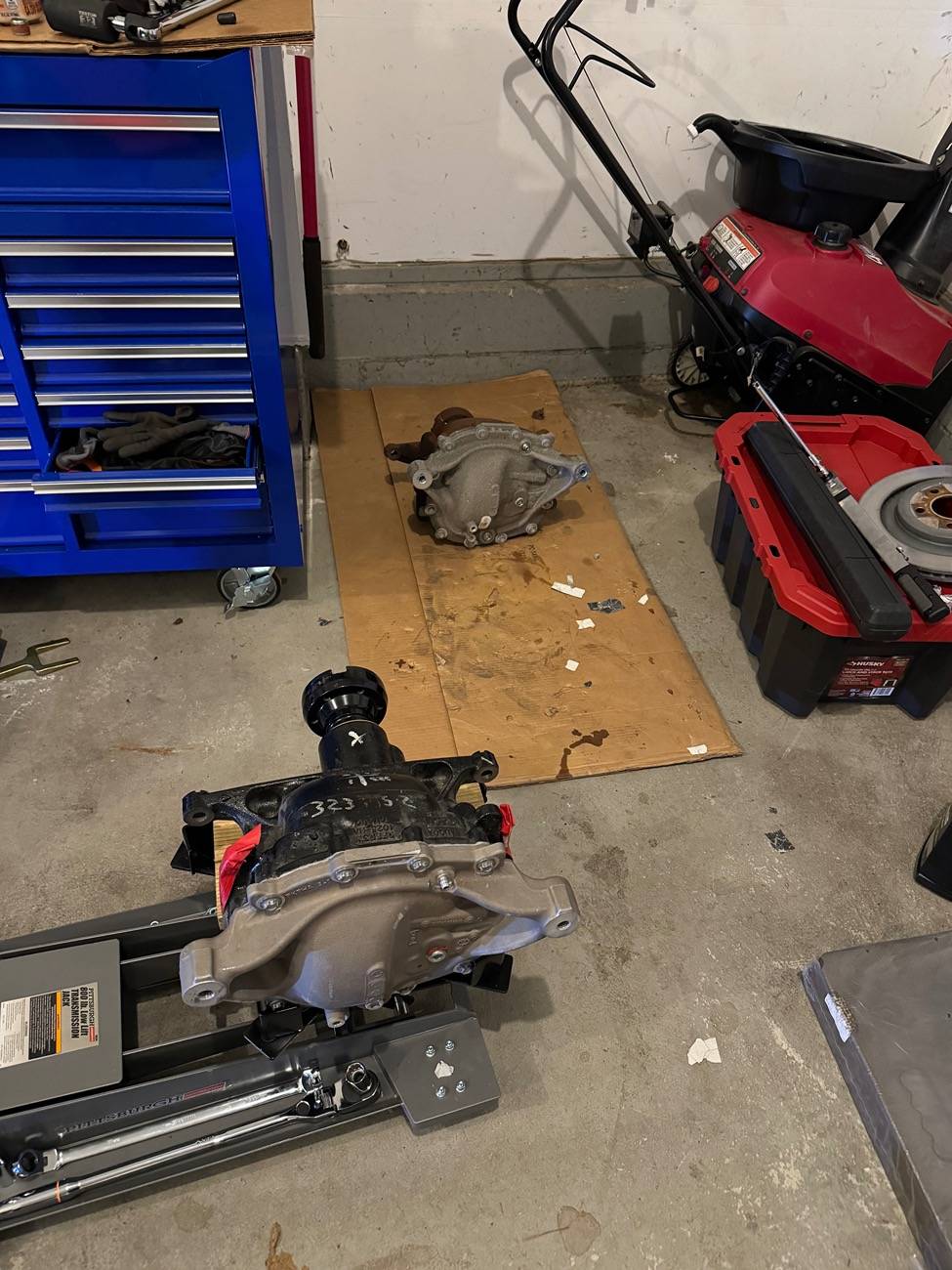

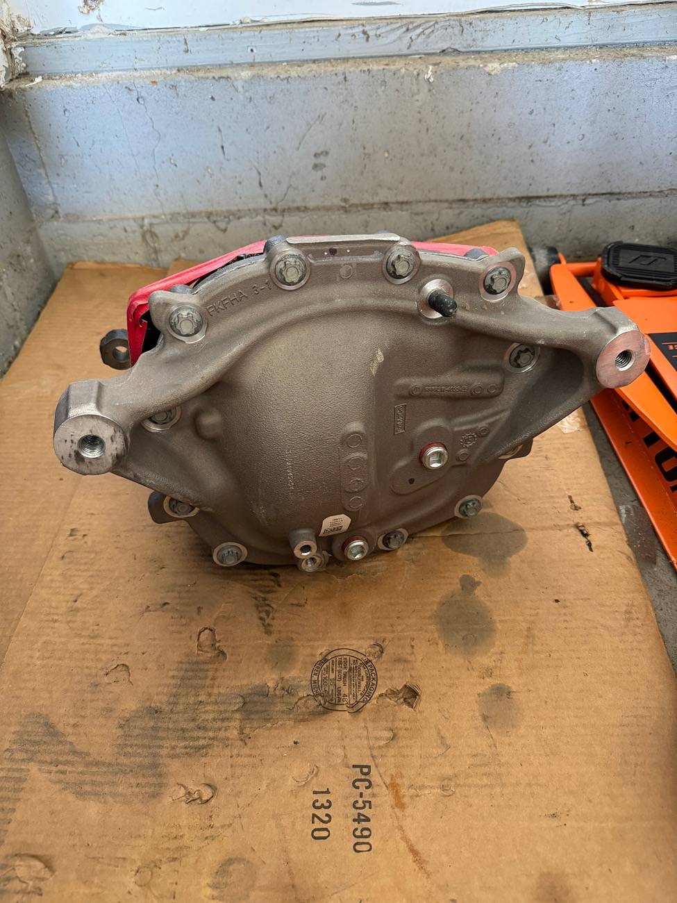

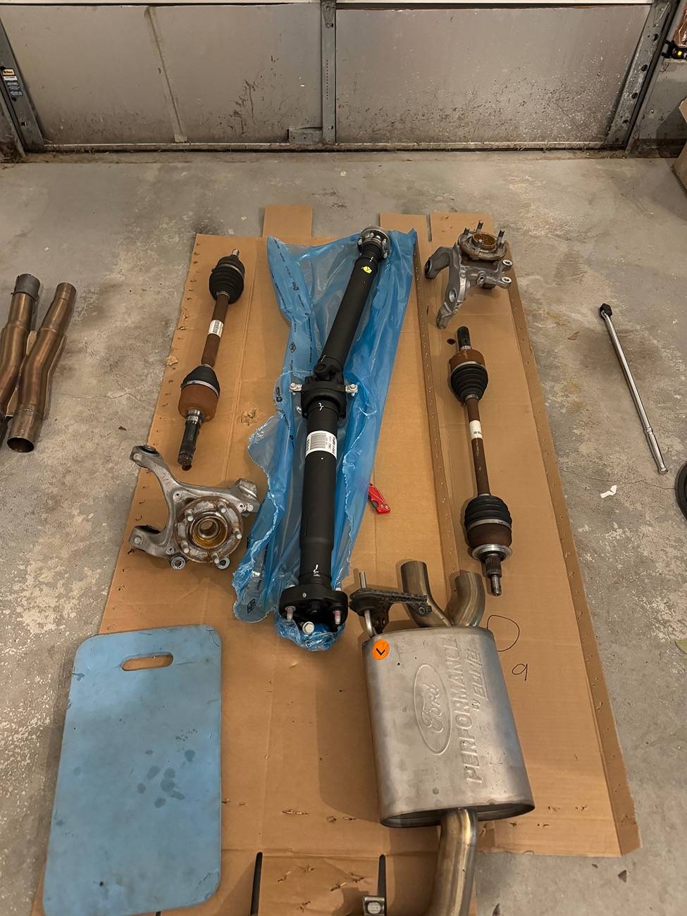

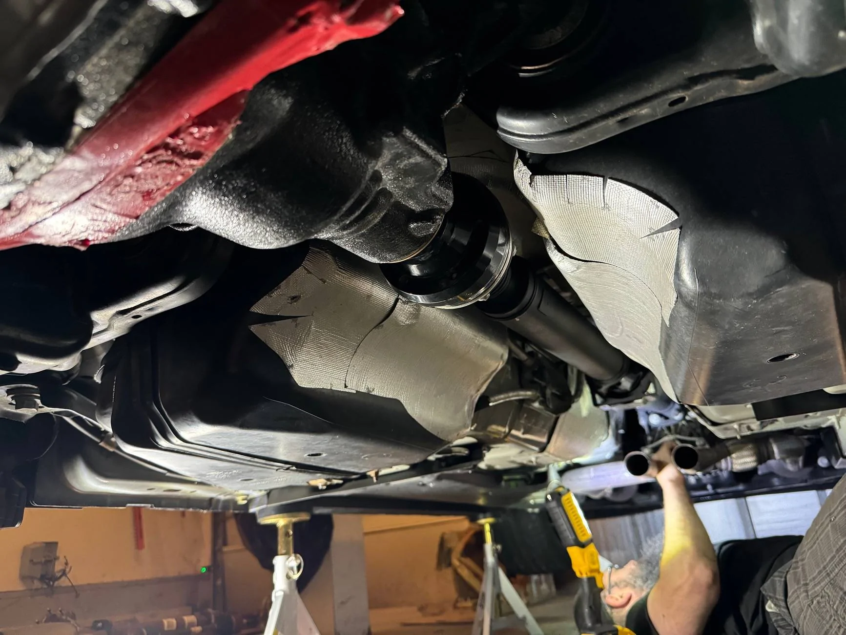

New diff is here. I’ve seen some instructions / guides do this without dropping the rear subframe. Ford suggests using a transmission jack to lower and raise the diff. Think that will be my plan.
MrMike
MrMike
Feb 15, 2016
33
997
1,285
US
16 Mustang GT, 23 Bronco Wildtrak
  • Refreshed GT350 Rear Diff (7/5/24)
New diff installed.
Rear all taken apart, half shafts out.
New diff with old diff. I used a Harbor Freight transmission jack to do the swap.
New diff and new driveshaft in
The new driveshaft is surprisingly lighter than the old one, and had a nice black powder coat.

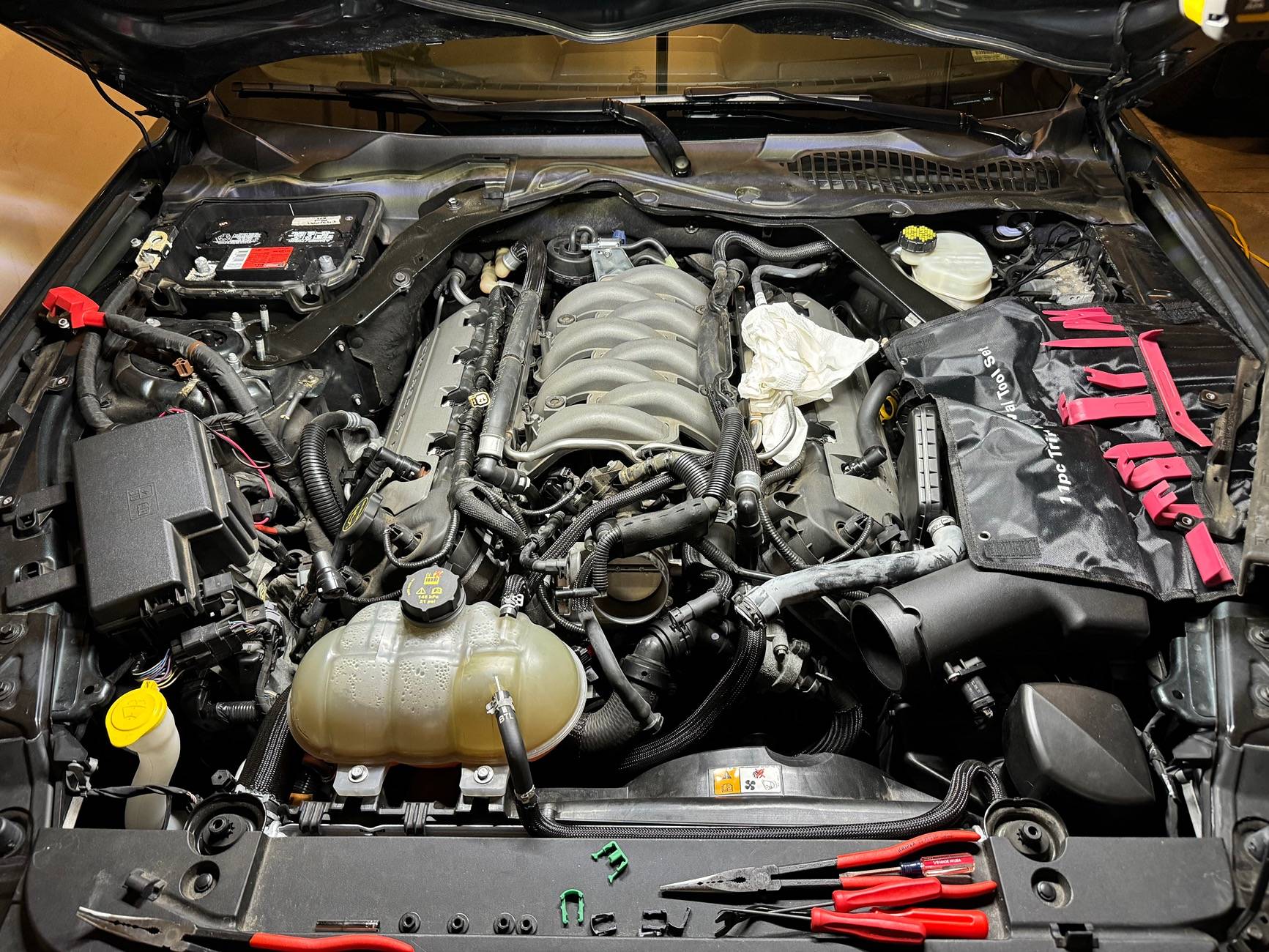

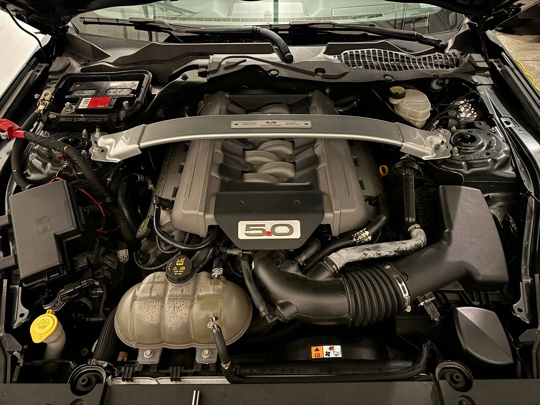

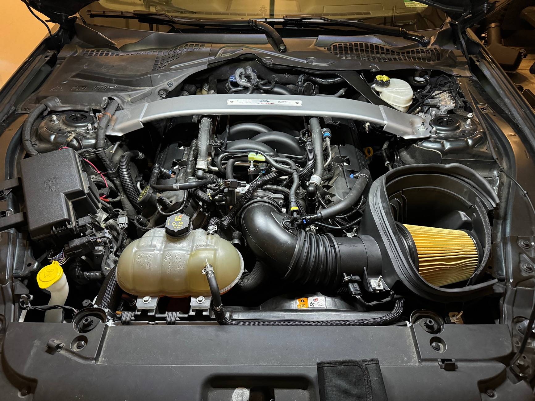

  • Ford Performance Power Pack 3 (M-9452-M8) (7/13/2024)
Overall this was a fun install. I still had my sound tube before this, so I will start by conceding that the car does in fact sound better without it.
I am surprised by the different throttle tuning. It will take me a bit to adjust, but it's clearly an improvement.
I've only done one pull to test it, but revving out to 7500rpm is fun and it seems to pull all the way there.
For my other big mods I had someone helping me out. I decided to do this alone and I had no issues. Lots of good videos and guides that I watched and read. I really liked LMR's video specifically.

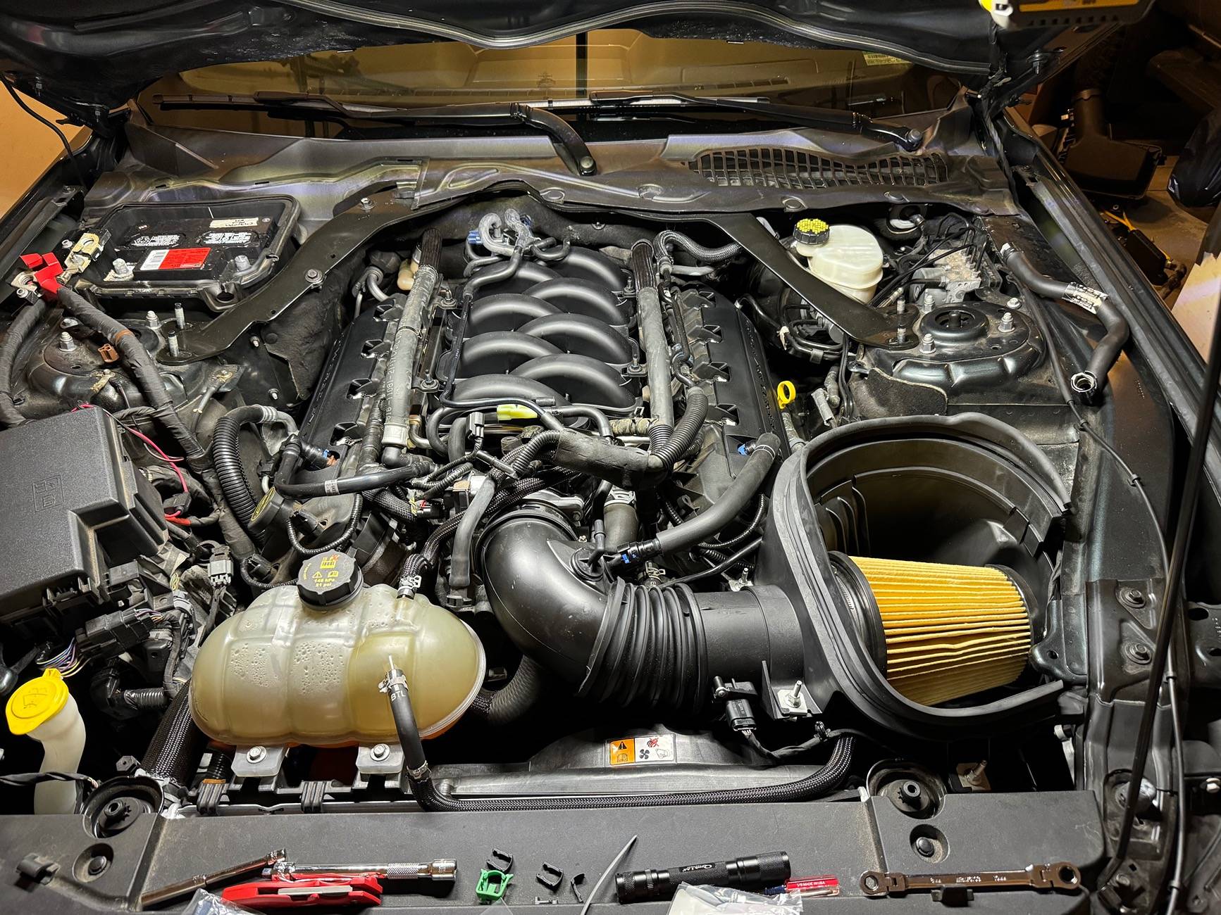

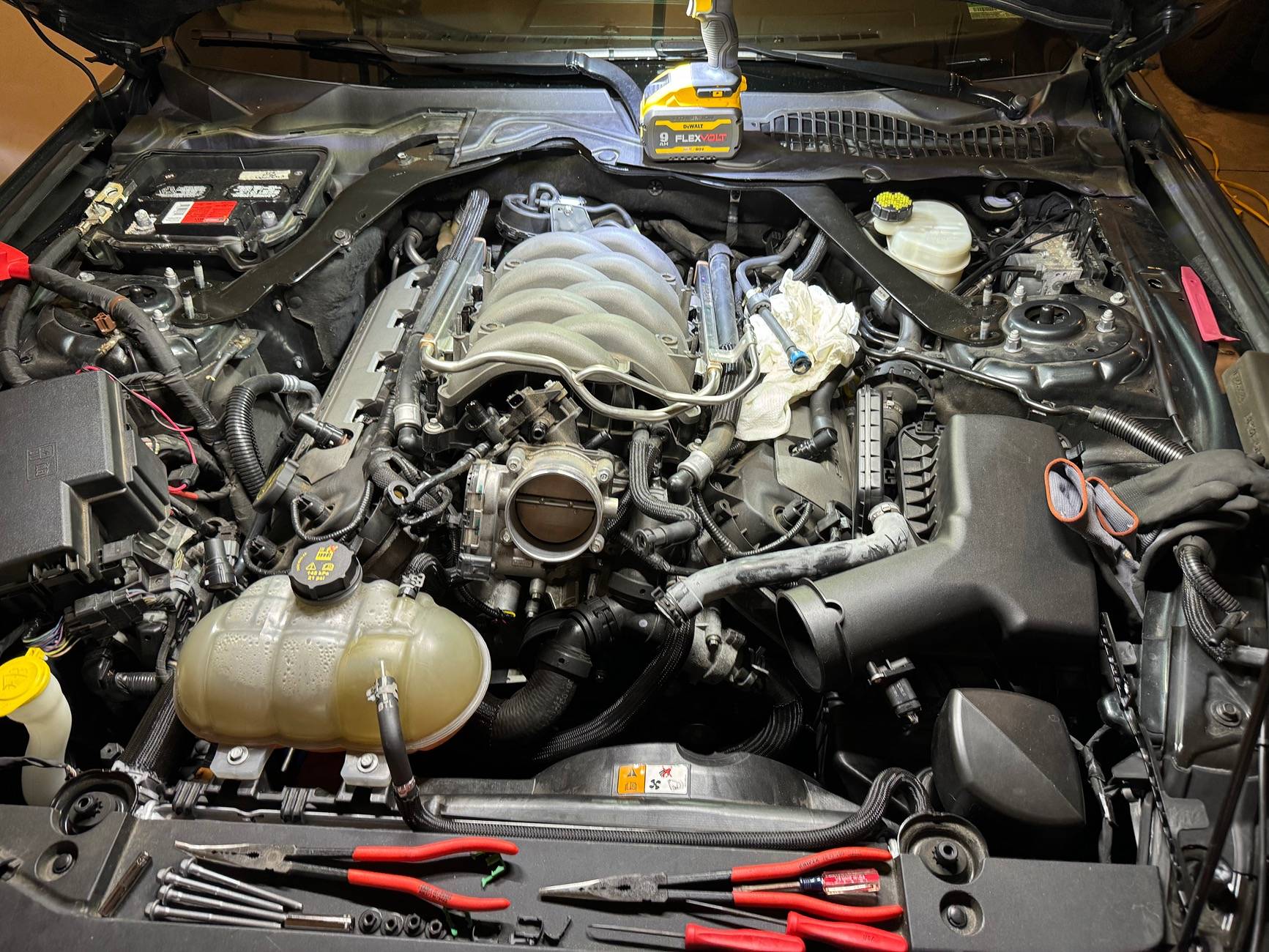

Getting started, fuel pump and battery disconnected.
Intake tube out, most PCV and brake booster lines disconnected. Heater brackets off. Fuel line disconnected.

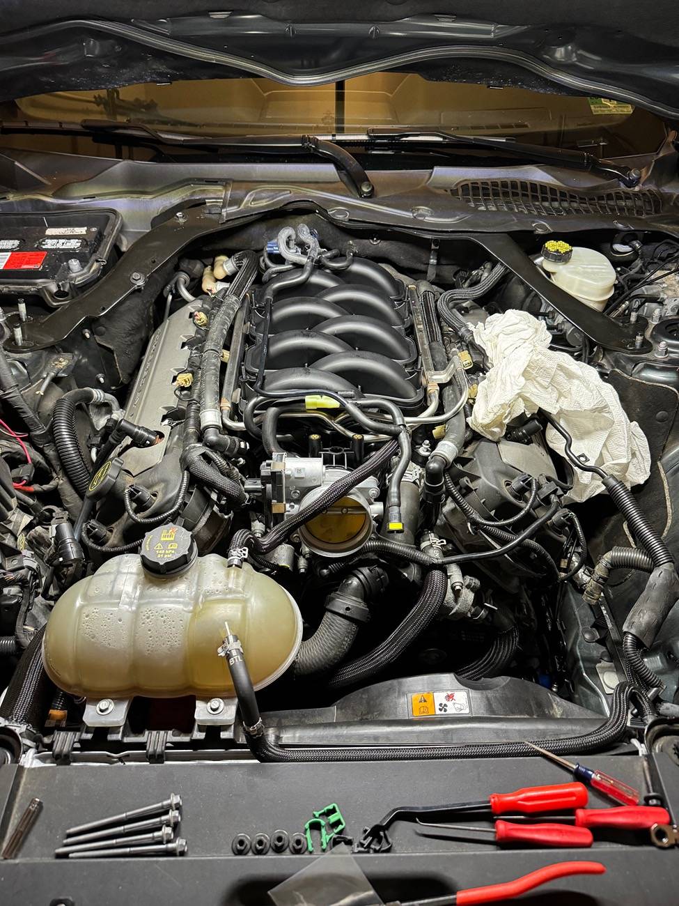

Intake manifold unbolted, struggled with the connectors on the back for a while. You kind of have to unbolt it, lift it forward, then tilt from side to side to get them. Referring to the IMRC connectors.

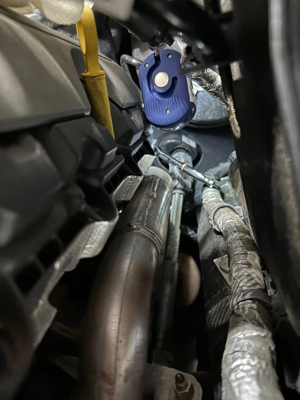

I decided to remove the sound tube the "proper" way, I must be sadistic:

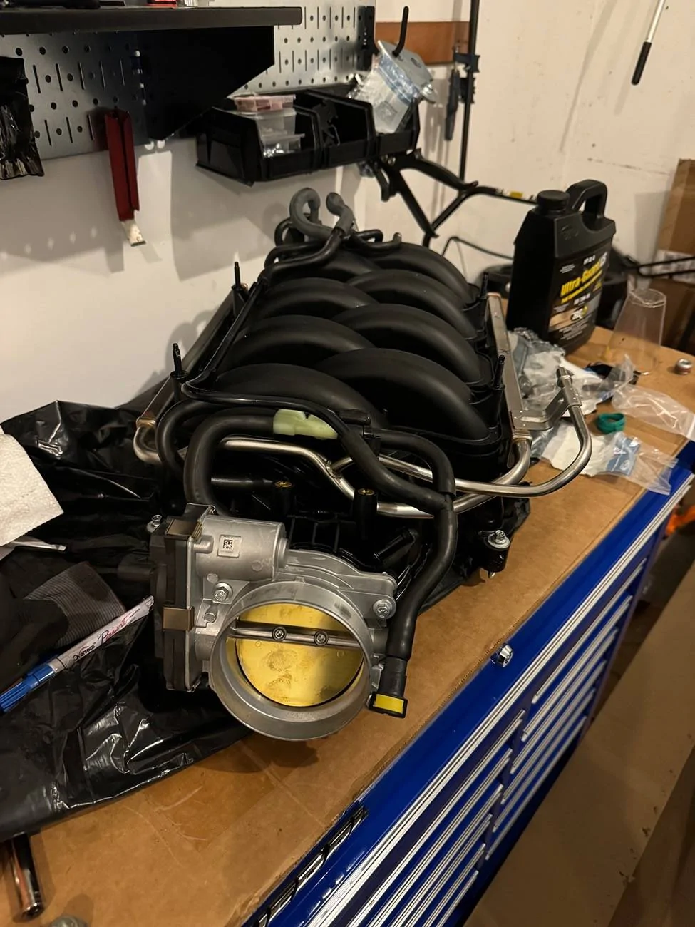

Assembling the new manifold and throttle body.
Adjusting the wiring harness on the back for the new manifold:
Plop
Also installed black coil covers to match the new intake manifold
All buttoned back up
